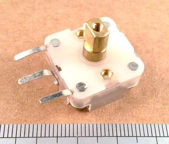

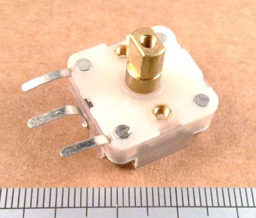

    • #62
      Originally posted by daluka View Post
      What is it?
      Like this
      but controlled by DC voltage, not your fingers.
      https://www.usefulcomponents.com/mai...iable_cap.html
      • #63
        Originally posted by Pete61 View Post
        Like this
        Variable Capacitor

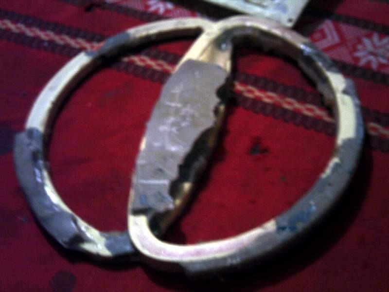

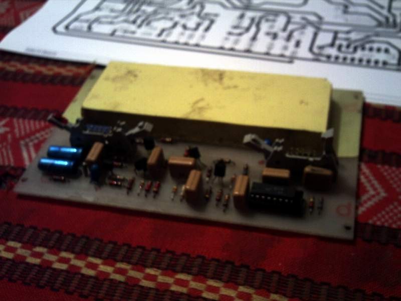

                        In 1987 when I was 21, I went to London and bought my first detector.
                        That was the Arado 120 you are talking about here.
                        I used it until 1991/2 when I sold it and bought a White's Eagle IIc.
                        Ah... the good old days! Brings back so many memories!
ID:	428954Click image for larger version
ID:	428955Click image for larger version

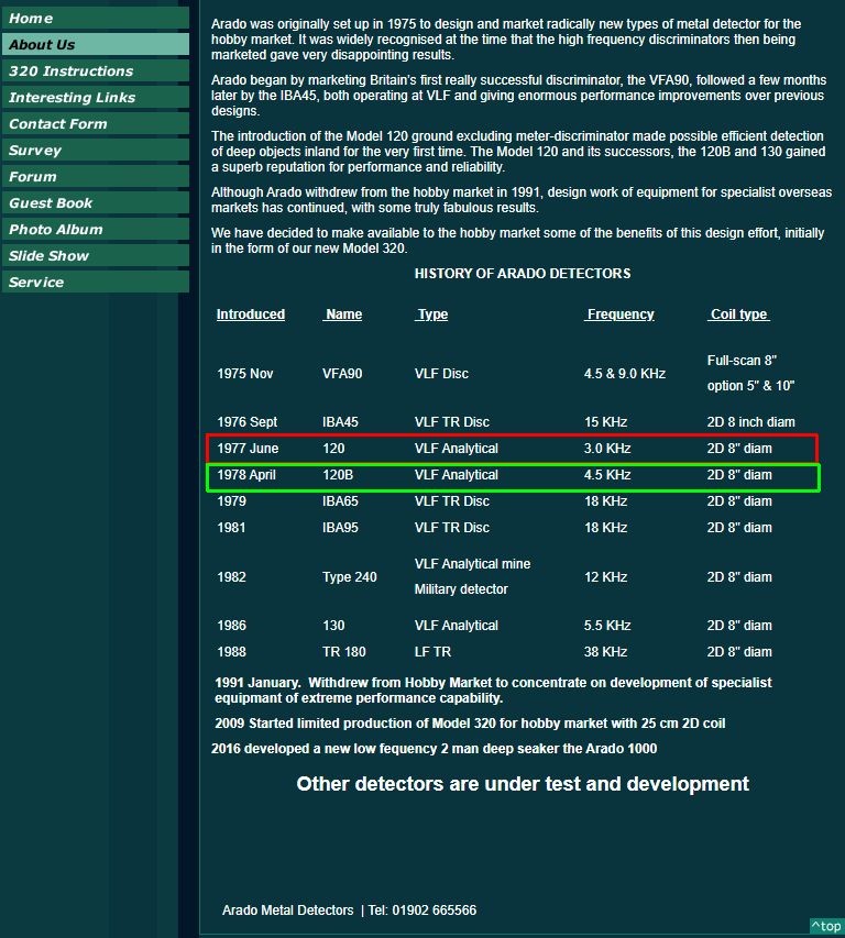

                        • #72
                          History of Arado since 1975.
                          • #73
