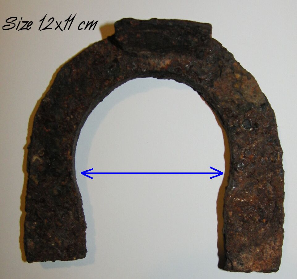

      Thanx J_Player - this must be it:
      if eddy currents caused a magnetic field in the horse shoe that was strong enough to cause some small force of attraction and repulsion between the two sides. But to gain any mechanical advantage, the eddy current fields would need to alternate at a frequency that is resonant with the natural frequency that the horseshoe vibrates at
      But this phenomenon must be some vibration or resonance-effect at molecular level:
      The "magic tune" comes directly from the both site-centers of the horseshoe, a bit nearer located to the ends. Best gain if there is ca. a 2.5cm /1 inch distance between coils and horseshoe-endings.
      I could record it with a simple Webcam-Mic but you need a good headphone because of the very high frequency. Processed it through a highpass-filter for eliminating disturbing noises.
      As I tried recording it with a walkman with inbuilt Mic I had almost the same high-frequency in my earphones - but without any horseshoe! With a coat-hanger so far no success.
      It reminds me a little bit on the bright sound of silver but is slightly different.

        It sounds like the horse shoe is acting like a tuning fork. I doubt it is vibrating at the fundamental frequency of the horse shoe, but probably a higher harmonic. I suppose the eddy currents are causing the shoe to jiggle along it's length. You may be able to hear several audio frequencies including the high pitch one on your recording if you hold the horse shoe from a string and ping different points on the side of it with a spoon.
        You could try passing the detector over a fork or a u-bend piece of stiff wire held near a sound box to see if you hear any sounds to help confirm it is caused by the coil. Maybe it works better for iron than non-ferrous metals. One way to hear some sounds from other metals could be to hang the metal from a string that is tied to the microphone housing. Any vibrations in the metal will travel up the string and conduct to the microphone as long as there is not much insulating foam in the way. Of course it would be good to tie off the metal in the direction it is expected to vibrate the most. ie: a straight piece of stiff wire suspended horizontally and tied off near the middle of the length, but slightly to the side of the center.
          This could be, but I wonder why the audio signal emmits from two central points.
          The Fisher 1266-X uses 4,8 kHz but the heard sound seems around 12-15 kHz.
          I tested and recorded the normal "pling" of the old forged iron horseshoe (perhaps around 150-200 years old) and it sounds nearly the same throughout the whole bow.
          (the recording is from one end to the other and I added the orig. horseshoe.jpg above)
          Admin Qiaozhi here has an 1266-XB and could also make some verification tests.
          topic Sound box:
          How would you like those experiments and what kind of sound box should I use? A simple resonance room, a little speaker or a metal box?
          I tried a usual stainless steel fork but heard nothing so far. But I digged out alot old forged metal objects a few weeks ago so I will continue my test with those.
          I think the detectors frequency gets transformed into audible signals by the special consistence of that old forged metal - maybe comparable somehow with "radio signals" on amalgan-fill-ins.
          It was interresting to pinpoint exactly the both centers of the audio-source with the plastic microfone. It come directly out of the metal. Seems the resonance adds up and cumulates in those centers.
          Next time we create detectors which force the buried metal-objects to make loud noises themselves!

            You can get a cigar box or similar cardboard box and cut a large hole in one of the large faces similar to the hole in a guitar. Then tape the metal object to the top of the box with the forks of the "u" hanging over the open hole. It will probably work better if one side of the U is taped down with the other side up in the air perpendicular to the face of the box. Then hold the metal detector near the fork to see if you can get it to make a sound. Try adjusting how far the metal hangs over the hole to find the best sound level. The idea is to use fairly thin, but stiff cardboard or wood that will vibrate and boost the sound like a guitar does. In order to work, you want a place along the length of the fork to be taped down tight to the edge of the hole, so it causes the face of the box to vibrate at that edge. Then the small vibration at the face of the box will echo inside and should be easier to hear around the hole.
            This also might work by simply suspending the metal inside a 5 gallon bucket to enclose the sound where it will echo instead of dispersing the sound. Another idea is to cut several strips of aluminum foil and hang them alongide like an air capacitor and see if they make some audible sounds due to eddy currents causing them to make repulsive forces between each other. Maybe spacing of 1/8 inch or so would work.

              I tried the same experiment with two different horse shoes, and couldn't hear any ringing.

                              Qiaozhi: What kind of coil did you use? Mine is 12'' and the eliptic coil is the same size as the horseshoe endings as you can see in the clip.
                              J_Player:
                              Thank you for the "resonance room"-instructions , but paper or wood won't work, 'cause this is at the border to ultrasound. A metal pipe or metal funnel may capture the weak signal, but I doubt there is any amplification with usual equipment. It's almost comparable with a dog-whistle.
                              Too bad, so far I didn't found any metal-objects everybody has. However, old forged iron objects should work if you can "pling" a melodic sound out of them by finger, hammer or whatever.
                              But, as I told you, this also works with other detectors - like the Garrett Ace 150 or 250, but not that "intensive".
                              The stronger the radiation, the better the eddy-currents.
                              A coil, emitting at 4,5kHz with 220V. and 500W. would make not only old iron singing real loud...
