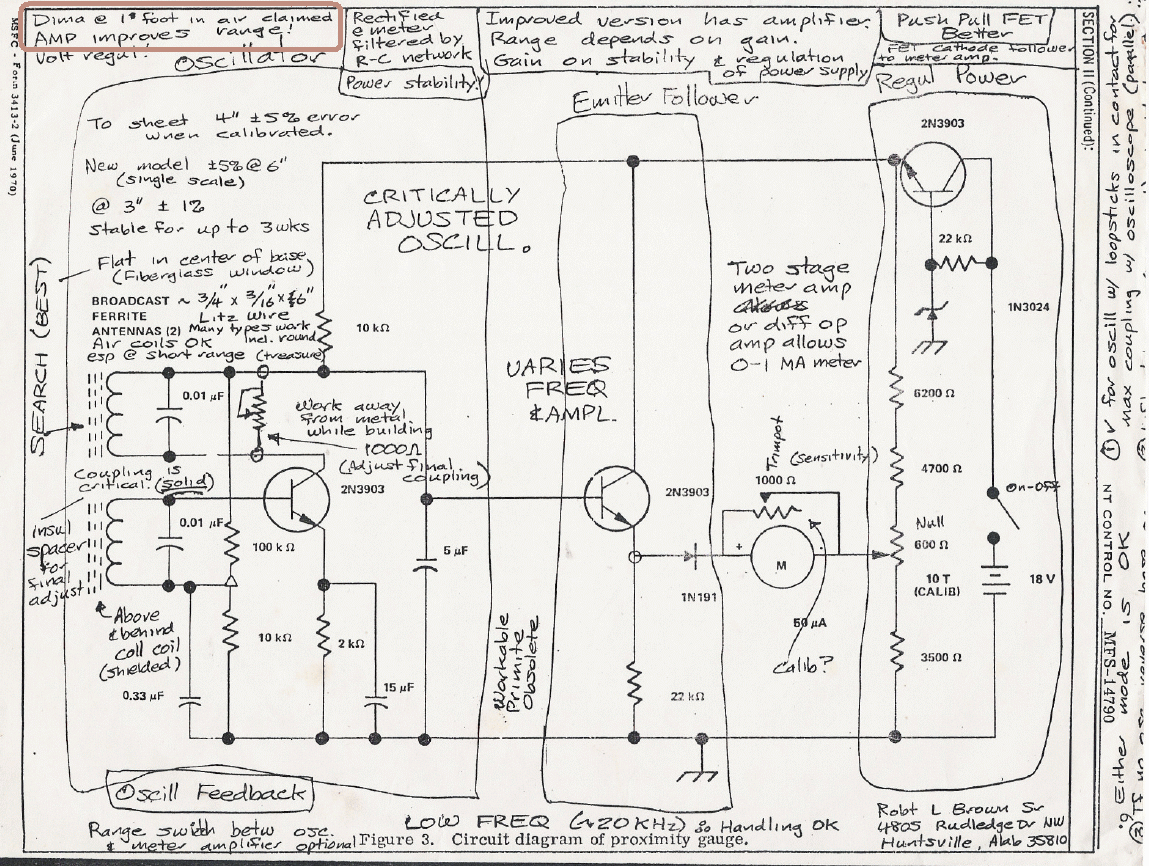

                              Actually there is an amazing NASA coil detector. Not the kind you're looking for. But one NASA engineer devised this wand detector to locate metal objects hidden in other materials. It works like a pinpointer, but what is amazing is it claims an improved range. Apparently the positioning of the ferrites is critical to get the improved range.
                              Best wishes,
                              J_P
                                Best wishes,
                                J_P
                                Transistorized NASA version of Gold Gun.
