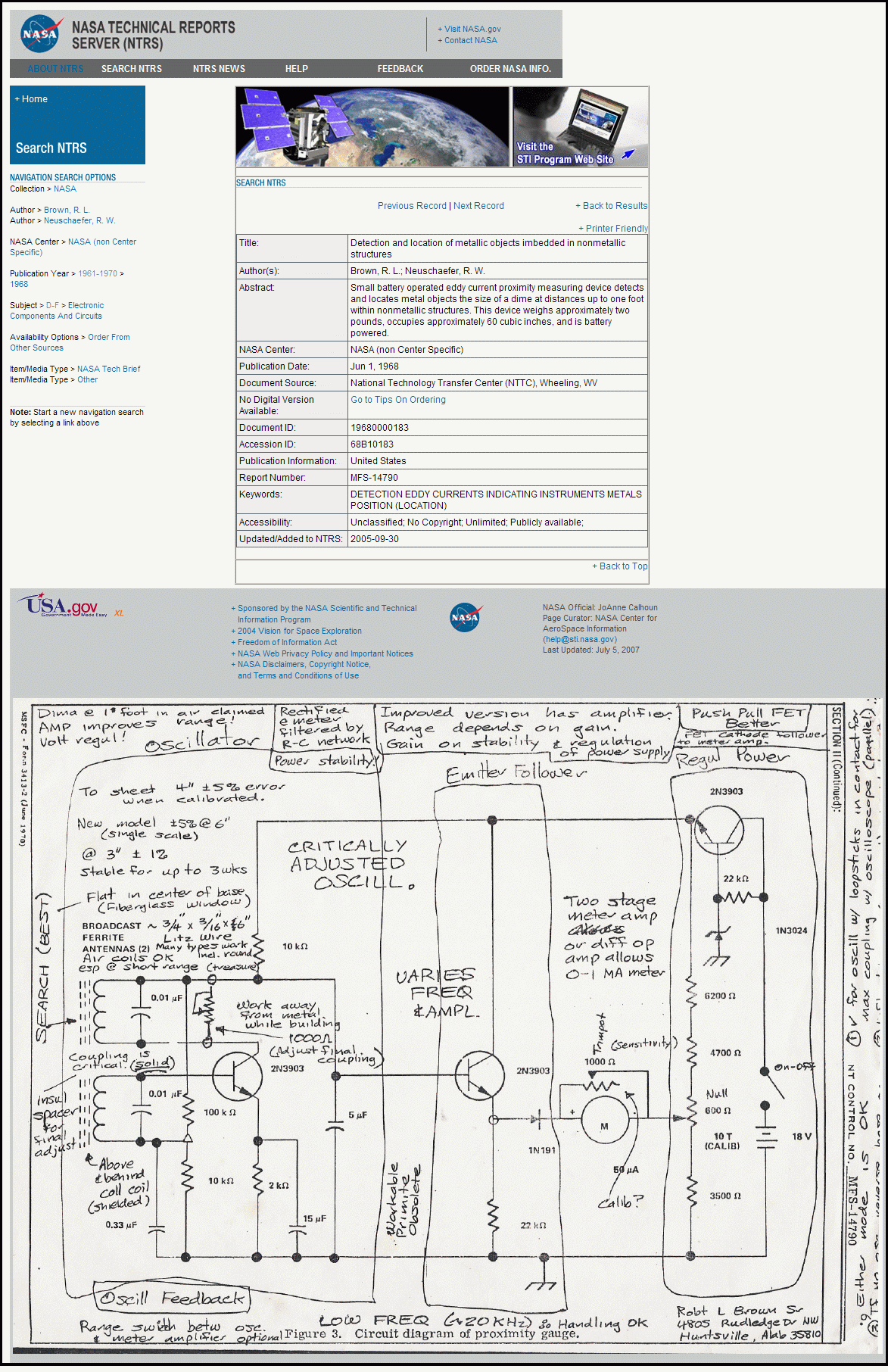

          WM6, search WEB for "proximity gauge"!
            This was my first attempt but no success.
            Only keyword from schematic that lead to more real data is "MFS-14790".
            It return:
            "Detection and location of metallic objects imbedded in nonmetallic structures
            Author(s): Brown, R. L.; Neuschaefer, R. W.
            Abstract: Small battery operated eddy current proximity measuring device detects and locates metal objects the size of a dime at distances up to one foot within nonmetallic structures. This device weighs approximately two pounds, ... etc."
            It is about NASA internal (but public domain
            now) paper, seems not patented and not digitalized yet.
            J_Ps patent claim is probably sort of his "Examiner test" misleading story.
            Comments on schematic can be from one of authors (Brown) personally.

                  Yes, it seems so.

                      I was trying but nothing. What is PAT Nr. or Subject?
                      Yup. This is not patented or in the US patent database. For sure. It would be interesting to track down the paper.
                      • #41
                        I checked my private database for this Eddy current detector. Here is a screenshot of what I saved several years ago.
                        The source page is still online here: http://ntrs.nasa.gov/search.jsp?R=43...N%3D4294956547 but does not show the image.
                        You will see there are links that lead to sites where you can order the full 13 page article from the NASA tech briefs.
                        I believe this device was also patented.

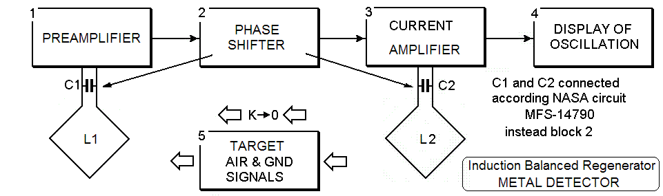

                            The block diagram is specific case of IBR MD
                            If we know the correct block diagram of an operating prinzip, we have a powerful tool for design and to detect drawbacks of an existing design. We have the correct block diagram of REGEN prinzip given as posting # 116 in thread "Popular Electronics". The NASA circuitry MFS-14790 has the attached here block diagram. If we compare both, should find that NASA circuit have less sensitivity because of low amplifier gain and very low frequency shift because of steep phase characteristic formed by both tank circuits L1-C1 and L2-C2.
                            I will post soon an analysis of maximal amplifier gain for ideal BALANCED REGEN metal detector.

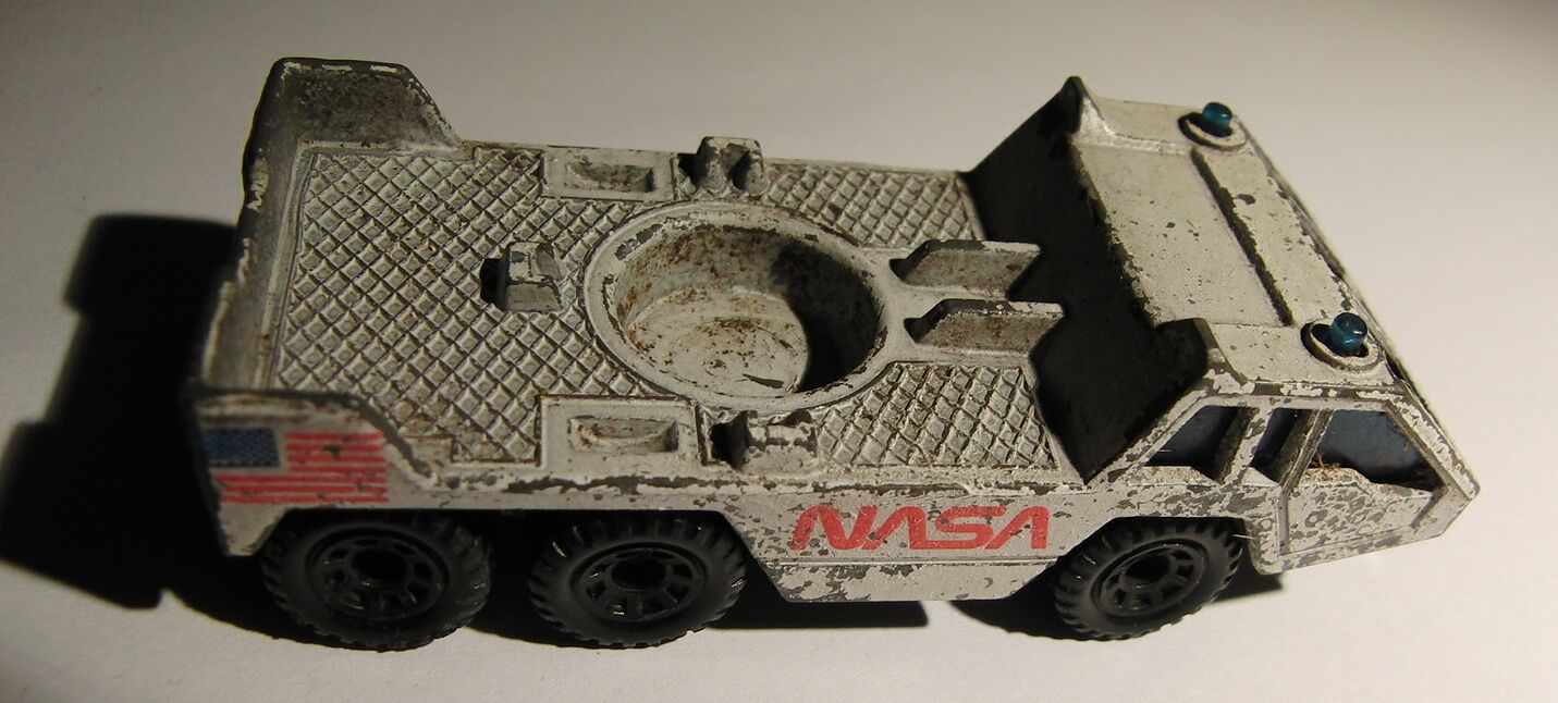

                              @ all:
                              Attention: Extremly big coincidence!!!
                              Believe it or not, but today in the very early morning I did found a NASA Matchbox toy-car together with 2 other interresting objects.
                              Found them with my modified Fisher 1266-X: http://www.geotech1.com/forums/showthread.php?t=16453
