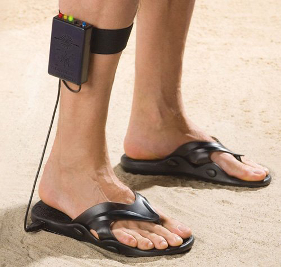

      These have been available for some time, and have already been discussed here on Geotech in the past. ->
        You're too late!
        At the end good promotion for Hammacher Schlemmer (!) Metal Detecting Sandals.

          I doubt those sandals work really good. At least the shoe-coils need to have Ace Sniper Level (4'' / 10cm diameter, but shaped eliptical)!
            I'm not talking about sandals,
            Sure, you are talking about purple Cinderella shoes.

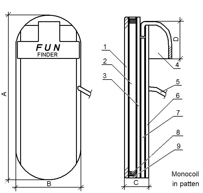

                    If an oval spiral antenna per feet works it would be the best solution. Not just only one feet, because this would reduce the success-chances to the half.
                    Does a double wire spiral antenna has the ability for discrimination?

                            This is a serious design to avoid two drawbacks of sandal metal detector:
                            1. Modulation of AIR signal due to coil deformation and
                            2. Modulation of GND signal due change of coil height.
                            Both sentences (translated by you exactly) mean that it is impossible to avoid the main drawback of shoe detector - productivity. Even to split sensing head in both shoes, as shown in cartoon, it is impossiple to cover so fast search area as a conventional metal detector.
