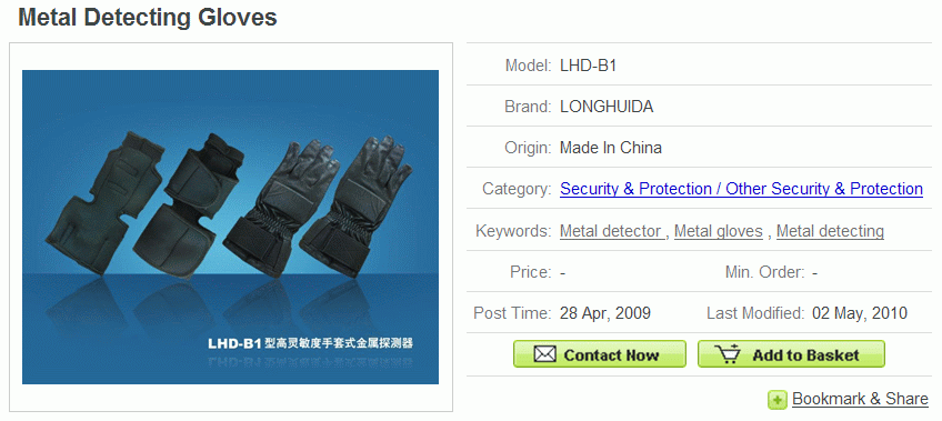

            What about glove metal detector
            Metal detector in the glove.

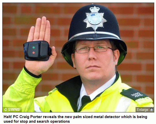

              Palm metal detector
              Made in England
