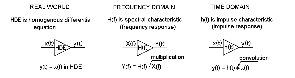

            There is a silly claim that
            there are metal detectors operating in the FD (frequency domain).
            This is nonsense, because everything in our real world happens in time. Even my oscilloscope connected to my VLF metal detector shows that it operates in TD (time domain). (My scope measures the period T of periodic functions and shows it as frequency f=1/T).
            The FD was created almost 200 years ago as powerful tool for analysis and syntesis (design not only of all types metal detectors :-). Instead the variable t (time), the FD uses as reference T (period of a periodic function), but the variable is periods (cycles) pro second f=1/T.
            The advantage of FD is because a complicated math operation "convolution" used in TD, the FD uses a more simple operation "multiplication" and even "summation" if all values are expressed in dB (decibels).
            According to the FD, there are only two types metal detectors NB (narrow band) and WB (wide band).
            To demonstrate different tools for analysis and synthesis (design), I will use a device with input and output as an amplifier. Below is illustrated how to calculate the output in real world, in FD and in TD. All know that the amplifier has an own parameter named "gain". However the gain depends on frequency.
            Oops! I started to speak in frequency domain.
            In real world, the output is calculated with solving differential equation (only MADLAB participants use this :-).
            In FD it is calculated with multiplication of frequency spectrums.
            In TD it is calculated with complicated math operation "convolution".

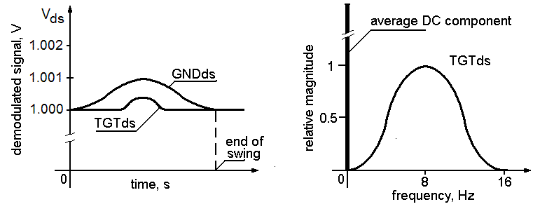

                        FD as design tool
                        Attached below image illustrates how is obtained information for design of a BPF (band pass filter) which is connected after demodulator to suppress noise and GNDds (demodulated ground signal).
                        When operator swings search head, he can not keep equal distance to ground and GND signal appears modulated. Since synchronous demodulator is not ideal balaanced, it sees some modulation and generates GNDds as a pulse which width is almost as time of a swing.
                        If there is a relatively small target, search head passes quick over it. The demodulator generates TGTds (demodulated target signal) as a short pulse which duration is small relatively to time of a coil swing.
                        To design BPF, we should transform both pulses in FD. We will see that they differs in frequency spectrum. For example the spectrum of GNDds has maximal frequency 4Hz and large DC component, but the TGTds spectrum contains frequencies untill 16 Hz and has maximum at 8Hz as is illustrated on the right side diagram.
                        Remains to design a BPF to suppress frequencies below 4 Hz and above 16Hz.
                        Let a "MadLabs Inc."(c)(tm)(r) participant explain how will solve this problem using only Time domain.
                            Easy, a FIR filter. Much better than analogue IIR solution. However, there is a bit more to the 8kHz peak than meets the eye ... 1/f noise. Besides, the rising slope would ideally work as differentiator with nice time domain response, while the vast majority of nowadays detectors fail there.
