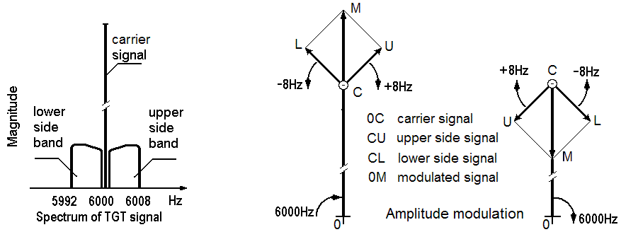

    NARROW BAND METAL DETECTORS
    I renamed these detectors SI (sine induction) detectors because there are PI (pulse induction) detectors.
    When TX radiates CW - Continous Wave (more suitable term is single frequency) magnetic field, RX receives TGT signal as a narrow band in frequency spectrum. The band appears because of modulation. When search head moves, the TGT signal changes; it has a beginning, a maximum and an end as was shown before. If we stop movement, the TGT signal remains constant, ie the modulation disappears (bandwidth becomes zero) and received TGT signal has the same frequency as AIR signal . As mentioned, the bandwidth does not exceed 16Hz. So TGT signal seems on the locus in complex plane as a point despite in reality it is a very small arc or segment. If the TX circuit is competent designed, the ground can not modulate the AIR signal.
    Below is illustrated AM (amplitude modulation) with carrier wave and two side bands. I think the side bands are not two for metal detectors because when AIR signal is zero, we have onlyTGT signal as a SSB (single side band),

        The generally accepted definition of modulation, with regard to communication systems, is that a signal is mixed with a sinusoid to produce a new signal. In the case of a VLF detector, a metal target modulates the TX signal both in amplitude and phase. The sample gates are then used to demodulate the RX signal and to provide the in-phase (I) and quadrature (Q) components. The I and Q parts of the demodulated signal can then be used to provide an indication of the possible target type.
        In a BFO detector, the metal target modulates the frequency of the TX signal.
        For a PI detector, the accepted definition of modulation is somewhat stretched, but you could consider the decay curve as being amplitude modulated by the target.

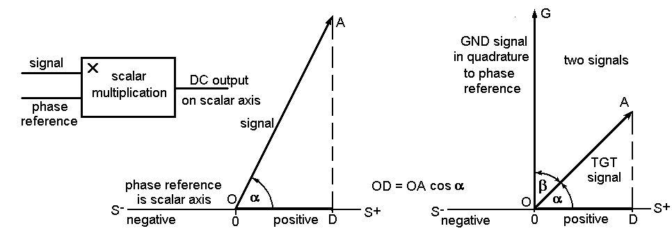

                      SYNCHRONOUS DEMODULATOR IN FREQUENCY DOMAIN
                      SYNCHRONOUS DEMODULATOR IN FD
                      Frequency domain is handy tool for visual analysis.
                      Let we use it to analyze how SD (synchronous demodulator) eliminates GND signal and what happens with TGT signal
                      at ground balance .
                      As you know, signals are represented in FD as vectors.
                      The synchronous demodulator operates as vector multiplicator. It makes scalar multiplication of two vectors named
                      signal and (phase) reference. The output is DC voltage as illustrated below.
                      Scalar product of two vectors is constructed by taking the component of one vector in the direction of the other and multiplying it times the magnitude of the other vector.
                      More understandable is the visual representation of this definion. Let we use the phase reference as scalar axis
                      shown below as straight line S- . . . 0 . . . S+ . The DC output appears as positive voltage OD on the scalar axis.
                      The operator can change the phase angle between received signal and phase reference with GEB or DISC control.
                      When phase difference is quadrature, then output is zero because cos90°=0. This is illustrated In the right side
                      where SD receives two signals: vector OG (GND signal) and vector OA (TGT signal). The operator can not change
                      angle ß between TGT and GND signal, but he can set the GND signal in quadrature.
                      This simple visual analysis of SD allows us to make important
                      CONCLUSIONS:
                      1. The SD can operate as amplitude demodulator (because when magnitude OA changes, output OD changes).
                      2. The SD can operate as angle demodulator (because when angle changes, output OD changes).
                      3. The SD can suppres a signal when is set in quadrature (90°) relative to phase reference.
                      4. For best results, the angle ß between GND and TGT signal should be quadrature (90°). However 45° is not bad. As
                      shown in the drawing, the output is 0.707 ODmax at 45°. This is only -3dB.

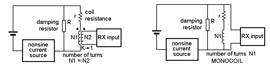

                        INCOMPETENT DESIGNED SEARCH HEAD
                        The circuit diagram in left shows an incompetent designed search head for PI or wideband metal detector. RX and TX windings have equal number of turns N1=N2. The windings are placed in close proximity, which makes coefficient of coupling almost K=1. This generates the maximal possible AIR signal in RX winding and RX receves strong GND signal. To avoid saturation of RX preamp, we should reduce its amplification (gain). This reduces sensitivity. Despite drawbacks, the incompetent designed search head has two advantages:
                        1. The form of received EMV is as derivative of TX current.
                        2. The phase of received signal is constant independent on frequency,
                        The circuit diagram in right shows the worst case - both windings are combined to a self - inductance called MONOCOIL. Then voltage across coil resistance r is added to AIR signal. A Re component is added to received signal at all frequencies and the phase angle depends on frequency. The RX can not sample when flows current in TX coil and we have not correct reference voltage for synchronous demodulation:
                        CONCLUSION: For best results, QED and all other (more primitive :-) metal detectors should use induction balanced search head.

                                The circuit diagram in left shows an incompetent designed search head for PI or wideband metal detector. ... Despite drawbacks, the incompetent designed search head has two advantages:
                                There is another advantage: it greatly simplifies power supply design. So is it really an incompetent design, or just another way to do things that works perfectly fine in some applications? Can you name a popular commercial detector that has this kind of search coil?
