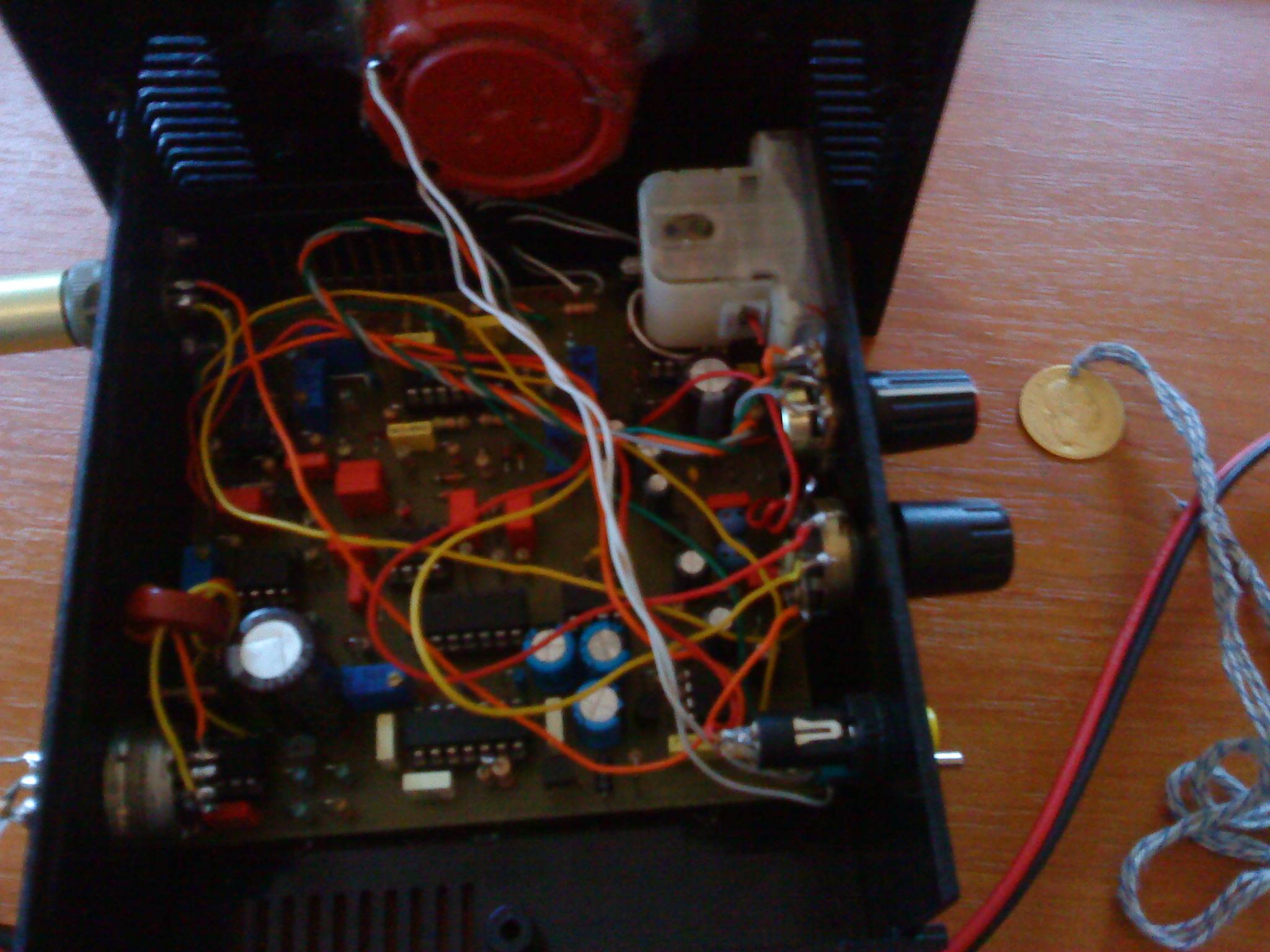

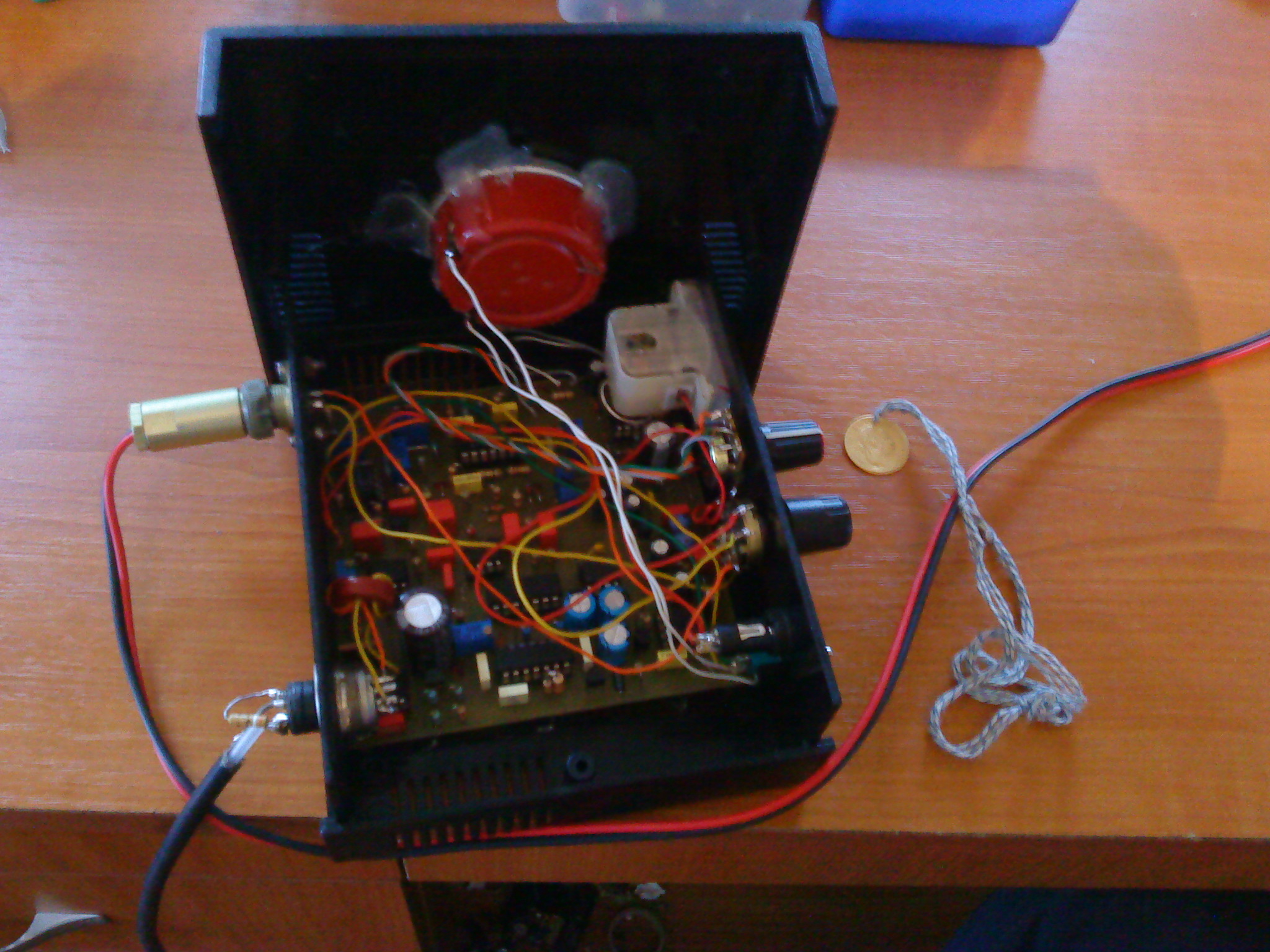

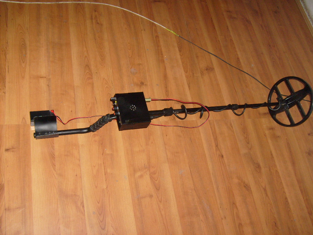

    a new project, a prototype hybrid pulse.
    Pulse Hibrid, my new prototype Pi detector.
    Frequency of this detector is in range of 100-130hz

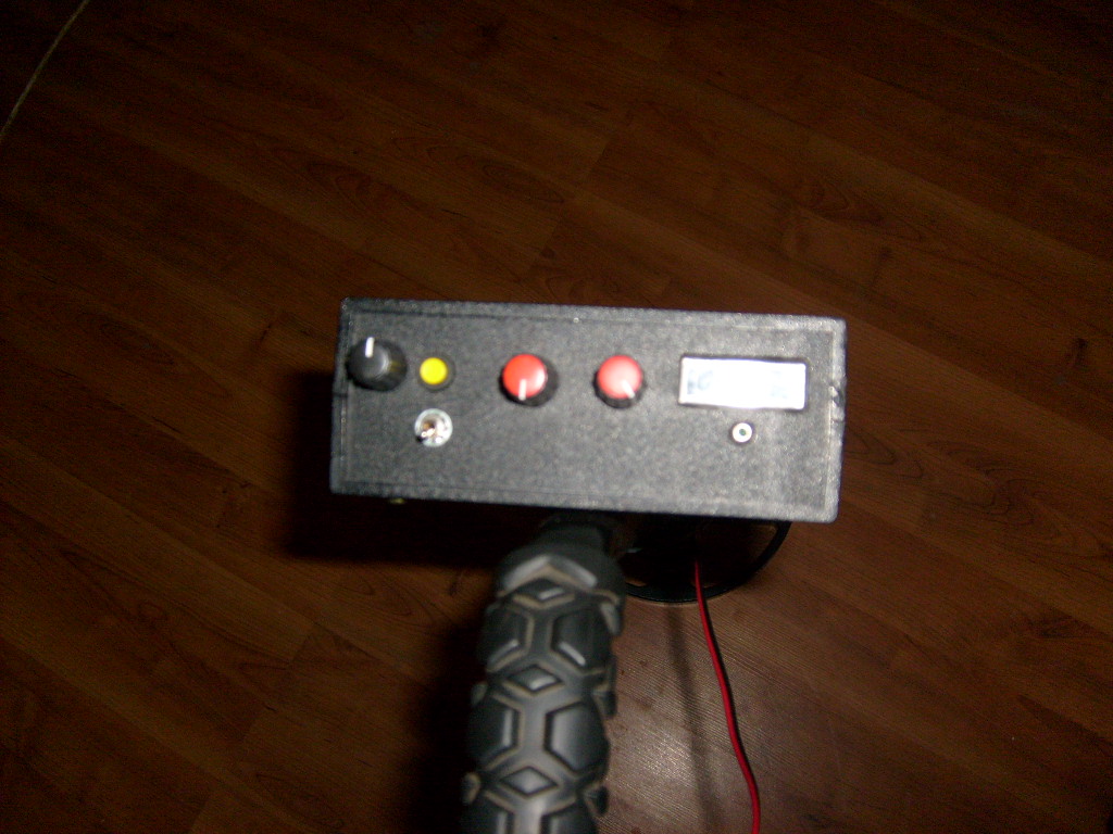

    It has next commands:
    Reset
    Auto hold
    Sensitivity
    Threshold
    Vu meter signal
    It is a pretty deep detector, it can locate golden coin 20mm diameter at 33cm with 25cm coil.
    1 Euro coin can be detected at 36cm with the same coil, and (Coke can) range detection is around 90 cm with 25 cm coil!!!
    This is a device with one chanel, soon i will modify it, and it will have a two chanels with possibility of visual and tone discrimination.

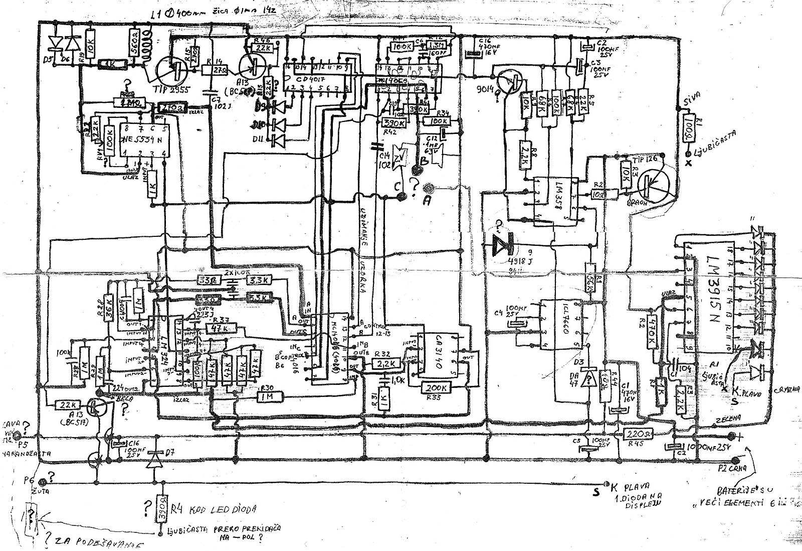

          hi orbit

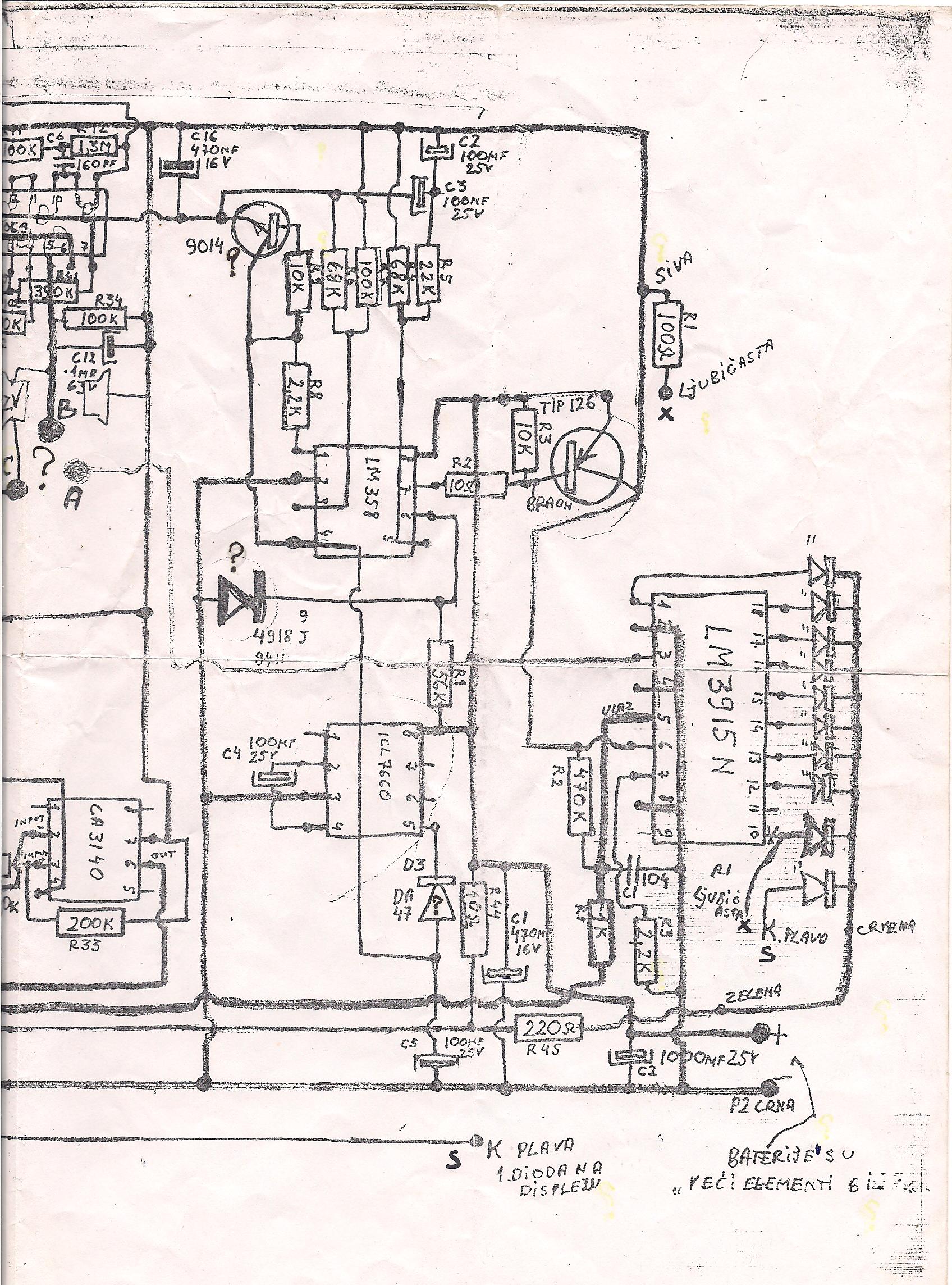

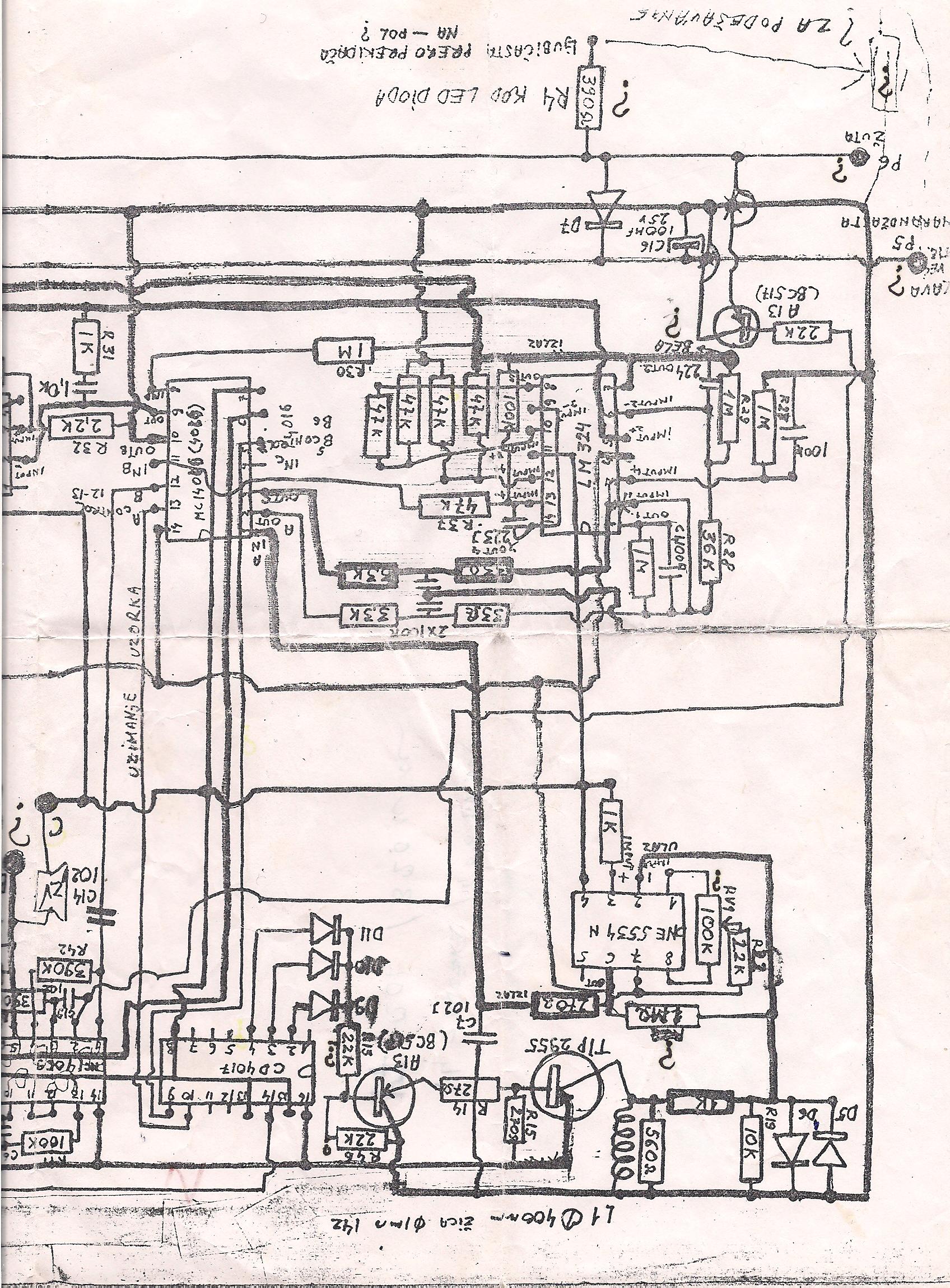

          please insert chematic and pcb and part list
            Scheme for my new hybrid.
              merged
                  This has only three people in Serbia and kt. Bravo Kt.
                    On which the device is nobody knows. Copied it to my friend 18 years ago. Copied it to my friend 18 years ago. I wanted to provoke to see,Does anyone know of where the detector works. Otherwise nothing to do with my detector in the picture.Hello Kt.
                      This device is a lot of good.I've tested is better than a delta pulse and Pulse 2
                        for Orbit. Give, please there is more than information on this instrument. Printed circuit cards, results, wishes... What successes with discrimination threw? Very much it would be desirable to construct this aggregate.

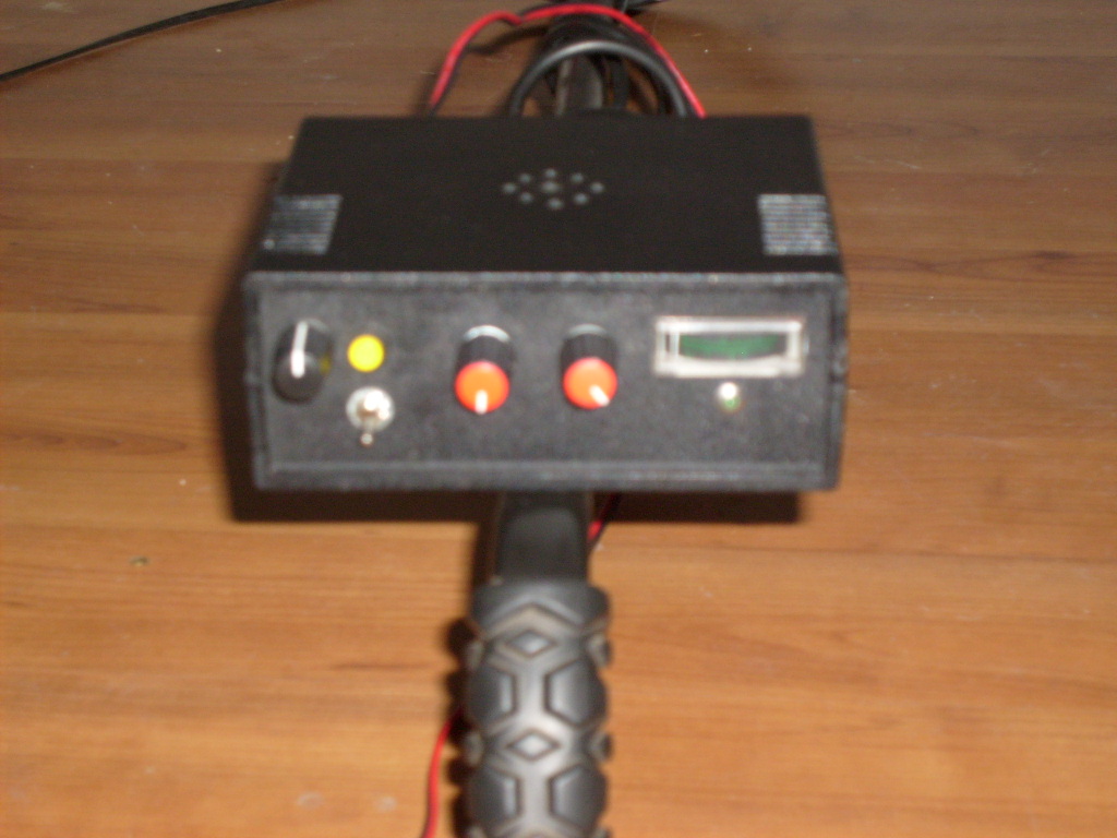

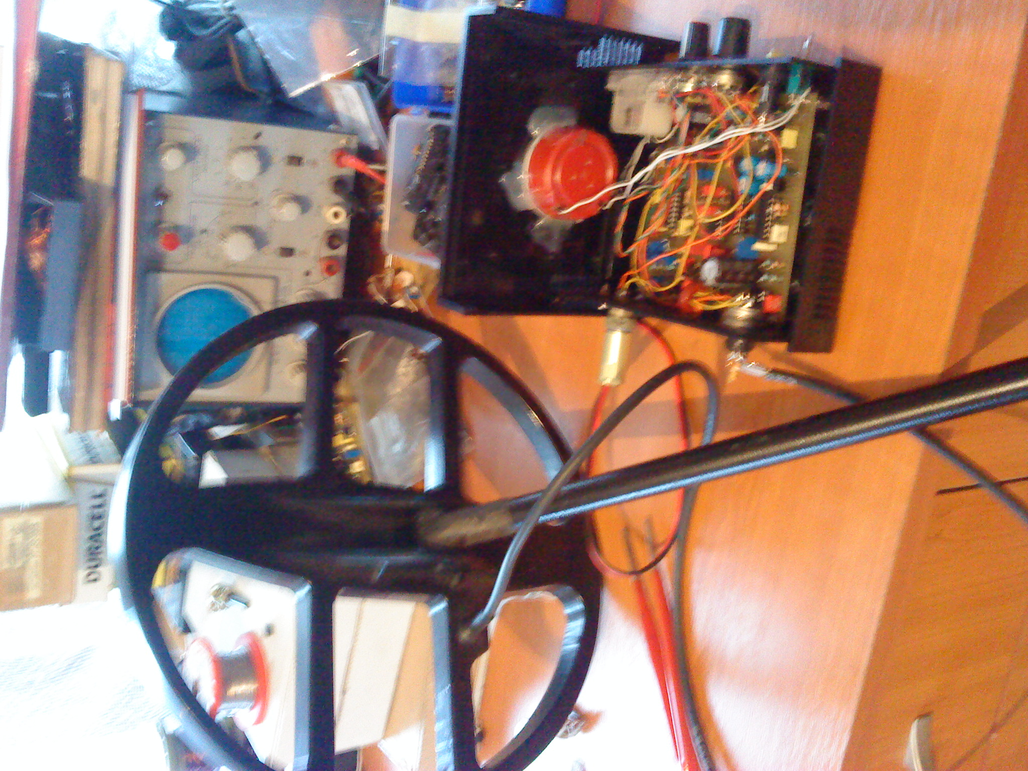

                          Added command potentiometer for sampling, an indicator of voltage drop,switch for choosing to work in fashion and no muving muving mode.
                            Command muving, no muving the back of the box and not seen.
                              The detector is designed to work in the most difficult mineralized my prototype has a better ability to adapt to the field test was carried out with mono koil on my detector and gp 3000 with mono koil.country, in the comparative test results of the gp3000 minelab showed that
