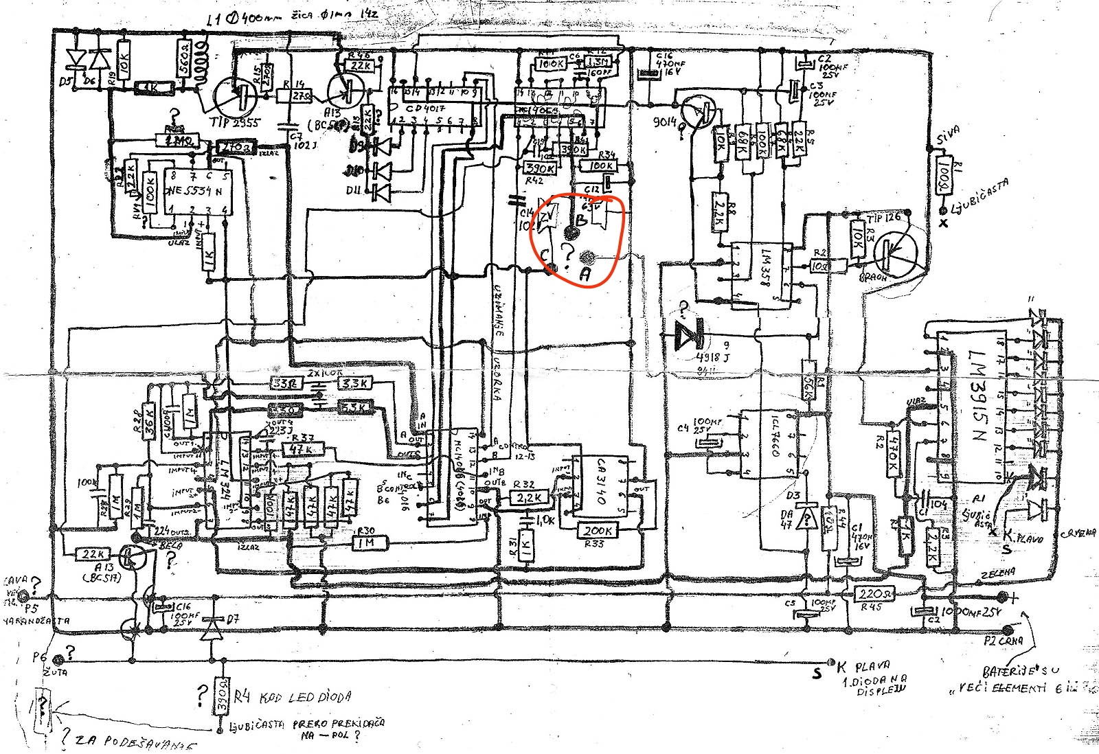

    Please send me the list of components and complete. schema of this detector (hibrida). sir. receive. my best greetings

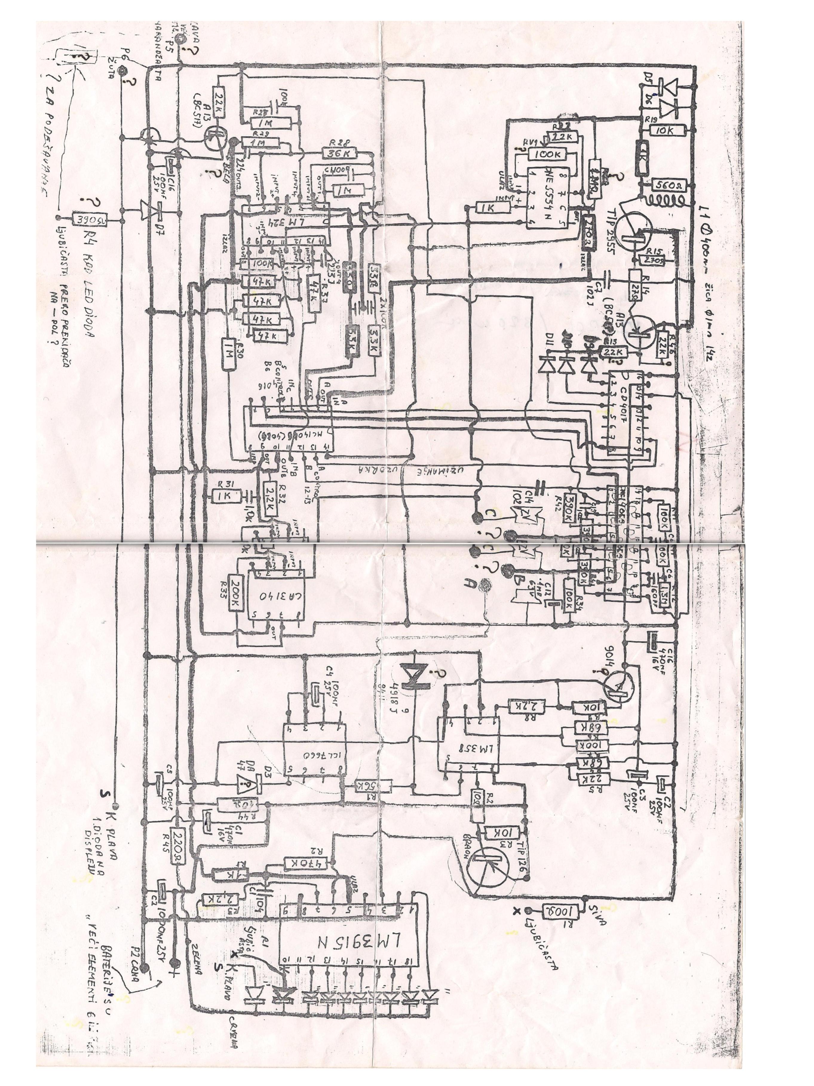

ID:	363550The drawings of kt315 splicing are missing components
        • kt315 is right, sorry
          • Has anyone redrawn his drawings after so many years
            • Hi ZOUJiarui,
              Redrawn this schematic? It was done more than 20++++ years ago already... I think the first redrawn circuit poped up 1987 already, longtime before the above circuit was drawn by hand again. Check-out Geotech. Now you might ask what circuit is it and where to find them at Geotech right? Actually if you look closely at the circuit, you will notice that the circuit is an incomplete drawn Whites PI2000/3000 detector circuit with additional LED meter only. Sorry to say... but nothing more. It is also no hybrid detector.
