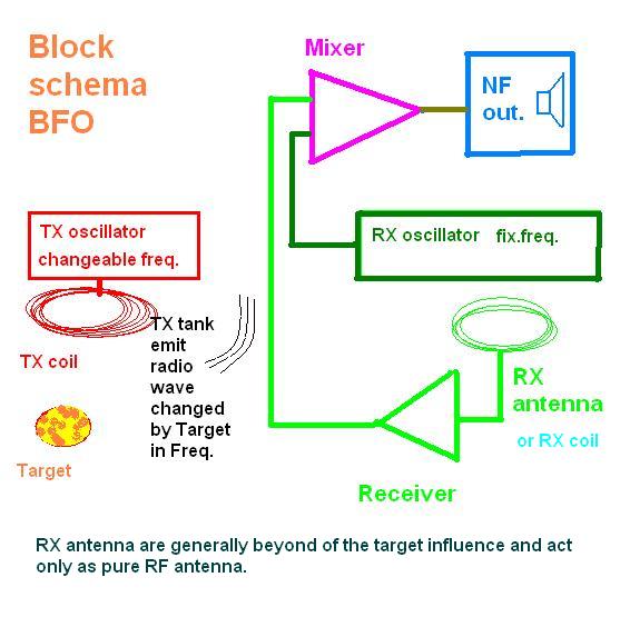

Although a BFO generally operates at a higher frequency than an IB detector, the search coil cannot be considered as an antenna. Antennas have dimensions comparable to the wavelength of the signal of interest. In the case of the BFO, the coil still operates in the near field where metallic targets can affect the inductance of the coil.Originally posted by WM6 View PostAgree, there is some confusion in terms. But we know different detector and different coils. RX coil in BFO detector work exclusively as an antenna.
LRL's have antennas! Some have more than one!
So it's better to avoid any antenna term in the serious metal detecting terminology.
It is what it is: A coil
And I like the near field term for |z| < R and far field term for |z| > R (related to the coil center of a mono-loop coil).
Qiaozhi, this affect only to BFO TX coil (and Tx circuit). BFO RX coil work still as pure (RX) antenna (RX antenna can be positioned and working far away from near field effect). Maybe term antenna lead from BFO in which case it is true.Originally posted by Qiaozhi View PostAlthough a BFO generally operates at a higher frequency than an IB detector, the search coil cannot be considered as an antenna. Antennas have dimensions comparable to the wavelength of the signal of interest. In the case of the BFO, the coil still operates in the near field where metallic targets can affect the inductance of the coil.
A ground penetrating radar (GPR) has an antenna. But this has nothing to do with LRL's.

In a BFO there is only one search coil, which is used to create an electromagnetic field. When a metallic target enters the field it alters the inductance of the coil. It is the change in inductance that is detected. So there is no "receive coil" as such.Originally posted by WM6 View PostQiaozhi, this affect only to BFO TX coil (and Tx circuit). BFO RX coil work still as pure (RX) antenna (RX antenna can be positioned and working far away from near field effect). Maybe term antenna lead from BFO in which case it is true.
Originally posted by maikl View PostQiaozhi is right. BFO has only one TX. CCO (double BFO) has two TX coil. No transmitter TX and receiver RX.
Some basics for you (who is speaking about two TX coil?):
BFO (Beat Frequency Oscillation) - Metal Detectors using BFO technology have two coils of wire, one large coil is located in the search coil of the detector, the other small coil (act as RX antenna) of wire is located within the System Control Pack. Each coil of wire is connected to an oscillator that produces pulses of current. These pulses of current pass through the coils generating radio waves. A receiver housed within the System Control Pack receives the radio waves and makes a series of tones based upon the frequencies of the radio waves. When the detector search coil passes over a coin or other metal item a magnetic field is created around the coin or metal item, this magnetic field causes interference with the frequency of the radio waves generated by the search coil. And changes the tone produced by the reciever (of radio waves, and radio waves can be received only by antenna, not by finger, and antenna is coil - always - in this case RX coil).
PS: Telescope antenna act electrically as coil (inductor) too.
