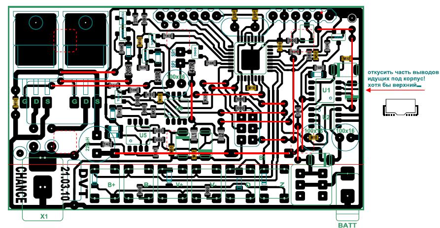

Here Google translation (for now I still prefer for build Chance v1 - Chance v2 maybe as next project somewhere in future):Originally posted by silverdog View PostI found this but have very little info on it - can anyone provide a translation or further info ?
RECOMMENDATIONS FOR ASSEMBLY:
1. ISP connector is made by my programmer, check that the conclusions of his!
Programmed in a fully assembled circuit - was "pure."
2. Pad under the jumper, which is located between the hulls IRF9640, interferes with their installation - a drop of solder do not allow the cabinet "lie down" the whole plane. They can be a bit push a little farther apart the holes, or - I clipped a drop of a scalpel.
3. Contact us for display are derived under an external switch - such a proposal was on forum, to me it seemed competent, I will: - include not want to - do not include ...
4. Dotted rectangles with rounded edges - it's mounting brackets display served me reference not to be installed in these places "high" components.
5. Headphone jack is glued to the board supermomentom, and connected by wires to the SP1, SP2.
6. Two holes (diagonal) - one near the X1, the second - in the upper right corner - fastening display. Stand, screw ... it's simple. The remaining two holes on the display board - unused.
I think that's enough - not in the same space with him to fly ...
7. The meaning of "circumcision" C5, I think, is clear - its upper contact, "short" with the land.
8. The upper layer of fees - the solid earth. Special transitional contacts did - just to ends of the board are two jumpers "over the edge." Cheap and cheerful ...
Like everything ... any questions - write to the PM.

No Decision on the next boards yet
Chance is tempting but no .lay or gerber files exist so I would have to create them, it would be nice to have andy_f permission but he is not responding to emails
TGSL is another possible, but the opposite problem here, many layouts exist
Eldorado is also possible
I have to stake a chunk of money upfront so I need to see some interest that I will recover a good chunk of that money,as yet not much interest beyond these suggestions has been shown

Hi Silverdog,Originally posted by silverdog View Post
I think this Andy's invitation to all MD homemaker to build Chance without expressed limitation in how to get PCBs can be treated as his permission in this case.
There is no difference if I order PCBs from you or here from one of local supplier.
Andy's invitation:
http://thunting.com/smf/pi_designs_d...s-t7657.0.html
