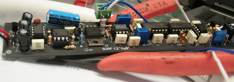

    Soldered the board up last night over a few beers, hooked up the coil (thanks for the instructions ApBerg and Qiaozhi for the calculator) and power supply but only got beeping no matter how much I fiddled with the pots . Decided it was time to go inside have more beers and think where I might have gone wrong.
    Coming home from work today, straight back to the shed, noticed I'd left the two wire joins off the board, soldered them in and woohoo it worked.
    Congratulations ant. Wish you full success in field.
    P.S.: You use unusual PCB fixture - what about shorts?
      hehe
      powered off for the photo
        Hello Ant,
        Nice you have it working. And yes I made the pcb design, but the real genius was Mr. Lahr the inventor and of course White's that make's the real Surfmaster.
        Have succes with it !
        Ap
