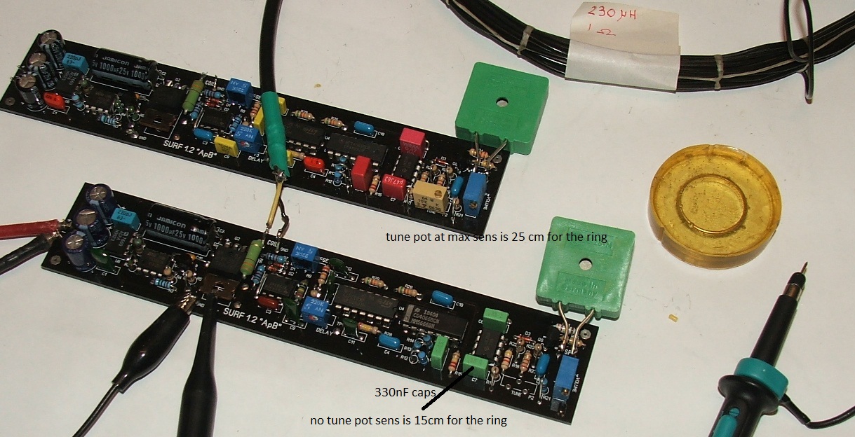

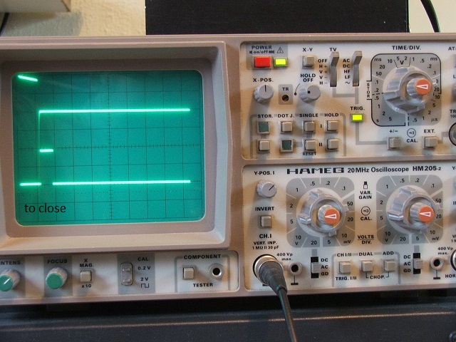

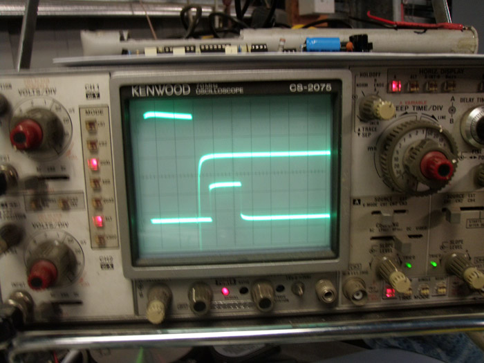

                          Hallo Ant,
                          To be shure that things indeed work ok I have made some checkings.
                          If you leave out the tune pot (and think the offset pot) the surf detects a ring as on the photo at some 15 cm. With the tune pot in place and at max ( just getting threshold ) it is 25 cm + 'Look at the coil, normal isolated wire some 20 turns (I think) works good.
                          The most importend adjustment is the delaypot.... look next message...

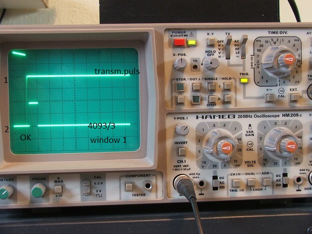

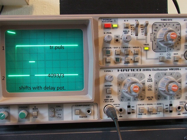

                            ..... with the delay pot you set the sample window's: the 4093 pin 3 and 4 close the switches from the 4066 in time shift , the LM 358 can now see the 'receive signal' coming from the NE5534 at 2 different time's .. this lets the detector know if there is "anything" in the receive signal. So the delay pot is imported the fist window to close to the transmitpuls give's some problems.... to far less sens.
                            Wel look at the scope samples ... hope this helps ..
                            Best regards.
                            Ap

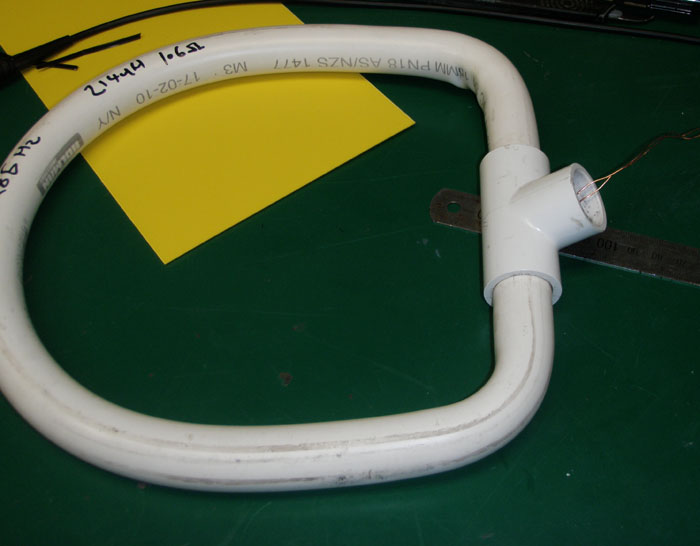

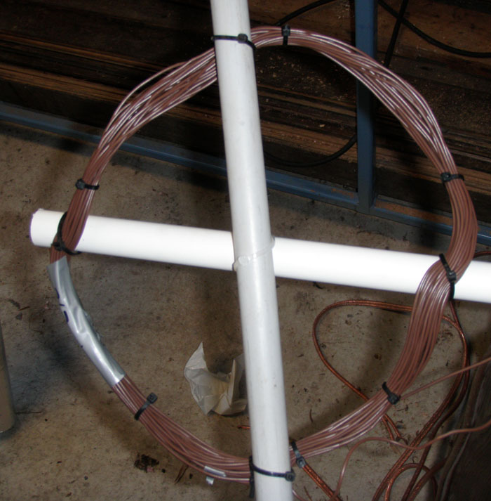

                              Hi App
                              Thanks for your ongoing help. I hooked up the scope and started to understand the circuit better, and my delay/tr looks the same, the delay pot does the same as yours.

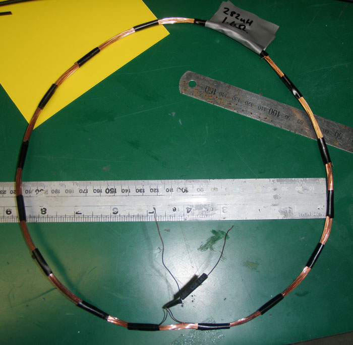

                              I disconnected the TUNE and OFFSET and managed to detect the gold ring at about 80mm. So I made two more coils;
                              PVC; 214uH - 1.6Ohm
                              Brown hookup; 267uH - 2.5Ohm
                              enamel; 282uH - 1.6Ohm
                              But much the same results, I'll study coil making tomorrow and try again.

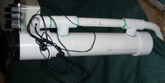

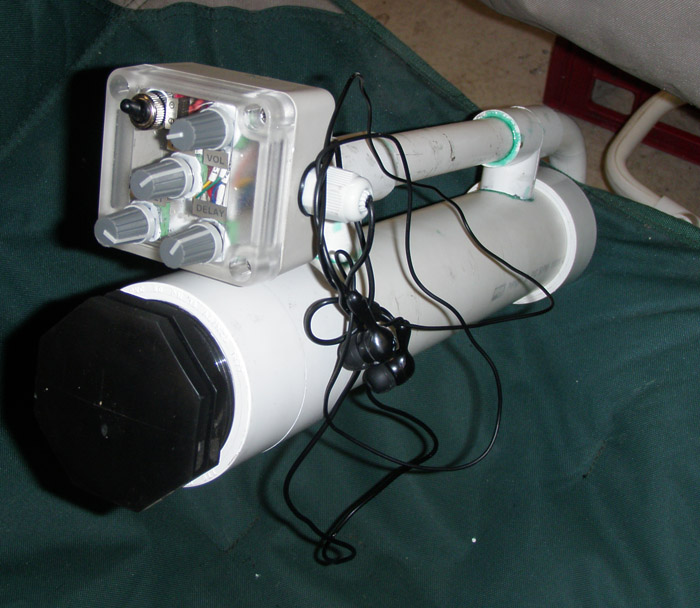

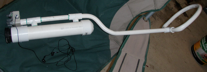

                              Here are some pictures of the case anyway, not ready for water testing yet but not far off.

                                Hello Ant,
                                You have done a lot work... nice control panel ! Do you have special potentiometers for it that are waterproof ?
                                Your detectors sens. is to low , if al is ok it must detect over 25 cm, I am shure you wil get that.
