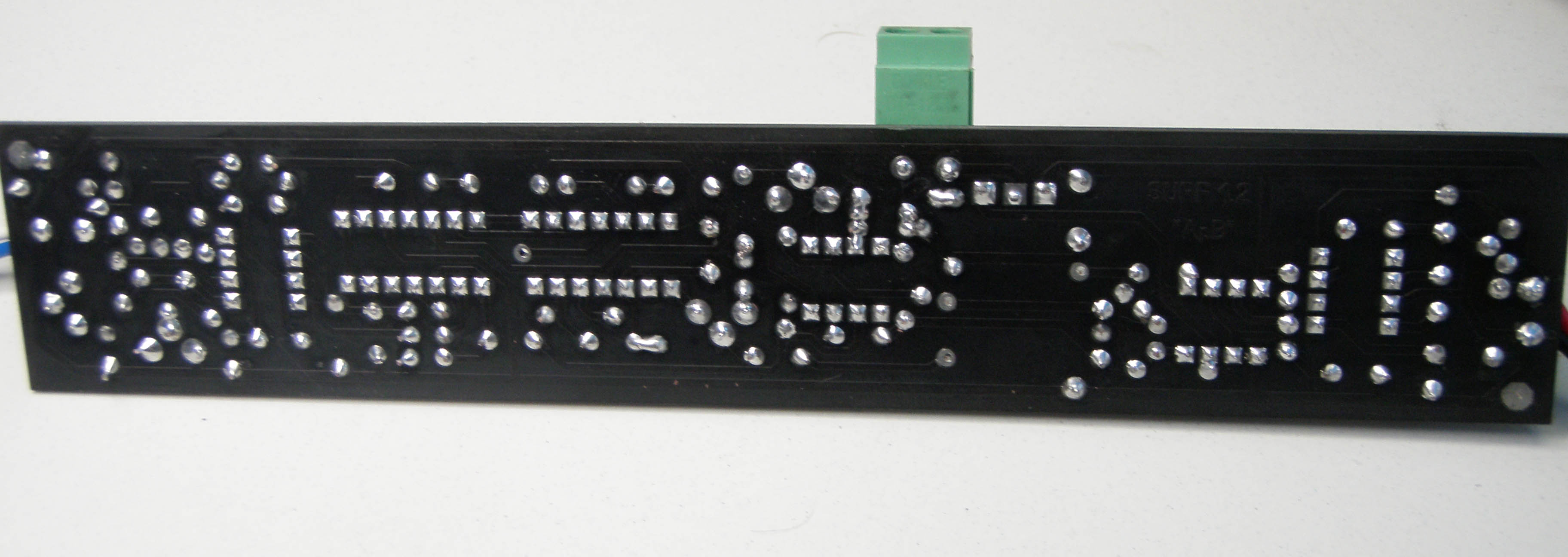

        I went to Victoria's "Golden Triangle" for Xmas so haven't been able to post here for a while, I didn't find any gold either

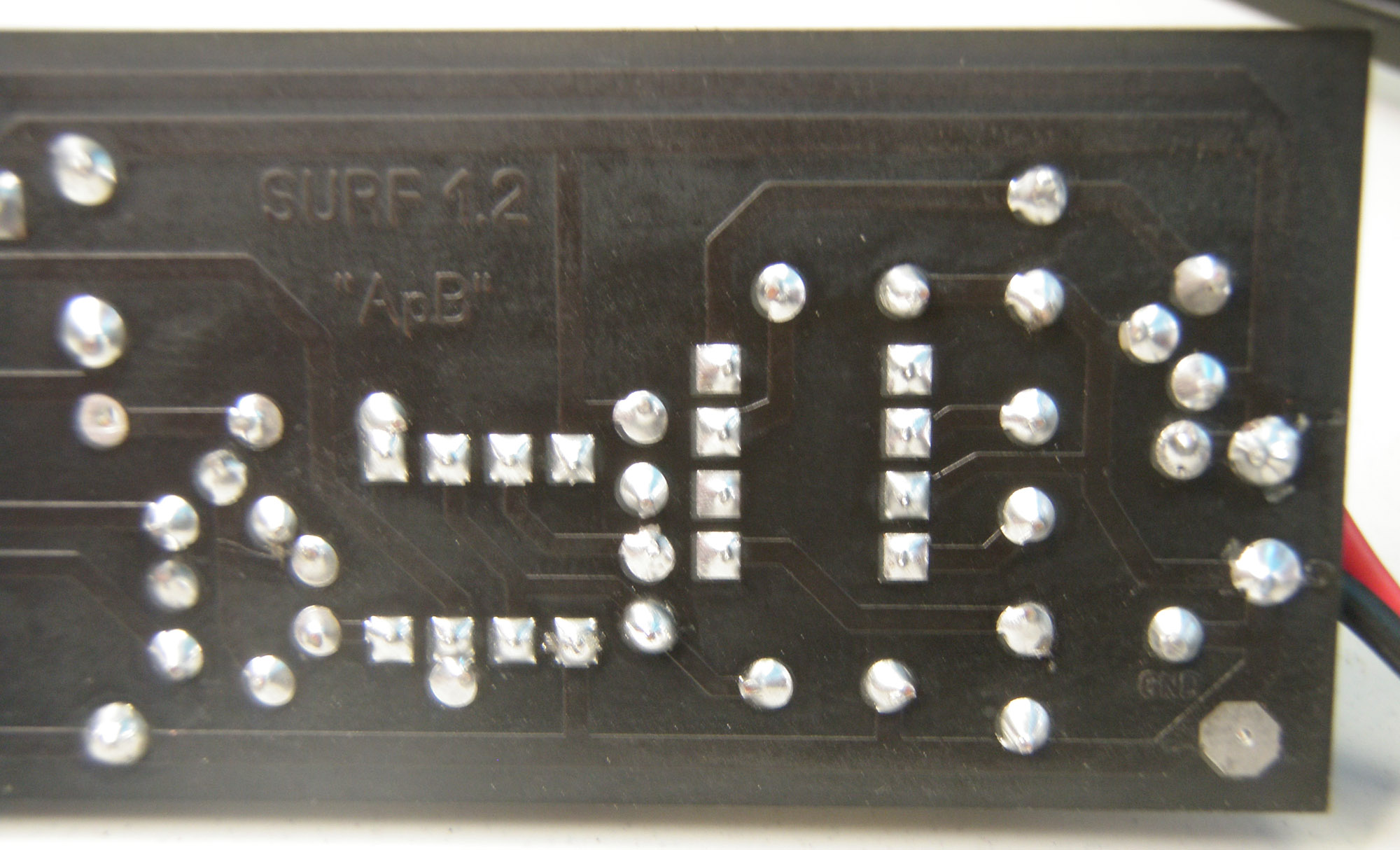

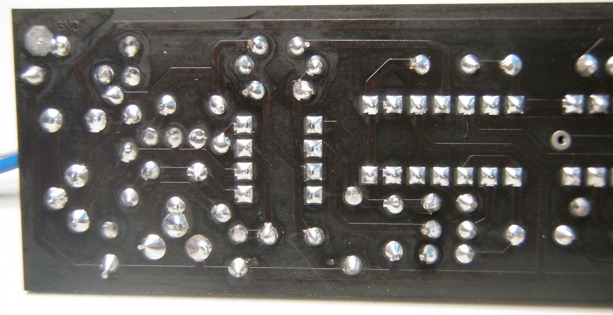

        Anyway, here are some pics of my PCB:
          Hi micheal.
          I will like to have those pictures if is posible. I f so could you send me an email to [email protected]

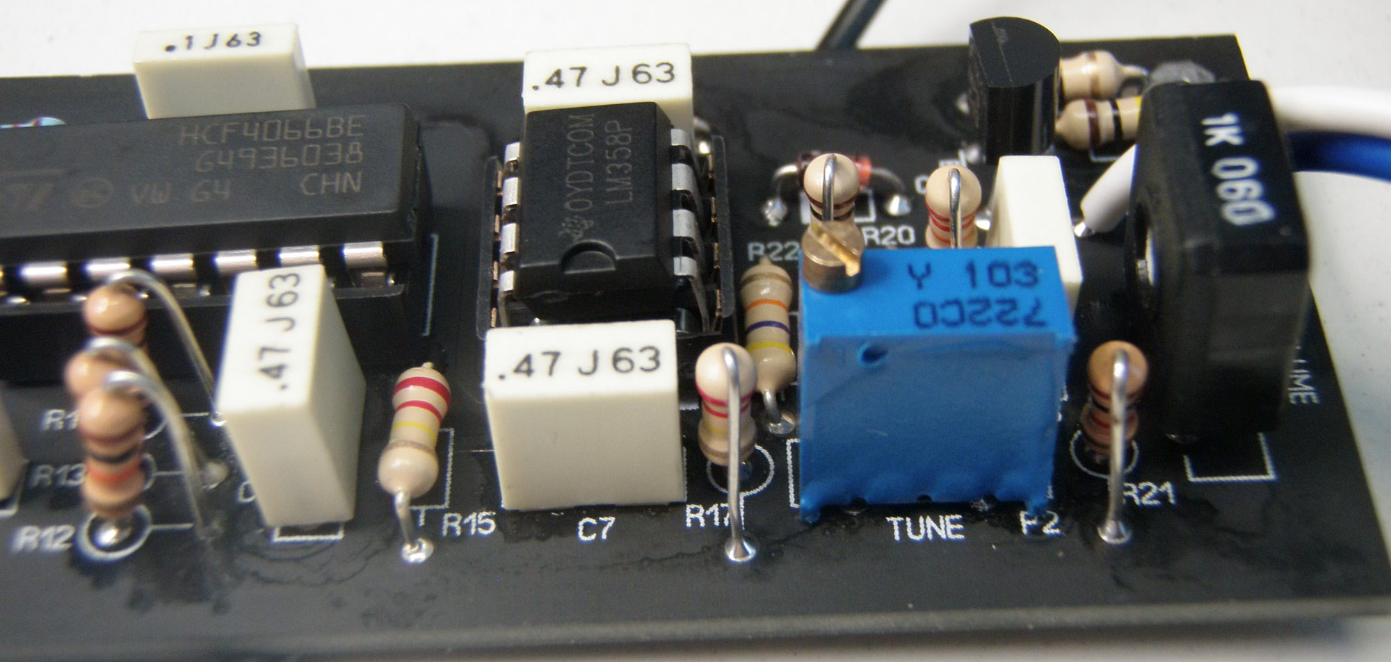

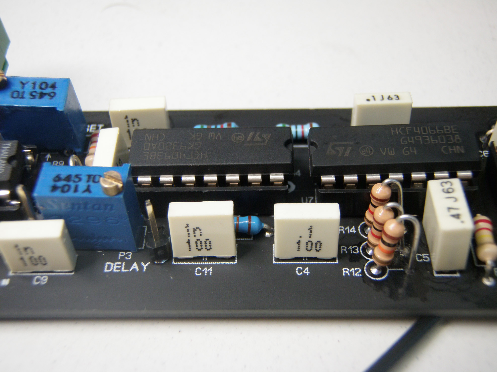

                      • #41

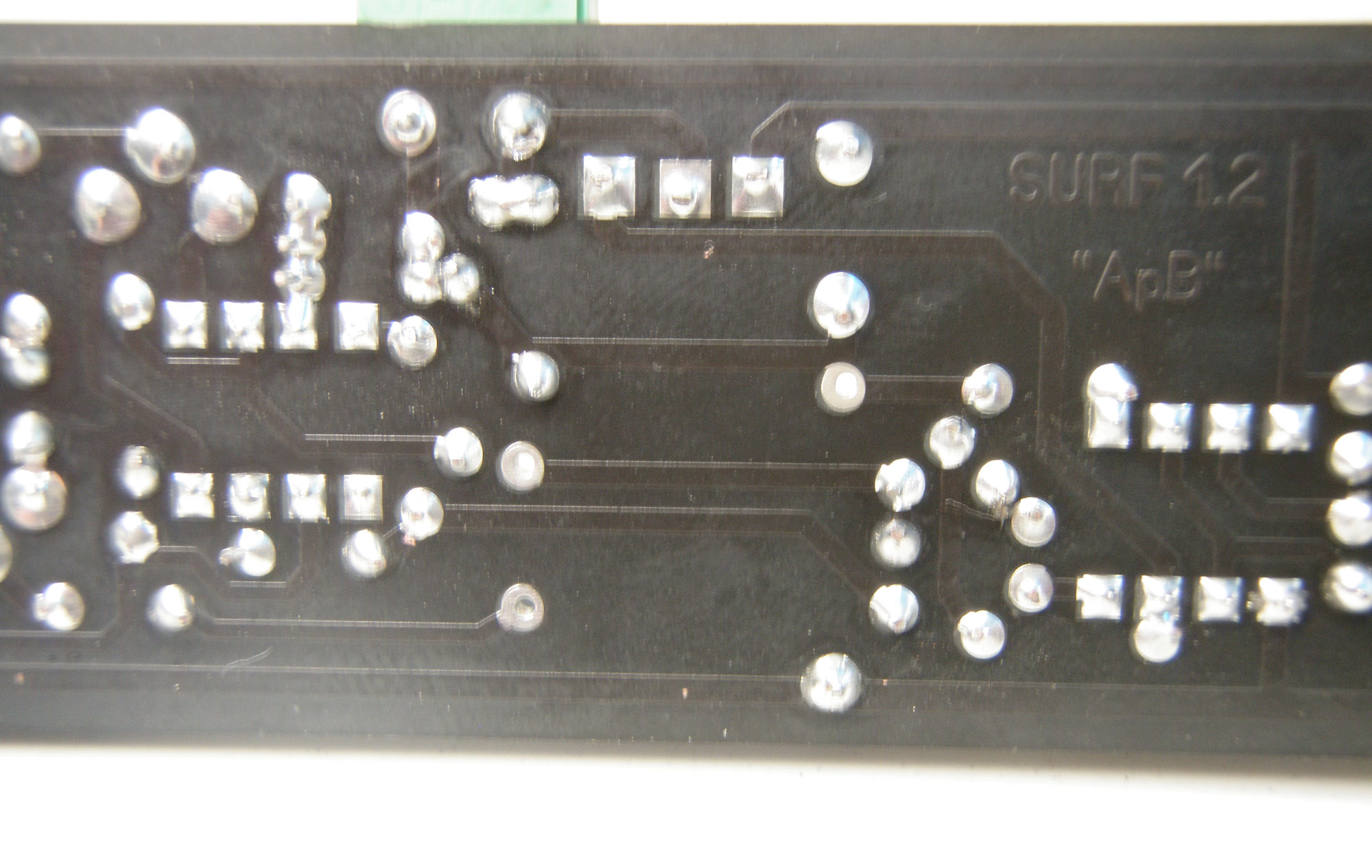

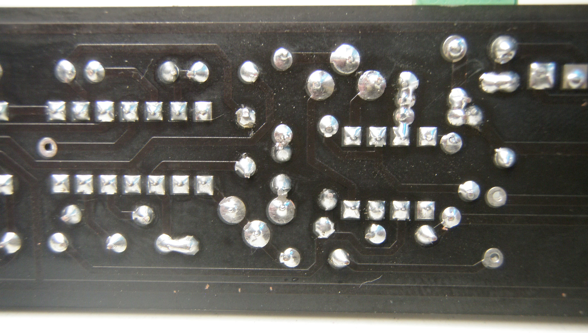

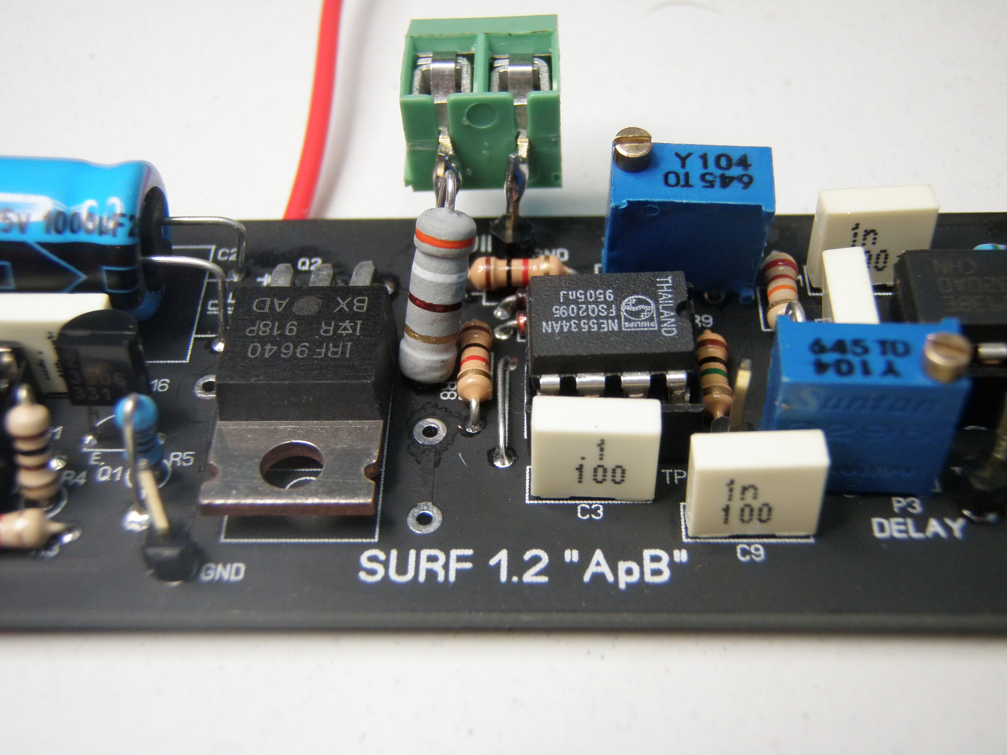

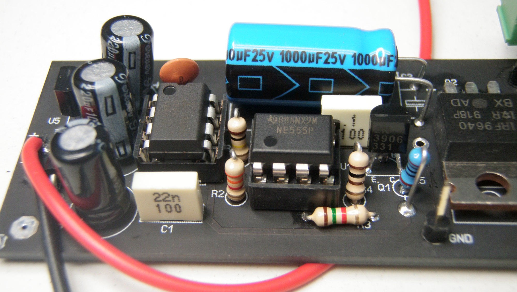

                        Hi Ant,
                        Glad you got your detector working. I am still building my first SurfPI.
                        I was looking at your pictures and noticed the 100N cap above the 555 chip appears to be in the wrong place. I think it should be over to the right in the spare solder pad in the picture. I think it is called C16.
                        In the pictures Silverdog supplied the right hand pin on the cap appears to be in line with the pins on the large cap just above it.
                        I could be wrong as I am new to this and learning also. Perhaps some more experienced builders could look at the photos and check this.
                        Hope this helps.
                        Grant
                        • #42
                          Originally posted by gcause View Post
                          Hi Ant,
                          Hope this helps.
                          Grant
                          I think it looks ok, for a 5mm box cap
                          I think in an earlier picture I had used a green film cap and used the spare pad you refer to for the right leg, as the leg spacing on these is much wider
                          Silverdog
