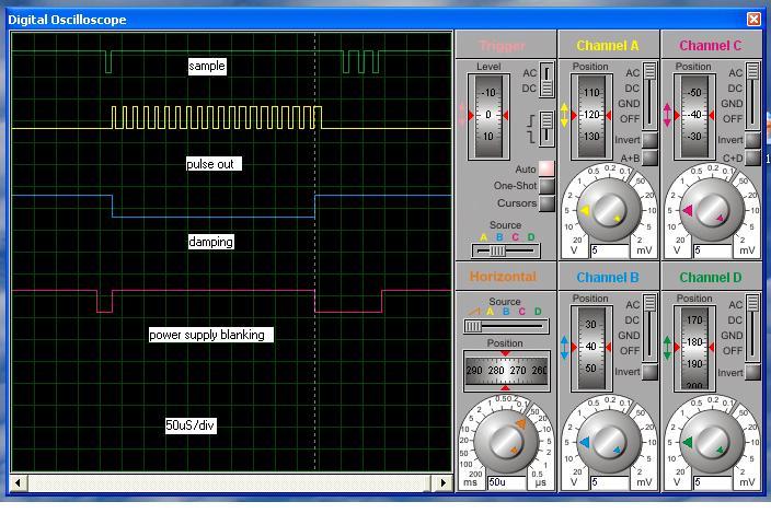

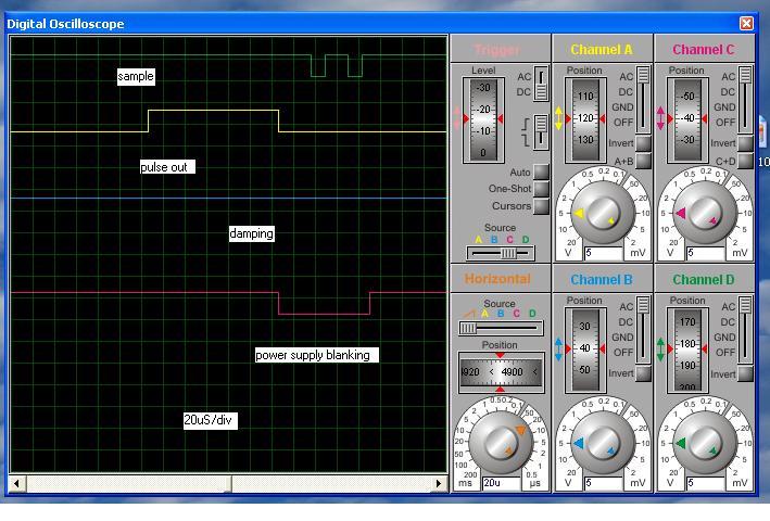

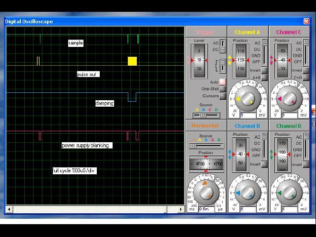

                    I simulated the code, here are some screen shots of the timming. Sorry for the quality
                    I think because the sample timming is fixed. The coil must be well matched and be exactly the same as Andy's when he set the timmings in code. For decent results.
                    I hope somebody will post some scope pictures in the future with different targets
                    Regards Mark

                      Very good simulation, excellent job, works exactly like this in real world, observed on scope. I had some pics of different w-forms, but it was while ago, i will post if i manage to find them.
