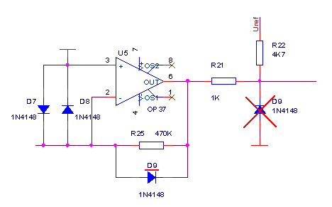

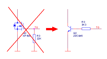

              Andy F has released new firmware, Version 1. This new version requires removal of D9 and a value change of R9 to 820 ohms. Also Q2 & R3 are now replaced with a 2SC945 and R3 becomes 3K3 (3000 ohms ?) on the base of Q2.

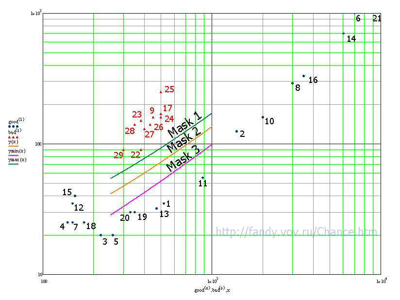

              Apparently the new software has only 3 masks for FE discrimination and a chart of allegedly much improved metal discrimination is provided on the CHANCE site. The chart shows results with brass, copper, silver, nickel, zinc, aluminum, iron, & lead...but not gold.
              Below is his quote from the MD4U Russian web site:
              I finally present the new version of piercing - 1.0. To [skachat] it is possible from the page of instrument - http://fandy.vov.ru/Chance.htm . Program is completely rewritten, I hope, it came out better than it was. If something not then - it is reparable . For the correct work of the new version it is very desirable to conduct the apparatus modifications, indicated there, they in no way complex. END QUOTE

                Graph comments (translated by Google):
                1. 5 cents of the USSR (brass)
                2. Soviet Union 2 kopeks (brass)
                3. 15 cents 1915 (Ag, billon)
                4. Russian 5 rubles (Cu)
                5. 20 kopecks 1923 (Ag, billon)
                6. 20 kopecks 1938 (nickel)
                7. 1 kopek Nicholas I (Cu)
                8. 2 RUB
                9. 10 rubles 1993
                10. USSR 1 ruble (nickel)
                11. 5 cents of the USSR (brass)
                12. 2 kopeks, Alexander I (Cu)
                13. 10 pfenigov, III Reich (Zn)
                14. 1 Russian ruble
                15. 5 cents Catherine II (Cu)
                16. 1 kopek Soviet Union (Brass)
                17. 50 rubles in 1993
                18. Roundels (Al) <----------------------- this can be near to gold caracteristic
                19. German Button (Al)
                20. Bullet Mignet (Pb)
                21. 15 cents 1940 (nickel)
                22. Nut (Fe)
                23. Tin circle (Fe)
                24. 50 kopeks Russia (Fe)
                25. 10 kopeks Russia (Fe)
                26. Roundels (Fe)
                27. 5 cents of the Russian Federation (Fe)
                28. 1 kopek Russia (fe)
                29. Bolt (Fe)

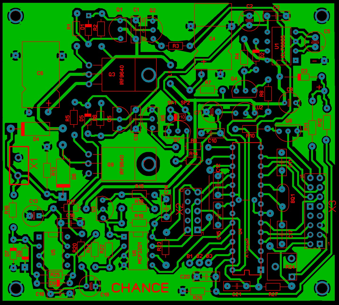

                    I didn't realise how few CHANCE pcb's I had left after this weeks little burst of activity following the new firmware
                    I will need to order new boards very soon, could someone check the proposed pcb layout changes following the mods required for the new firmware
                    Any other suggestions for changes gratefully received - hole sizes etc.. ?

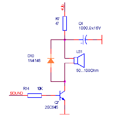

                      It appears that F Andy has another release, Version 1.0.1 FYI. According to the Babelfish translation it has to do with eliminating some of the 'Flicks'.
                      Also quickly looked at the board vs the mod schema and it appears the diagram for the speaker mod has the wrong polarity sign on the 1000 uf cap. Should be + not - where the cathode of the diode meets the cap. The diode can be easily mounted near the speaker connect points of the board.
