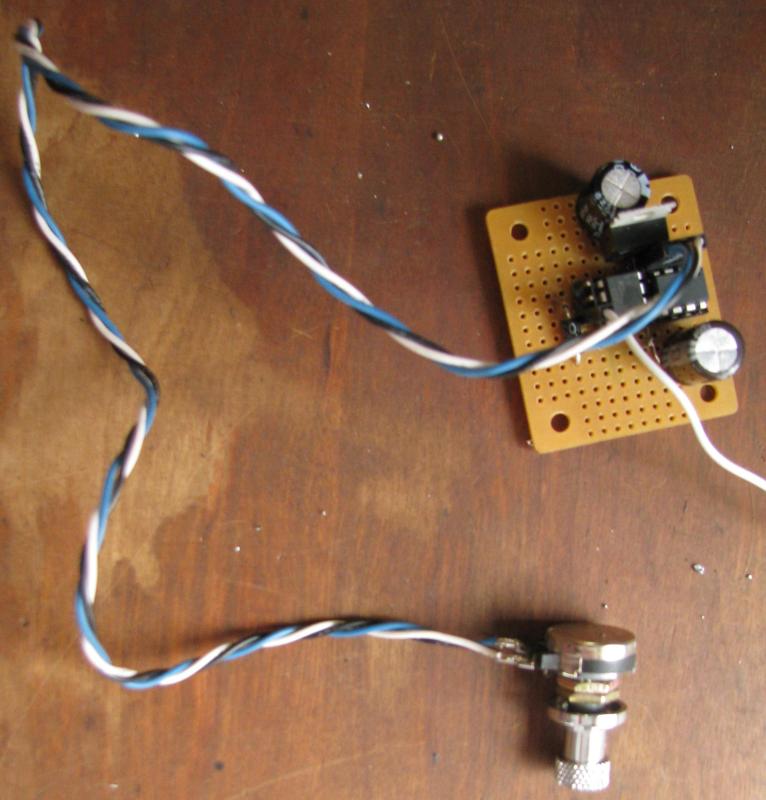

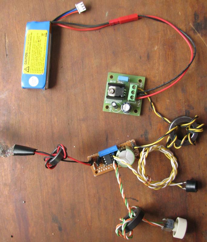

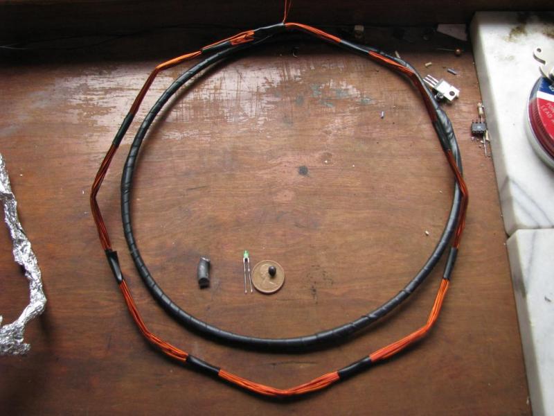

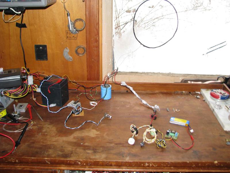

          Here are some pictures of my setup, I will try to upload a video later
          Thanks!
          Jon
            Mess
            I guess vBulletin dosn't handle images very wheel **sigh**
            You can use Ctrl - to zoom out, at least you can see them that way
            I resized them, hope that helps
              Pictures
              The coils you see are not in use, just ones I tested, the one in use is attached to the window
                Thanks for the photos of your detector Jon. I like the look of it, particularly the compact size of the circuit. Will you be able to post a schematic and source code so that we can build one too?

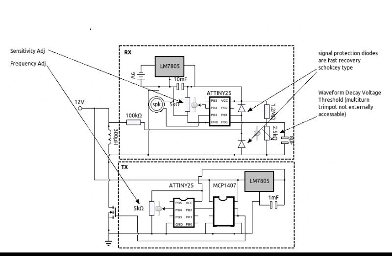

                        Schematic
                        Here's a Schematic of the detector, I think it closely resembles what I've built but if you see any errors let me know. I didn't remember the value of the signal receive current limiting resistor in the rx but I think It's
                        somewhere around 100k, I'll open up my detector some time and get the exact value.
                        Good Luck! and if you need any assistance or If I missed something, just let me know
                        P.S. I'll upload the hex files soon

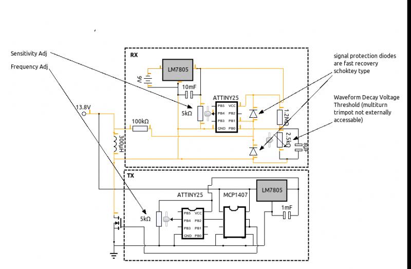

                            it looks like a very nice project. There is one thing missing in the schematic - the audio output. Am I right or just do not see it?
                              Good Point
                              Good Point!
                              I forgot all about that!
                              I'll update the schematic
