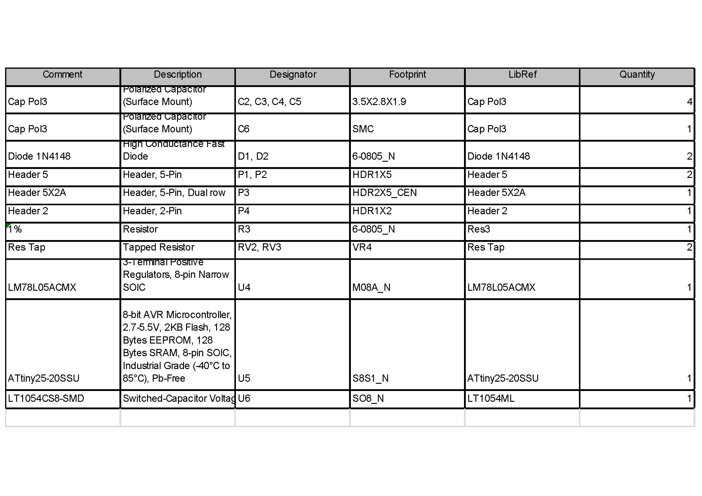

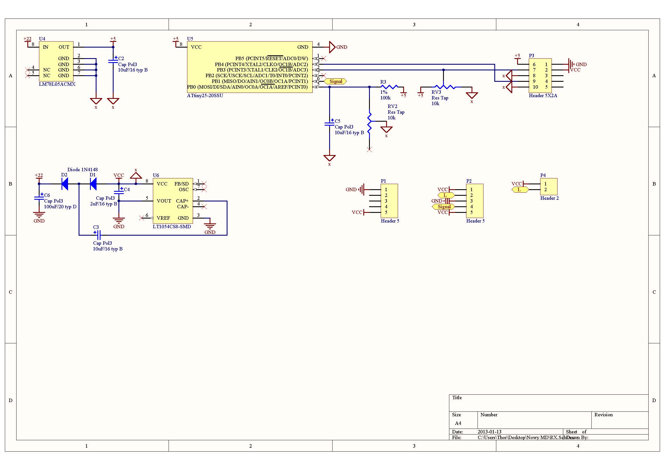

        Only +12v
ID:	334562Click image for larger version
        Will it work?
        Header P3 is only for external pot with power switch.
        • #94
          Wow, interisting concept, the power supply looks good, do you have plans on how your going to hook the FET up yet? Or did I miss that in your design?

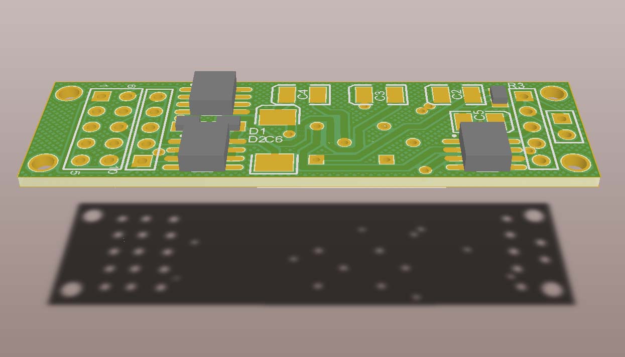

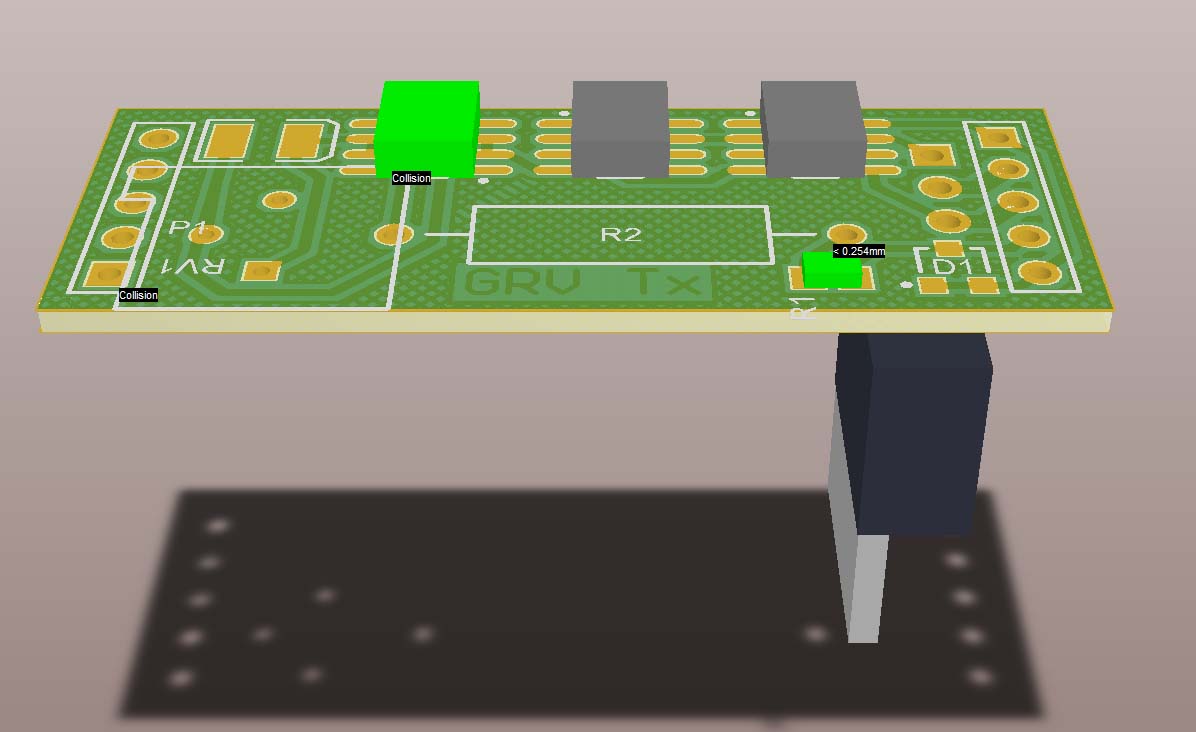

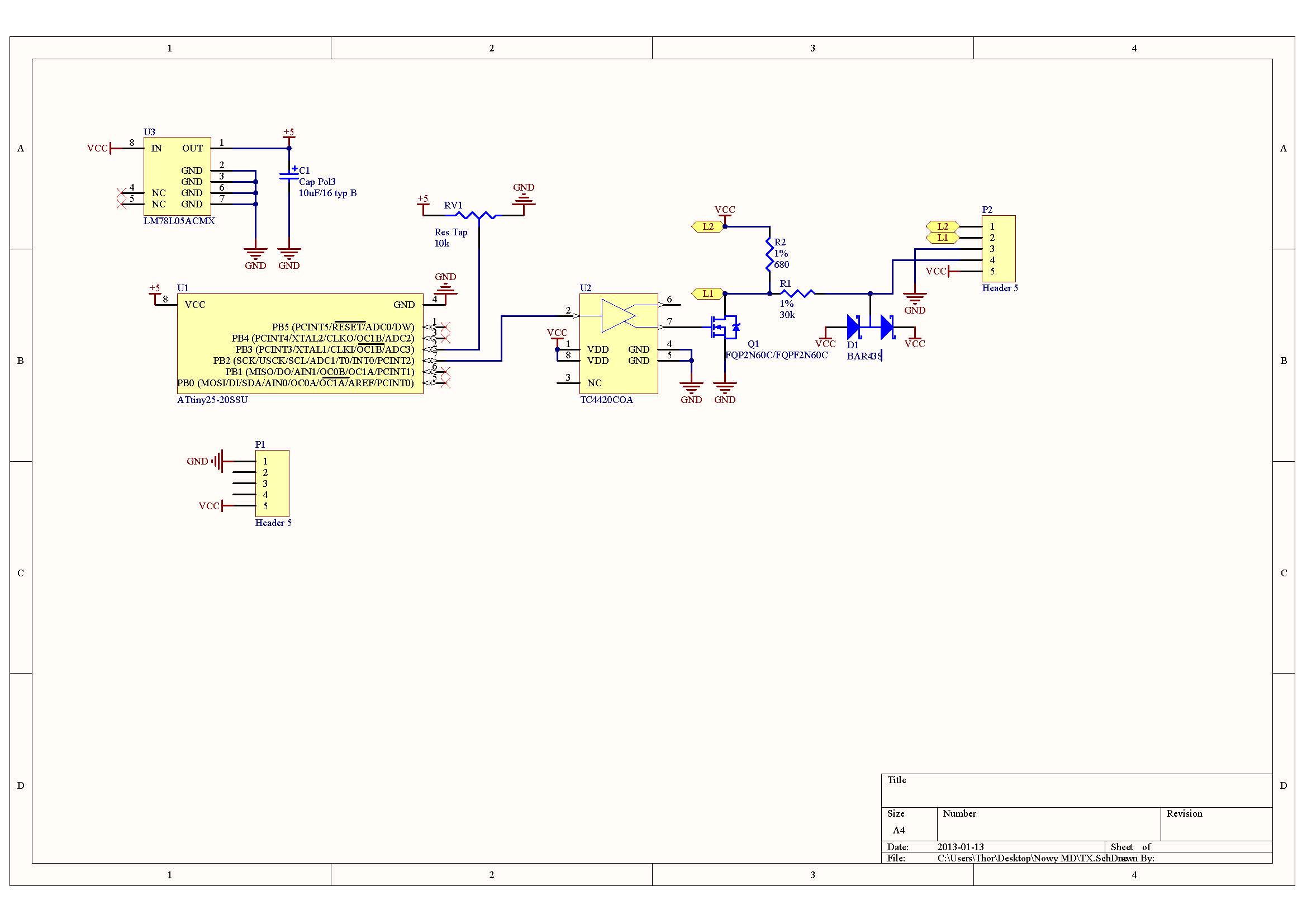

            Helo Jon again
            TX and RX is on separate boards connected using goldpins. I just need to add connection for capacitor somwhere near coil.
            This is TX section:
            PCS's:
ID:	334569Click image for larger version
            Collision on TX PCB is by mask of POT ( i don't have slim one footprint)
            Board sizes:
            TX 15 mm x 40 mm
            RX 15cmm x 51 mm
            Also i think to add LF357 inverting signal between diodes and signel reciver, then only 12V without power doubler should be enought
