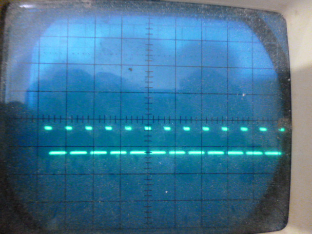

    Hi Jon
    this is the result of the new hex as above post
    I have burned virgin chip #3 with new hex
    and the pulse train from pin 6 is about 325 pps
    the pulse is positive going its about 1.6 milli seconds wide
    and about 1.6 milli seconds between pulses
    I have reburned old chip #1 with the new hex as well this morning will see if any difference
    i did get the same text result as I posted above for the reburn
    Has anybody else tried this ?
    • #77
      Jon
      I have just tested the reburnt chip #1 with the new hex
      and the pulses have changed to the same as chip #3 that also has the new hex
      the pot has no effect
      with the new hex
      cheers

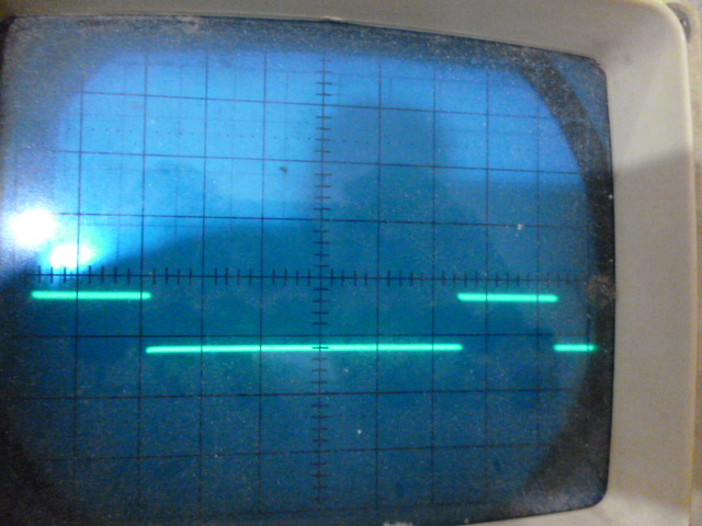

        • #79
          Jon it works now
          thanks for your efforts
          pot on pin 2
          pulses on pin 6
          pulse width changing from about 100uS to about 1ms
          need to check PPS
          well done thanks
          cheers
          6666

              • #82
                Ooops sorry Jon meant to say pin 7
                fat fingers on the keyboard
                just checked with the Frequency counter
                and the PPS go from about 255Hz to about 2.5KHz
                6666
                gee I need to clean that screen
