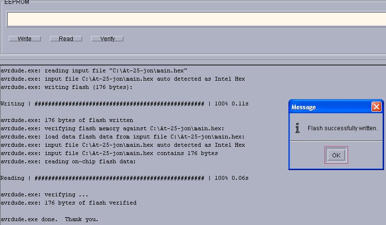

                          • #73
                            I have burned virgin chip #3
                            That almost sounds as if it has lost something
                            You know these chips can be reprogrammed thousands of times right?
                            • #74
                              Hi jon
                              yes i know they can be reprogrammed
                              but i bought 3 and wanted to be able to compare them
                              tomorrow i will try a shorter parallel cable
                              just in case the signal is a bit low
                              here is the report , says it verified 176 bytes
                              cheers
                              • #75
                                Everything looks good there, It's verified so everything should be good.
                                Is the new hex working?
