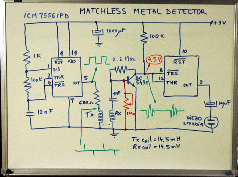

    Hi Guys,
    I played with a Matchless metal detector circuit, designed by Rev Thomas Scarborough.
    I modified a few things and it started working better. It is far away from the performance of Hammerhead, but I bet it works better than some other metal detector projects.
    I uploaded a (poor quality) video on youtube, you can have a look at it here: http://www.youtube.com/watch?v=tBdBsYcVlS4
    I hope that soon I will upload a better quality video, plus the modified diagram.
    The coils are not built according to the specifications, I grabbed two CRT coils that rotate the image (the small round coils close to the neck of the CRT tube). They have approx 14.5mH, while the original design would use something like 1.5mH.
    Nicolae

      Hi WM6. Here is the new diagram. Not much was changed, but the operation improved significantly. My conclusion is that the original design could have not worked too well with a transistor with high amplification factor (such as BC549C). Having a potentiometer between base and emiter allows a better adjustment of the voltage in the colector of the transistor, which should be around half the power supply voltage. Unfortunately the power supply has to be stabilized, otherwise the detector will require readjustment very frequently. I suppose there can be a few more improvements added to the diagram, such as an R-C group in the emiter of the transistor (maybe a 1kohm resistor and a 10uF tantalum capacitor) and the pot should be lower value, surrounded by some resistors. Maybe I will do some more testing later.
      I uploaded a new video for the Matchless detector on youtube. I better give you the channel, because I might delete it again later. http://www.youtube.com/user/nick1f
      Nicolae

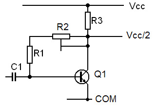

        Nicolae, for more sensitivity you need more amplification of RX signal, ie instead transistor you should use an opamp.
        For the present try attached transistor circuit with better stability of operating point relative to threshold of comparator. When battery voltage changes, it will maintain better collector voltage as half of supply voltage.
        You can also increase TX power. For this purpose you should use NE556 instead ICM7556 and should reduce resistance connected in series with TX coil.

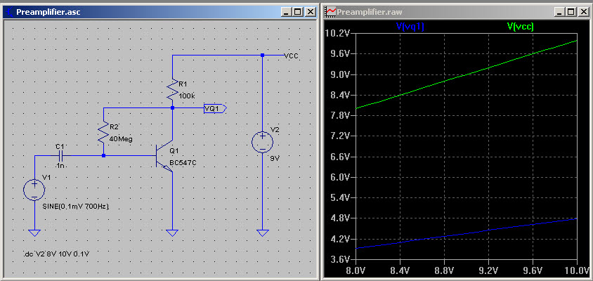

            Hi Mike,thanks for feedback. I initially tried the circuit the same way you have drawn it. But you will soon see the insane value of the base resistor required to bring the voltage to approx Vcc/2 (which is over 30 Megohm!). I have done a Spice simulation and although the voltage on colector still varies.

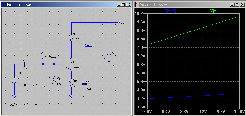

            You can see how by adding the resistor betwen base and emiter, the base resistors have decent values and also it seems the voltage on colector is more stable than in the first case.
            I also simulated the circuit with a RC group in emiter. Even if it does not seem to be as stable as image 2, I think it will improve the behaviour when temperature variations appear.

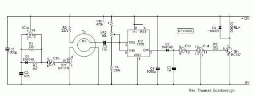

                Another project from Thomas Scaraborough. Coil can be DD or OO type ( RLA can be replaced by buzzer):
