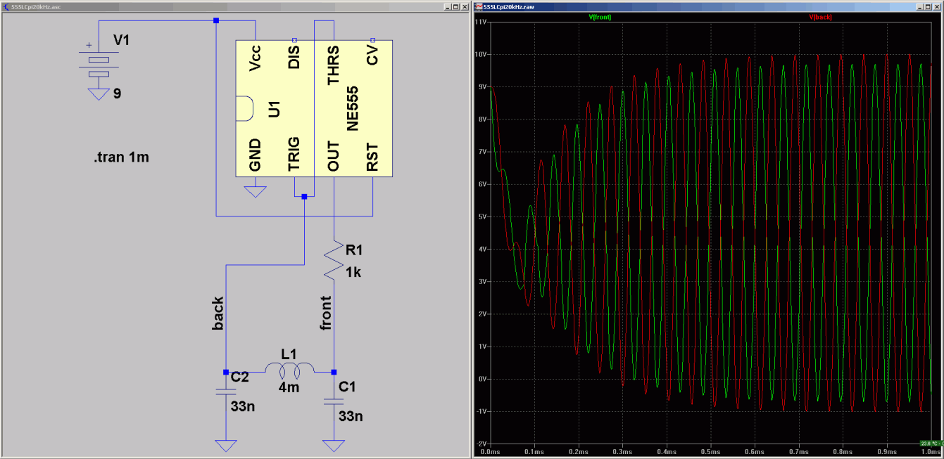

                    Just a sneak peek to what I'm playing with, a 555 sinus oscillator. It is very efficient, and gives a very pure sine oscillation with full swing across coil ~2xVcc. There is a series R within coil of 4ohm.
                      Interesting sneak peek
                      is it running at 20khz
                      the coil is 4 ohm , whats the rest of the coil specs ?
                            Please don't mix my spiced-up imagination with reality. So far I'm exploring some interesting features that could lead to some simple and useful design. You'll know when it's ready.
                            The example here is designed at 20kHz simply because I wanted to observe some features, yet didn't want to wait to grow old before spice finishes. It will go higher, and coils will go down to ~1.5mH ... I guess.
                            The way you see it now - it eats TGSL Tx on every account.

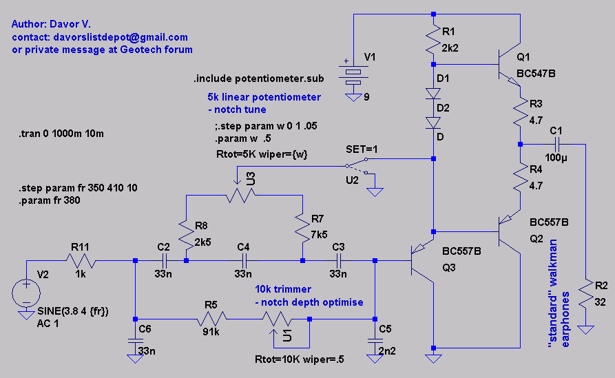

                                I finally decided on audio stage, and it is a combination of notch at about 380Hz (+ and - something) and a simple buffer stage to supply simple walkman earphones. There are 3 controls altogether,
                                • a switch to decide between simple notch and a feedback notch;
                                • a 5k potentiometer to tune a notch;
                                • a 10k trimmer potentiometer to optimise a notch in feedback.
                                Feedback notch is sharper and at distance from notch frequency louder than the notch without feedback, perhaps even too loud, hence the switch. It will be easier to hit the notch frequency without feedback.
                                Using a notch is a substitute for low frequency BFO, but without synchronisation locking risk, and with much nicer audio. In fact, I am planing to make this frequency distance even more distant. I have already found the incredible simple and sufficiently efficient mixer for the purpose, with a flick. And a nice one. Will post it here soon.
                                I expect a whole shebang to comprise 3 555s, a CMOS XOR, 4 transistors and a small bunch of passives. Nice and easy.
                                The attached simulation is set for FFT at R2 output to indicate a notch action.
                                Here it goes:
