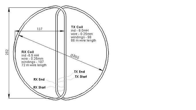

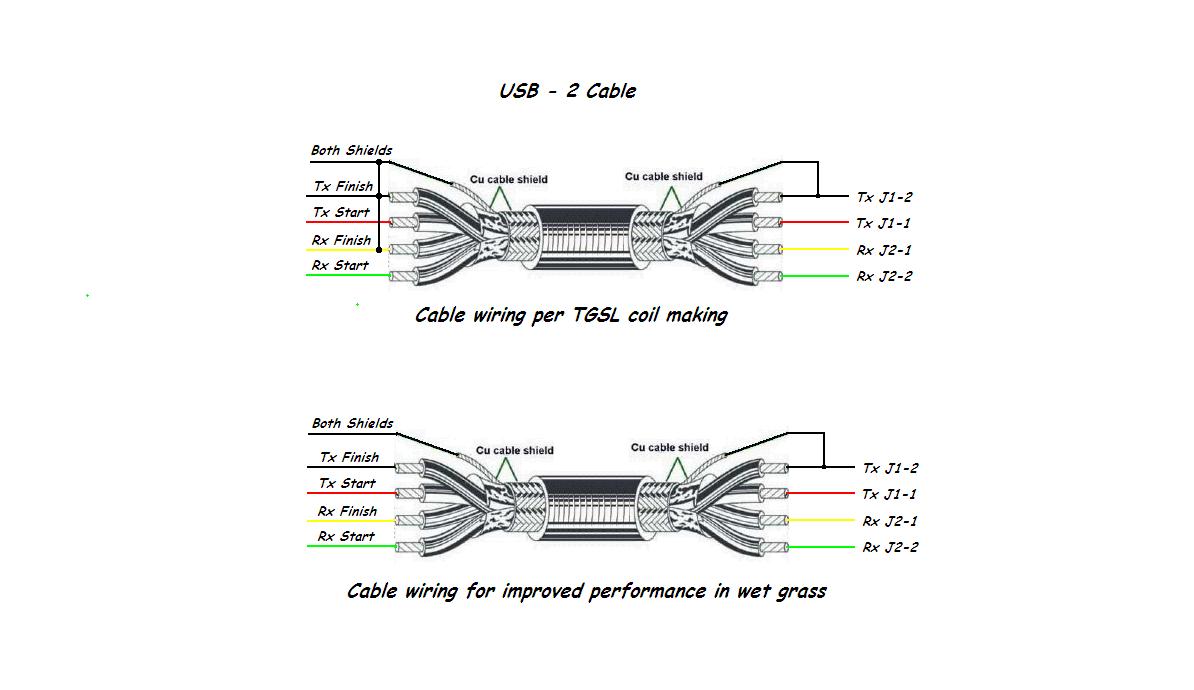

                    • Confirming Coil specification
                      Hi Ivconic,
                      sorry to bother you but I am at the exact position of starting to make the coils for the IGSL with TGSL coils. The Kit has been ordered from SilverDog and I am going to use the info's about windings and impedance's given in Don' Bowers excellent TGSL 101 Part 1, that is all on the following picture, I hope its readable:-
                      Are those the correct details to use, or do you recommend any changes? See the first picture.
                      Also I plan to use the "wet Grass" connection diagram using a USB cable to the electronics, as shown in the second picture.....any comment there?
                      I wish you a great weekend and sorry to disturb you in any way.
                      Thanks in advance also.
                      Andy
                      • hello Andi
                        is correct
                        • Originally posted by der_fisherman View Post

                          Yes, I would like Ivconic's opinion here as well. I can tell you that I have extensively tested the "wet grass" configuration and that is the only way that I will ever build another TGSL coil!! I have completely built in the neighborhood of 10 or 11 coils now. Ivconic has probably built may more. Very early on in the TGSL posts, Ivconic was using a similar grounding configuration, but then later changed it to the configuration at the top, per Tesoro's standard for some reason.
                          The big difference is that U101a pin 6 does not connect to the shield in any way, I was speculating that noise from the coil in wet grass was coming from that connection. Disconnecting it solves the problem without creating other issues.
                              Hi Ivconic,
                              Andy
                              I forgot to mention it in my earlier email, but the reason I believe that the first wiring configuration gives problems, is simply because you have a ground loop. On the "wet grass" configuration you have no ground loops.....ground loops should be avoided at all costs.
                              Even if its not the "real" problem, its still not a good idea.....
