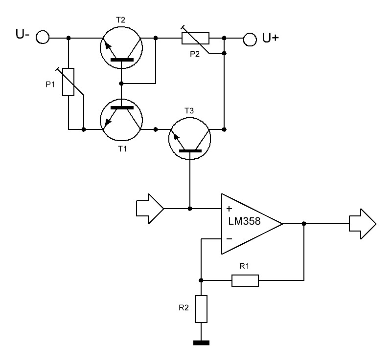

Name:	FoxyLab LM358.JPG
      • Originally posted by DonCaffeDelaSkobalj View Post
        [ATTACH]51022[/ATTACH]
        Tell us the purpose of this circuit.
        P.S. The metal detector analyzes the signal of one polarity only.
        • I gues this circuit provide constant load for positive voltage. For shortening opamp settling time after tx pulse?
          • Originally posted by Vadim18 View Post
            In this case, this addition is not very relevant - the saturation section of the operational amplifier/ADC is longer than setting time.

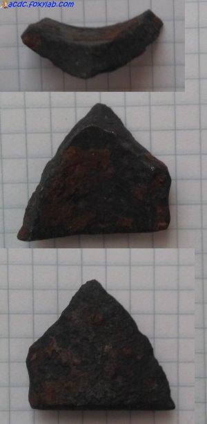

            • One of the new garden finds from FoxyPI -an unidentified non-magnetic "light" metal part:
              • input currents compensation and temperature drift also.

                  • One of the new finds in the garden with a metal detector FoxyPI (after electrolytic cleaning):
                    The thickness of the metal (5.5 mm) and the characteristic shape are an echo of WWII. I calculated the inner diameter, which turned out to be approximately 4.3 cm.
