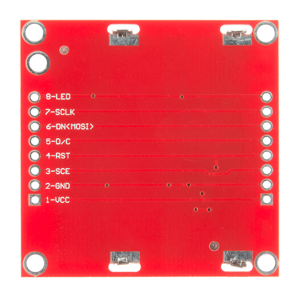

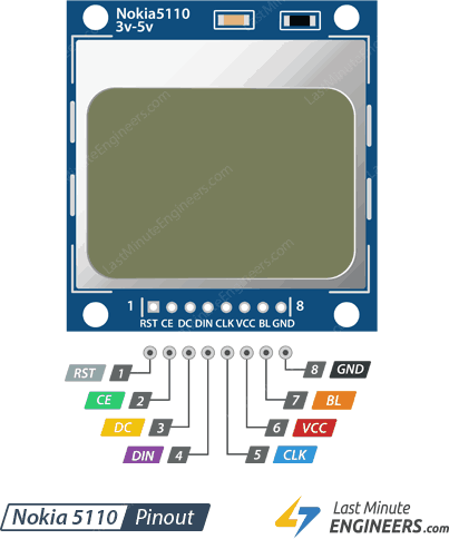

    • Hola FoxiLab. In fact, the pinout in boards blue and red have diferent order. I still don't know the color of the textolite of the display that have mi friend but i have the data of both LCDs
      • This is the blue one...Click image for larger version
        • Originally posted by Rodelio View Post
          This is the blue one...[ATTACH]50848[/ATTACH]
          It is not a matter of the order of the contacts; they are easy to identify by labels. I only work with blue indicators, so I can’t check this statement - supposedly the red ones are supplied with ground, but not power, to LED pin.

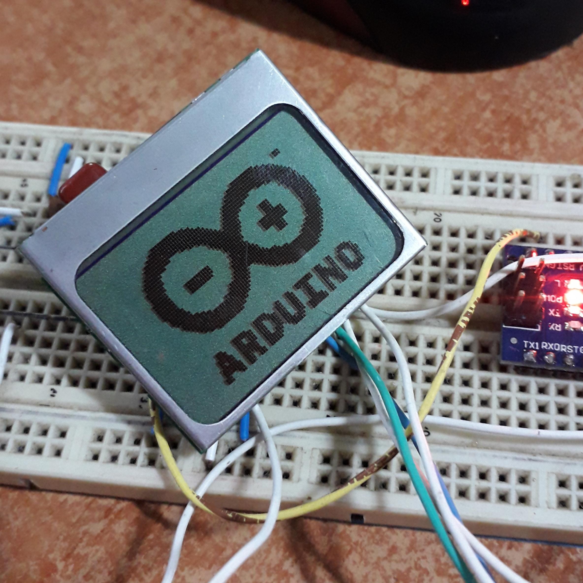

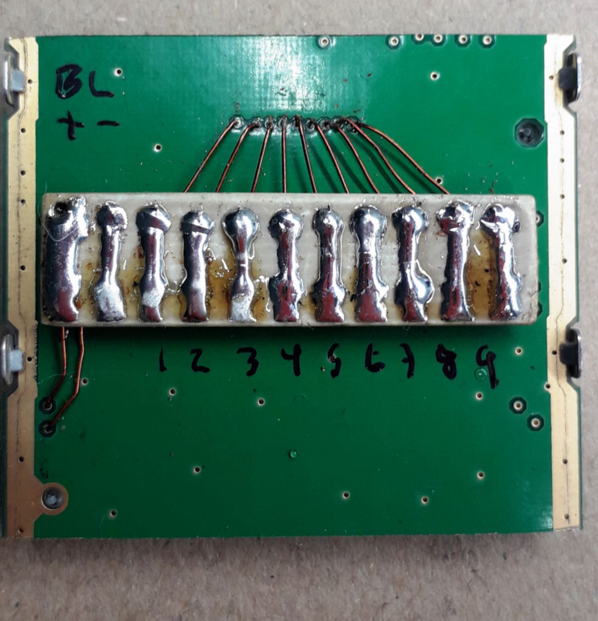

          • At last i recived the lcd from my friend. No red, no blue one. I had to cut it directly from the board of nokia cellphone. I already make the conections and is ready to work.
                This is the front view of the display. The order of pin conecction change when we put display upside down.
                • Now only need time for build the PCB and write the atmega. I will doit with arduino uno as ISP and Xloader software. It work on the felezjoo projet with no problems. Any progres i will post.

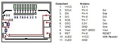

                      • In the picture of the post 247, There's only need a non polarized capacitor 1 to 4.7 uF conected from pin 8 to Ground. "Pin 8 to 9"
                        Last edited by Rodelio; 07-25-2020, 09:57 PM. Reason: Forgot put the nr of the post

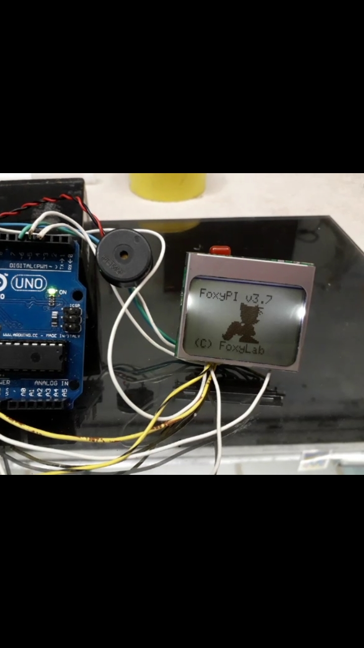

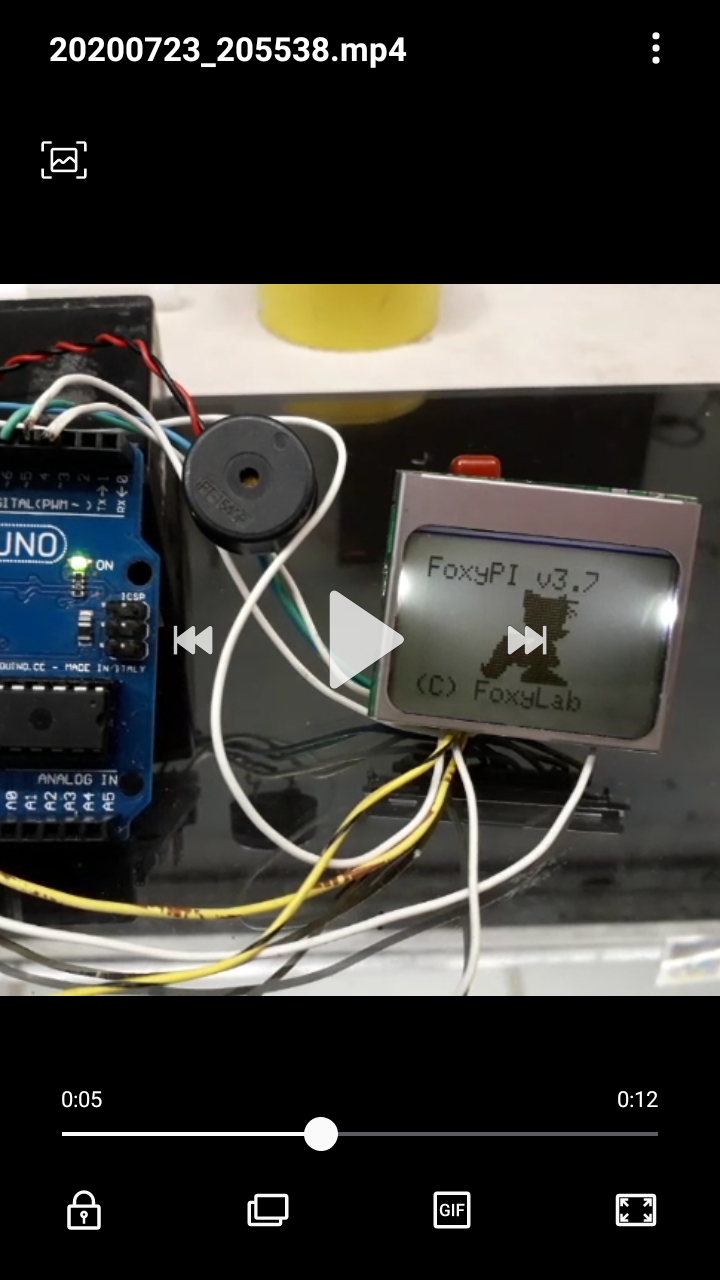

                        • FoxyPi hex file working in a little island in center of americaClick image for larger version
Name:	Screenshot_20200725-220438_Video Player.jpg
                          I don,t know how to upload videos, so i post a screenshot from my samsung cellphone.. Click image for larger version
Name:	Screenshot_20200725-222029_Video Player.jpg

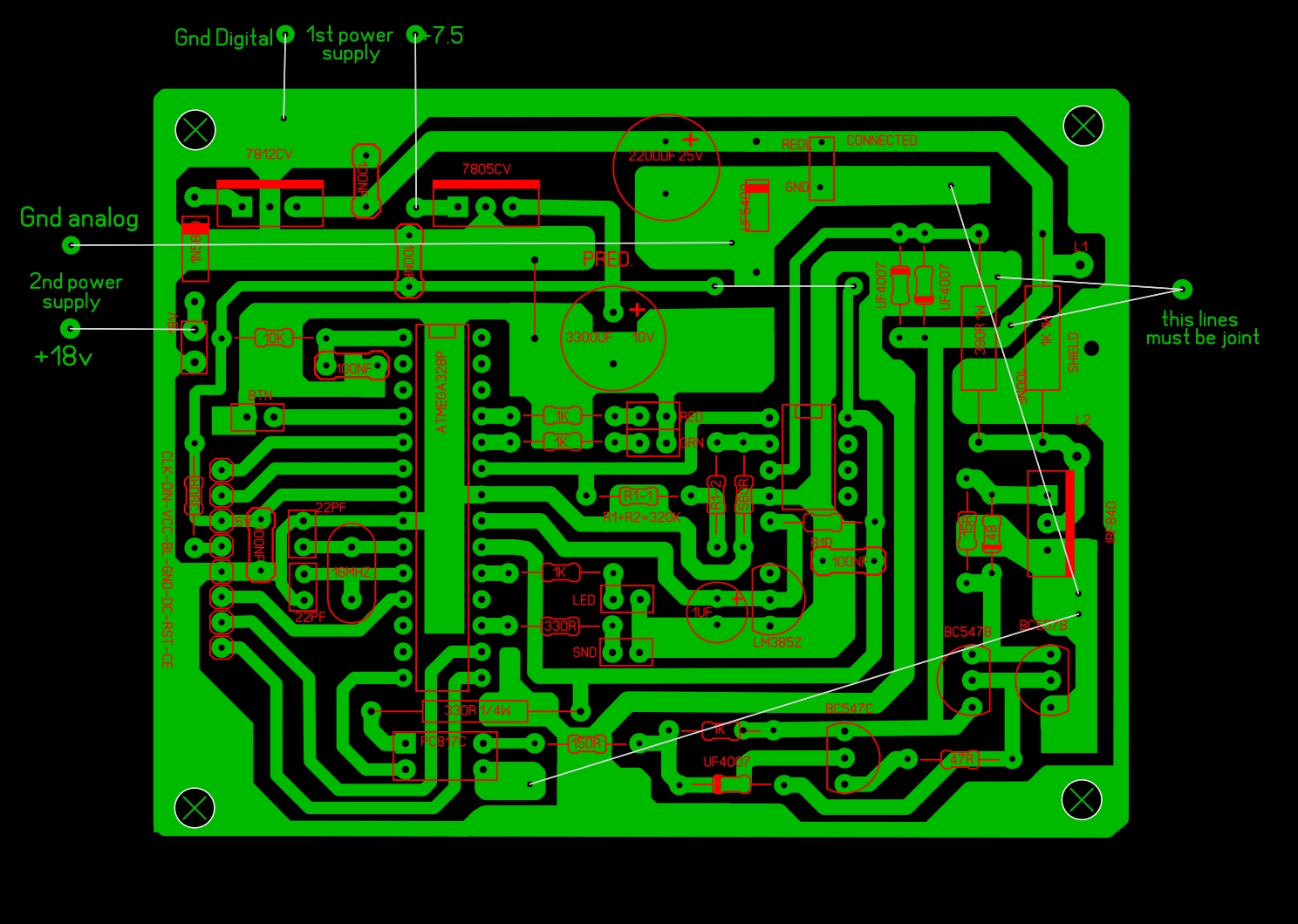

                              • At last i build this MD. It work nice but i have som trouble thr first time.
                                I read carefully in the site of foxilab and i realice that it need a double power supply. so i have to make som changes on the dising of PCB. Click image for larger version
                                Because it wont work. zero signal in the output of LM358.
                                Here adjunt a .lay file for editing... see you.FOXY MD changes to do.rar
