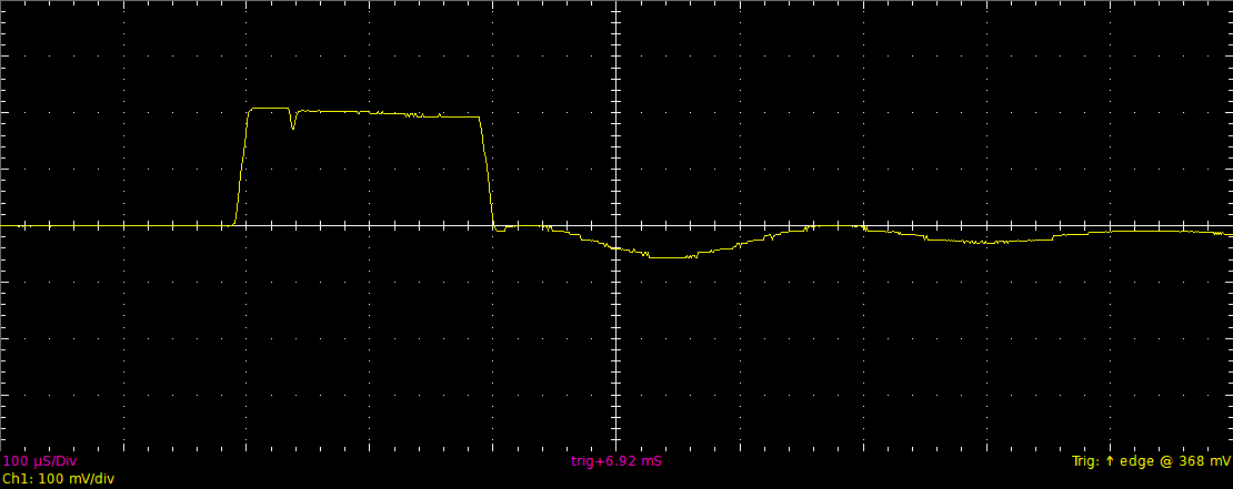

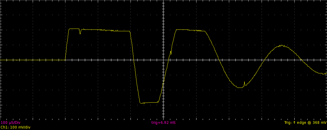

                        • yes works fine but i did add a 205 trimmer to R8 and turned the trimmer till i got a flat line on the scope
                          this is when i put a coin near it
                          this is the output from the opamp to the arduino
                          • Added Trim. Series? Parallel ? Or Replaced R8 ?
                            Looks like the output of Op Amp is ringing. That's why the Erratic indications I bet. I don't know what the Hysteresis or trigger level is on the Arduino.
                            I assume this is BreadBoard work ? Add a Integrator section with off set adjustments and I bet this thing will work quite well taming down the ring and getting the Arduino input stable.
                            Just Thinking here. Try adding like a 50pF in parallel with R8 to Integrate the signal into the Arduino. See if things tame down some.
                            • i replaced R8 with a trimmer to fine tune the gain i dont see no ringing it only changes when it detects metal ? the cap works to i used a 101 cap
                              • In your screen shot it goes from some what square wave to sign. What's that about ? Try adding the Cap. See what it does.
