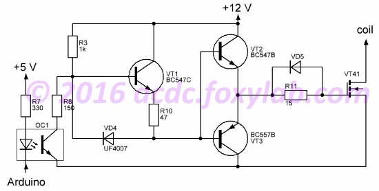

    Here's a demo - the signal output from the op-amp:
    Since the op amp gain is small for stable operation of the comparator circuit, then for clarity using large targets placed in the coil - 1 (without target), 2 (beer can), 3 (dumbbell).
    Taking the curve of exponential function, defined for fun time constant for dumbbell - 84 microseconds.
    P.S. I went back to the old version of the driver:
    This circuit is the most stable.

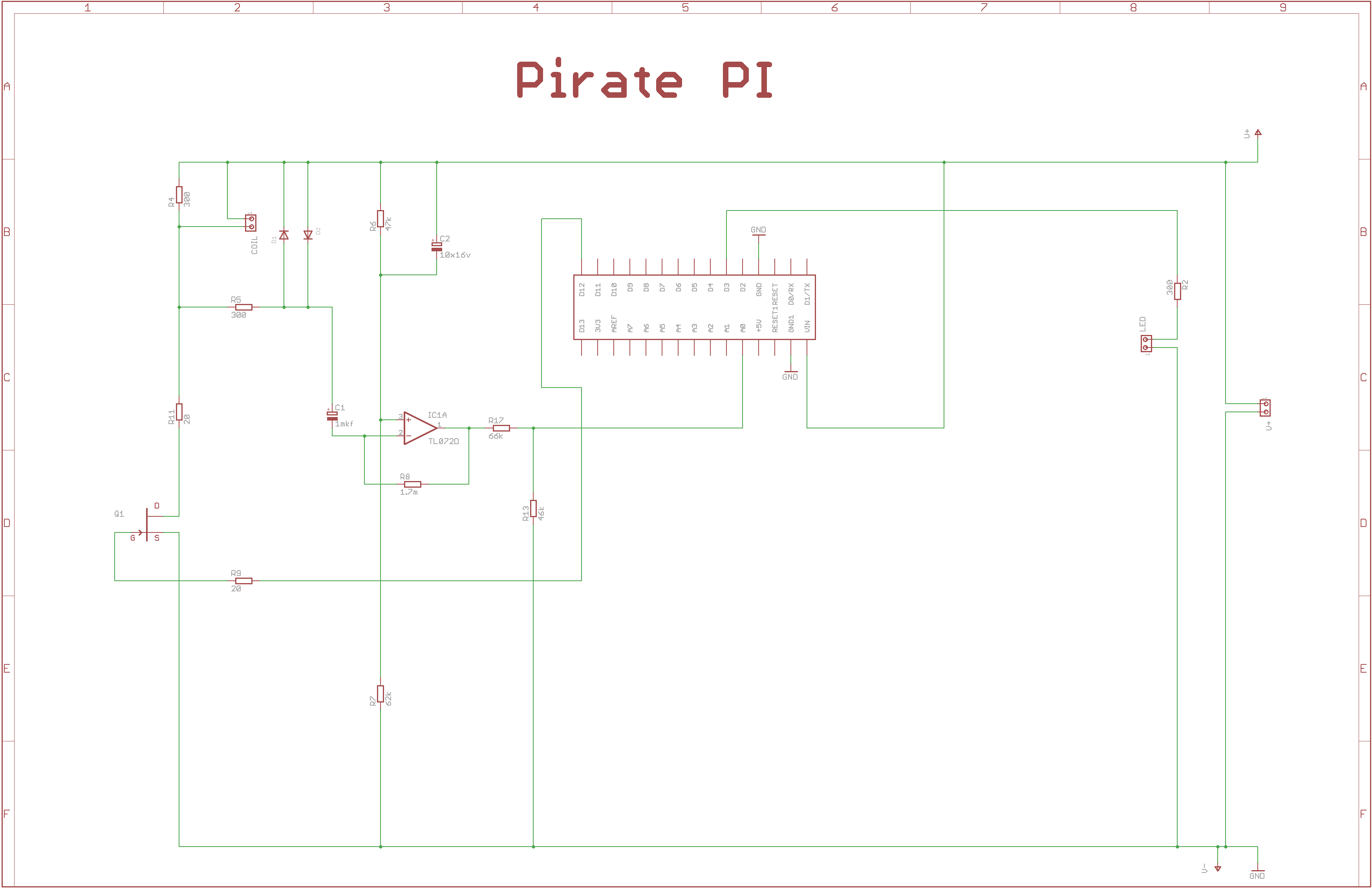

    • #77
      Attached is my old schematic for arduino shield
      • #78
        This long board is the same circuit?
        Thanks.
