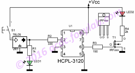

    Can you explain here all the advantages/disadvantages between the 3 versions of the mosfet driver?
    HCPL-3120 is maybe hard to obtain; so i would rather chose version 1 or version 2.
    Version 2 looks more interesting.
    • #62
      Very well done!
      Lot of useful observations on original page.
      Thanks!
      I bought a HCPL chips from this seller on eBay: http://www.ebay.ca/itm/5-PCS-HCPL-31...-/261366995287
      Driver v1 - simple circuit, but slow off the MOSFET -> low voltage peak in coil -> low sensitivity (excuse me for my bad english )
      Driver v2 - complex circuit, faster off the MOSFET (description of similar circuit in russian http://radiohlam.ru/raznoe/driver_polevikov.htm). I met the description of a similar scheme in the French engineer, but lost the link.
      Driver v3 - a simpler scheme than the Driver v2, but sensitivity similar to Driver v2.

          Nice project Foxy. I have used the HCPL-3120 before to drive mosfets and they work great. But they have one draw back. There is an under voltage lockout feature which if the battery voltage falls below 11 volts it turns off. There are different versions, some cut off at 10v some at 11v. See data sheet for "UVLO". So use 12 - 14v for your power supply as Foxy did.
              Important note. Thanks!

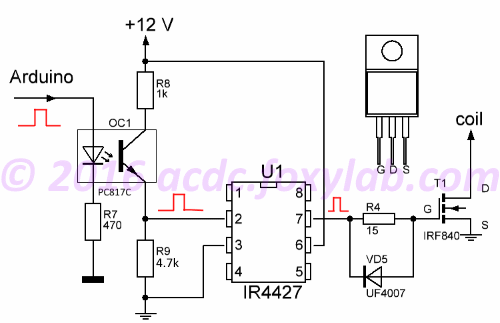

                              With IR4427 has turned a strange thing - a metal detector began to react on literally everything - my body (I'm not the Terminator)))), touching to the connectors, to the coil... I went back to version 3 with HCPL-3120.

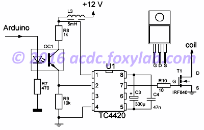

                                I solved the problem with the driver, add a filter capacitor and inductor (replaced driver IC for the best - TC4420):
                                MD works fine!
