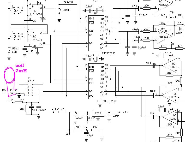

        Hi guys, I'm still trying to learn the Tayloe circuit before actually building myself a board. I I found the accompanying schematic and am currently studying the mixer/receiver end.
        simonbaker
        I'd be interested in anyone describing what "noise" problem is related to these switches and MD circuits and how one chip might be different from another.
        Are the switches simply adding a noise signal while they are switched on, acting like a noisy wire? Or amplitude modulating the signal while they are on because the resistance doesn't stay constant? Is it just semiconductor noise?
        The only reason why I can attribute that chirping noise to the integrators is because the noise was much more prominent before changing them to newer parts. The newer parts did have better "lower on-resistance, less charge-injection and better switch-to-switch matching" like Skippy mentioned. Had I not changed those old parts, I would have never attributed that noise to the integrators. Simonbaker, there are few Minelab owners who can answer your question. And unfortunately, I don't have enough experience with op amp harmonics to be one of them, sorry. However, If I had to guess it would be " amplitude modulating the signal while they are on because the resistance doesn't stay constant" or "semiconductor noise". It's definetly not noise like "noisy wire." And the noise definitely does not appear when the switches are "turned on."
        Like I mention earlier, very little noise remains now and it's not persistent. It appears only after sampling, and it is some what more audible when not ground balanced properly. Having said that, It's not normal ground balancing noise because improper ground balancing noise is different -gb noises are not "chirps" like you hear in the video. It's hard to explain. You need to be familiar with the language of the detector.
        Mick mentioned something about the coil picking up emi -I honestly don't know. I tried his suggestion of "disconnecting the front end receive wire and hooking it up to the coil ground." Although this method might be excellent at diagnosing internal noise, the source of this "chirping" noise is different. When I follow his method, I hear no chirping, just one consistent, long "wehhheeeeeeeeeeee." In other words, this makes it difficult to diagnose because the coil has to be connected as seen on the video. And when the coil is connected, because I'm testing at home, the coil picks up all kinds of additional emi as witnessed in the video. These Minelabs, as sensitive as they are, don't handle emi very well (Incidentally, I have eliminated all emi from planes flying overhead when using frequencies higher than 1.6Mhz ).
        If you hear the audio in the 3 minute length video, you only hear that "chirp" at that a particular location, which is interesting. The remainder of the 3 minutes is free of that "chirp". However, my mind is made up and I would like to completely eliminate that noise by replacing those integrators with a better circuit.

            Hi Mario,
            Ok if you did the test and the result was a steady threshold at all frequencies, except when changing operating frequency, then it is either something not right in the tx cct(but this will be noticeable all of the time when away from emi) or it is just emi. If the earth field trimmers are not set properly, then this can cause issues for some emi too. It could be that there is a strong am radio station nearby.
            Now for integrator noise. The 4066, just after it is turned on has a small amount of ringing, which could lead to some signal degradation and cause some noise if the ringing is not exactly the same every time, but this is only very low level noise, nothing like in the video. The other contribution they have is leakage.
            On resistance, I don't think is a problem in this area. Most integrators have a resistor either before or after the switch. The sd2000 has 10k resistance between the switch and opamp which sets the maximum gain of the integrator at 10. An extra couple hundred ohms is neither here nor there, as long as it remains constant.
            Better bypass caps also help reduce the ringing when an analog switch is turned on. I noticed the best improvement when a 47uf? or .47uf(can't exactly remember!) tantallum was added in parallel with the existing 100nf caps. As for an actual improvement in noise performance.... I do not know if it made the slightest difference as I was not as clued on to measuring noise as I am now. Every time I make an "improvement" I always check it by connecting the preamp to ground and measuring the noise at the end of the signal chain, before it goes to the audio both before and after.
            The lowest noise is always obtained with the preamp connected to ground and no coil connected, which tells me that most noise is from high currents flowing into the coil causing voltage variations in the analog supply and ground plane.
            Cheers Mick

                      Originally posted by mario View Post
                      Hi Skippy,
                      Is there an improved drop-in replacement for the CD4066? My searches have not been very successful.
                      After reading its datasheet, it would appear that this part is a general purpose switch that serves a dual purpose as multiplexer.
                      There's definitely room for improvement by using true multiplexers. I seriously doubt the newer Minelab models have retained the design since these 4066s are noisy when compared to a dedicated mixer solution.
                      I like your idea of using the INA132 -it does have some nice specs.

                      It's my old Minelab PI, you can find some of our findings here at geotech. Rather than overhaul the front end, I would like to eliminate the remaining internal noise.
                      At some point in the future, I would like to digitize the signal. To get a good resolution, I need the detector to be relatively quiet. Is there a proven circuit you would recommend?
                      Check out the schematic I posted with the "Flindulators" in it. As to "Where does noise come from" the simple action of "mixing" produces vast amounts of noise inherently in the process.
