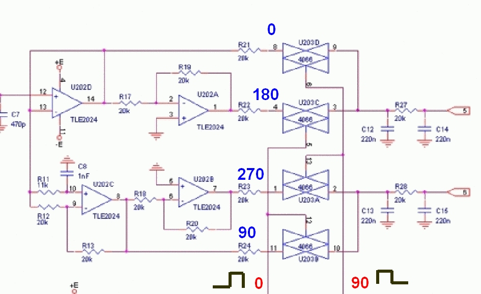

                          at the below. part of the fisher1266 schematic. it is seem tayloe mixer

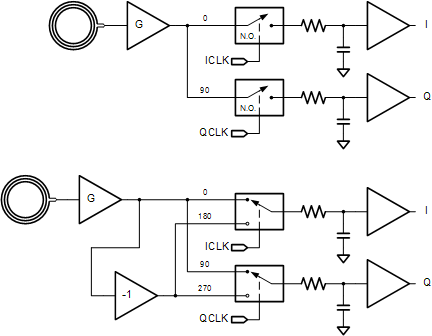

                            The first circuit below is a "half-wave" demod and is used in low-end VLFs. The second circuit is a "full-wave" demod used in better VLFs. Mathematically, it's equivalent to the Tayloe design. Even simpler, because the inverted input reduces the number of integration caps by half. This matters, because you want pretty good matching between the integration stages, and matching 2 stages is easier than matching 4 stages.

                              True, but again you do not require any amplification prior to the mixers, and as a bonus you don't have to mess with balancing the opamps prior to mixing. Double balanced action is achieved with centre tap on Rx coil.

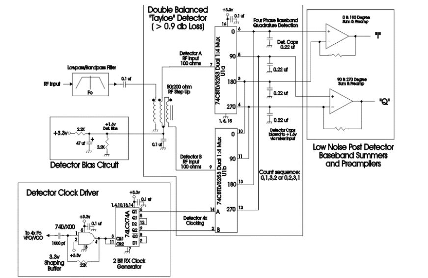

                                This is the Double Balanced tayloe from Dans paper. It combines 8 phases.
                                Dan arranges the input signals in anti phase the same as Carls drawing
                                I assume Carls drawing clocks at 4x the same as Dans
