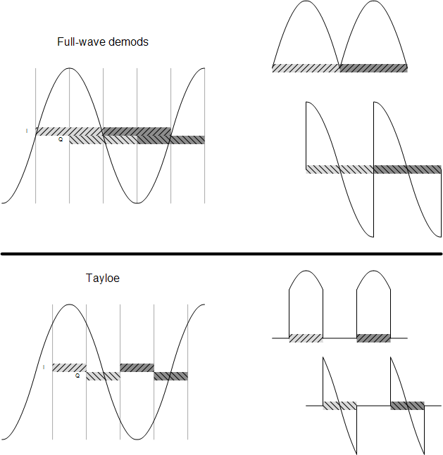

      I assume Carls drawing clocks at 4x the same as Dans
      Actually, no... VLF full-wave demods use overlapping IQ clocking, which means that the clocks run at the TX frequency, not a multiple. Drawings below illustrate clocking for full-wave vs. Tayloe, and the resulting signal gating (without integration) that they give.
      So that is a difference between traditional full-wave demod and Tayloe, although there is no reason why full-wave demods could not be clocked identically to Tayloe. It would be interesting to see if either method (overlapping vs non-overlapping clocks) has an advantage.

        The Tayloe circuit Carl compared in this example is not "full wave", so I would presume it would be at a disadvantage S/N-wise.
        To make the full-wave Tayloe it seems you need to add some complexity, one way is the "double balanced" design Golfnut attached which also added the full-wave feature as well.
        I haven't had a chance to see what is the simplest way to make a full-wave Tayloe.
        For MD work, Carl's circuit seems most direct way to get I/Q info, although generating the sync pulses requires some hidden complexity (delay circuit? How is it done typically?) if you want to use the same freq as the TX. (maybe integrate or take derivitive of I signal to get a zero-crossing at quadrature???).
        The appeal of the Tayloe circuit is it's flexibility in the way it divides the cycle into four parts which can be combined in various ways -- kind of a mathy thing... disadvantage for some MDs is inability to clock off the TX oscillator.

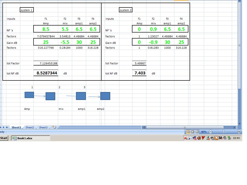

            This is good stuff, I must apologise as my limited experience of vlf dets is IGSL and that is my default benchmark.
            Potential improvements I read about are relative to IGSL.
            So I was looking at Dans work vs a simple 4066 type. The potential improvements - as yet unproven would be a little like the attached.
            This is what I was eluding to but not very clearly. In this very simple model, a lineup with a preamp versus a non preamp and sampling integrator mixer.
            What I dont know is the real NF of the IGSL preamp - anyone - so I can plug the number in..
            This model shows that having no preamp and a low loss mix can be better than an amp and a 4066 type mix.
            "So that is a difference between traditional full-wave demod and Tayloe, although there is no reason why full-wave demods could not be clocked identically to Tayloe. It would be interesting to see if either method (overlapping vs non-overlapping clocks) has an advantage."
            Dont know, cant get my head around it - Overlapping clocks,, is this like sampling twice?
            Two bites of the cherry to fill up the integrator cap with bites of signal?
            I guess all of this is like having an AtoD with 1 sample per 1/2 cycle or 2 samples per 1/2 cycle . In time we may not use a mix/det at all and sample the Return and the Tx directly and do the math in dsp.
                I think it's more like using a single sample for two separate calculations (similar to the guts of a FFT calc), because the same sample belongs to two different sums (overlapping sums).
                Direct sampling would make it very easy to reuse some samples for the different overlapping sums, and excellent way to try different ways to process the data. However, it is hard to beat the way a capacitor integrator averages out the noise.
