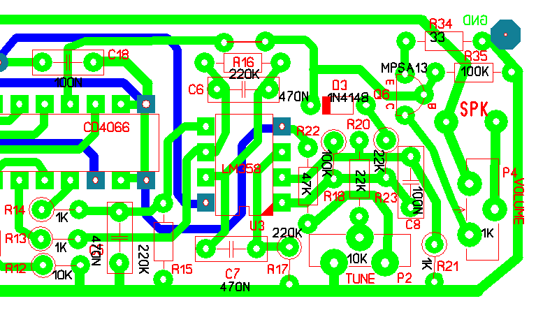

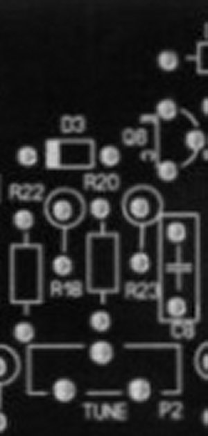

    I see you rated the sensitivity as only 2 smileys,.... I have just put a Surf P.I. (1.2) together, and found it was low sensitivity, (my first play with a MD,) on investigation, I spotted that the resistors R18 & R22 were marked wrongly on the PCB legend, when I swapped them over, I got a marked improvement in detection depth, might be worth a look see on yours.....
      I swapped resistors and made quick test without any adjusting. Now US 1 cent coin detected from 24cm (was 15cm before).

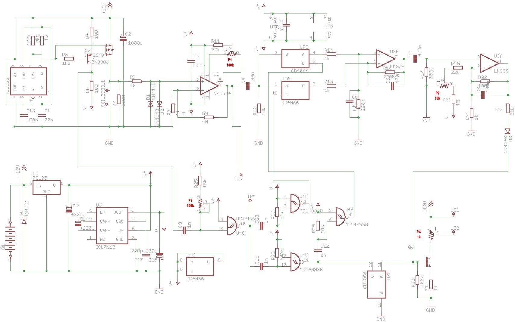

          Just buzzed the pcb you are right
          Pins 1 & 2 of u3a do go to R 18 not R22 as per the schematic
          I will change mine and see what happens

            Hiya!!!well, as above, really,... It was my first 'build', and I was disappointed with the depth detection, and made about 6 different coils, but none seemed much better than the others,I cold only detect a 2p (even a new, ferrous one!!) to about 1 1/2" to 2". I also noticed that the 'tune' pot seemed to do very little. I stuck my meter on the 'R18', looking for a negative feed to the trimmer, and 'Eureka'!! swapped em over, and now hit a 2P at 6 to 7 inches, easy. It may not make any/much difference on your boards, due to other circuit tolerences, but, as my missus says, every inch helps...

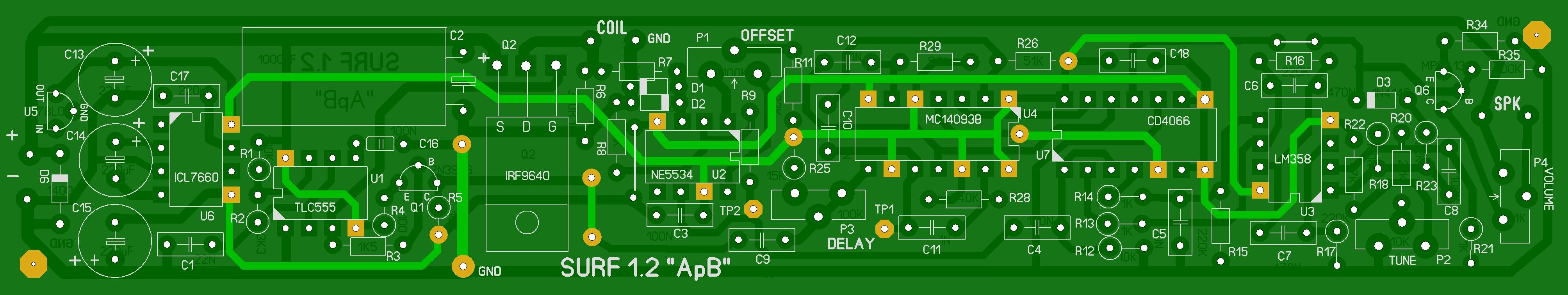

              Hello,
              Look at the sprint file, there are also the values, put in Sprint Layout all layers on, there are many parts on a small place...
              You can find the zip file with the sprint file at http://www.geotech1.com/forums/showthread.php?t=13810&page=2 post # 45
              If you find errors let us know..

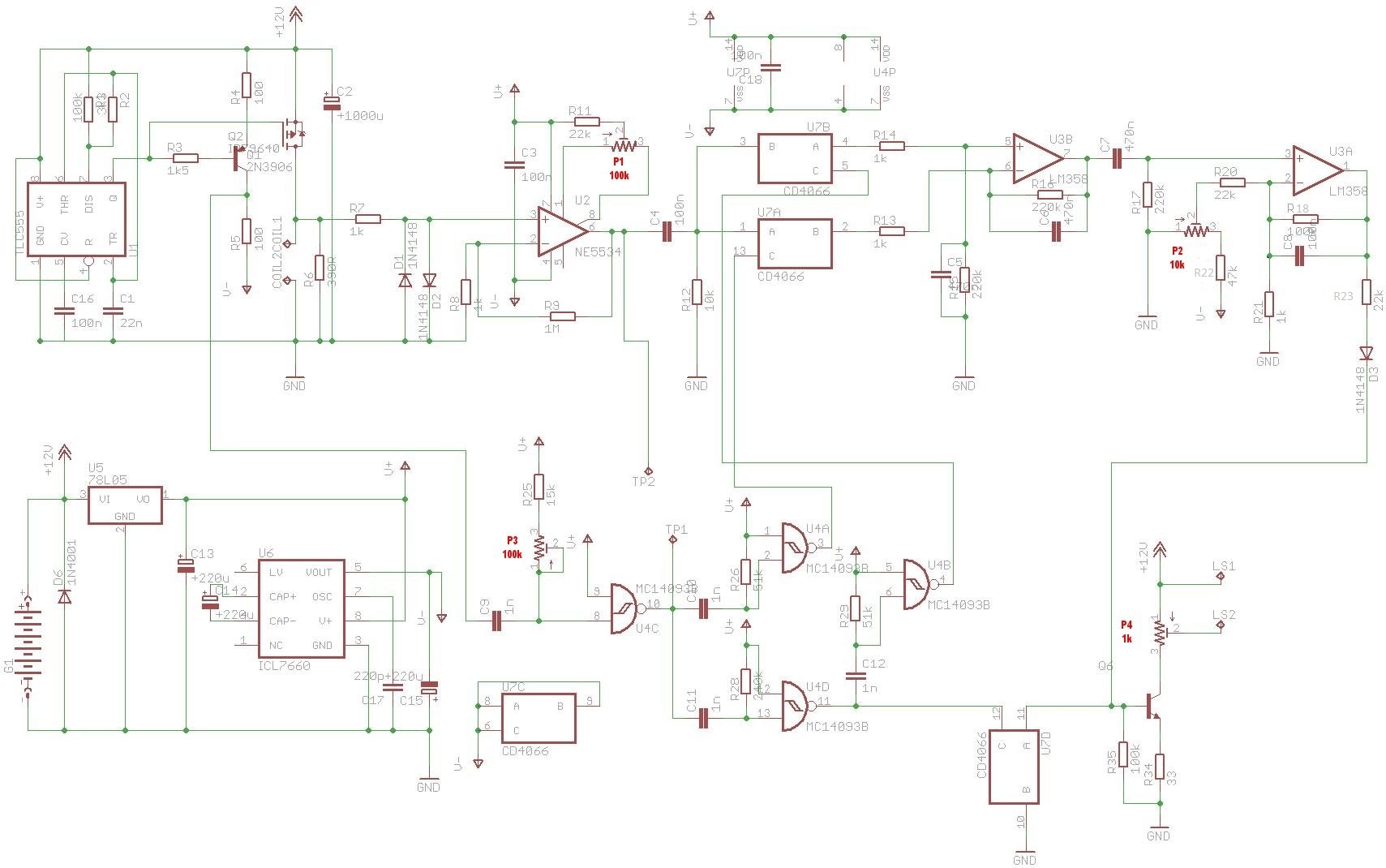

                mmm, seems there is some discrepancy here, probably from different versions over time
                Attached are the pcb and schematic I have
                I think we all agree the board is ok, the silkscreen has part numbers so if we can agree on the required schematic changes, i will amend and update the copy on my shop that most people seem to use with this kit
                well spotted though - it only took 1 year for someone to notice

                  Yep, the circuit schematic is correct, as is the pcb etch,... its just the resistor labelling on the board,.. I'm afraid I was working from just a parts list, and the pcb, so I put the two resistors in the wrong place......

                    ok, I've updated the schematic and partslist in my shop to swop R18, R23
                    Silverdog
                      Hi silverdog. I think you are supposed to replace R18 with R22 and not the R23. It is obtained following: R18=100K and R22=47K.
                        I knew that
                        Somewhere between reading and sriting my brain changed 22-23
                        Corrected now

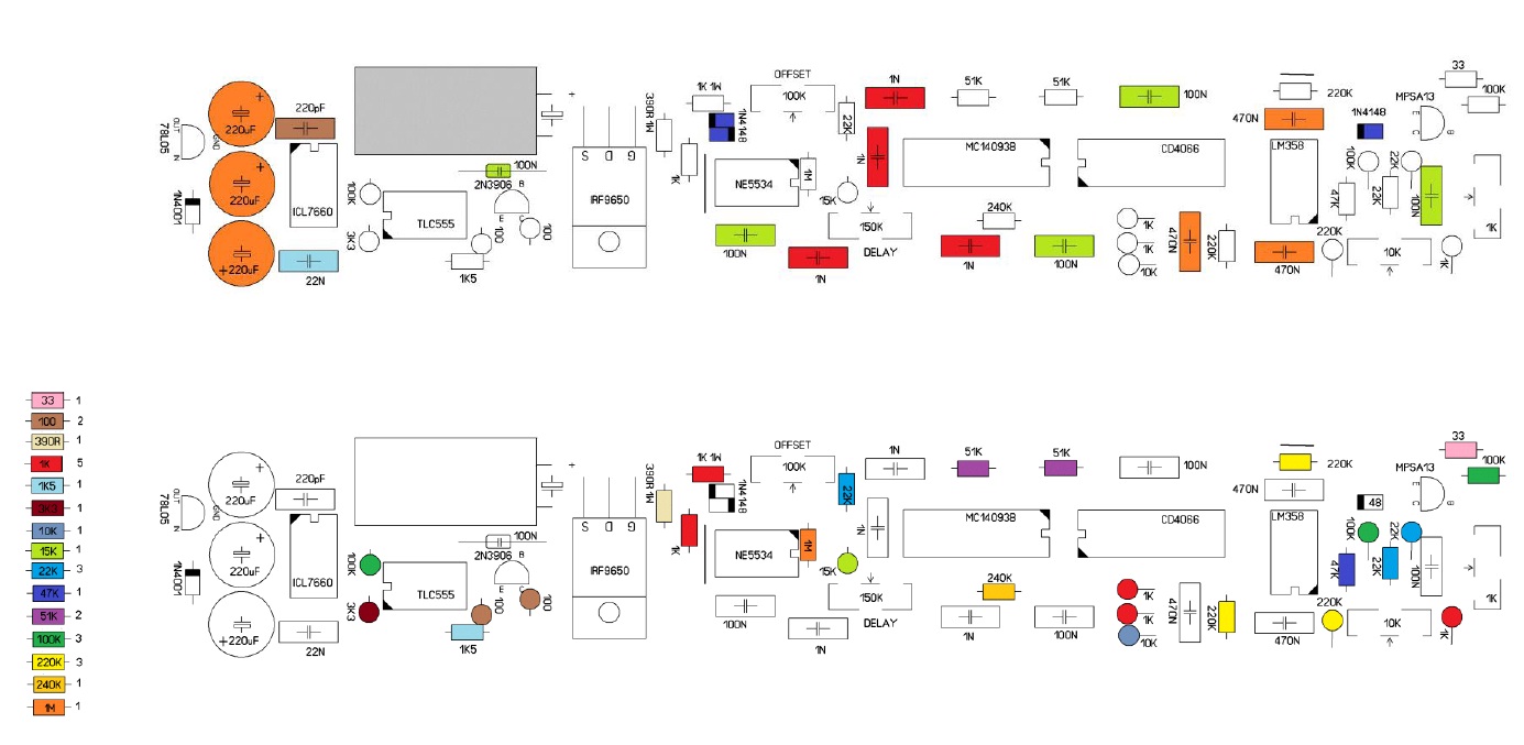

                          Hello Friends,
                          Made a jpg that can be helpfull..? if somebody spots a mistake.. (hope not) well tell it then...
                          Best regards.
