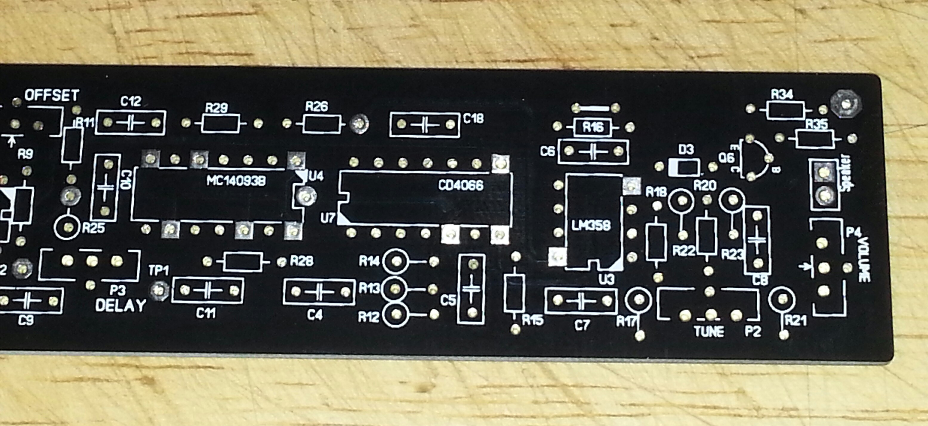

        Surf 1.2 set and pcb
        I am new to MD and this forum so please go carefully with me.
        As I have only just bought the kit I am sure the screen printing for R18 and R22 are correct.
        I bought (may 2012) the surf 1.2 kit from Silverdog and I have built it. I made a coil and every thing seems to work but this was from trial and error just twidling the knobs untill I got some noise from it which seemed to correspond with a metal object being waved over the coil.
        Is there a correct way of adjusting the "offset" and "delay" with the P2 "tune" pot?
        I have a 'scope if this would help.
        Just need a little guidence in the right direction. Thank you.
          some good scope pictures for adjusting the surf in this thread
          adjust offset to give 0v on TP2

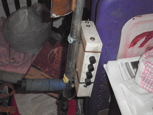

              Was so pleased with the TGSL that I built 2 of them, if built to a good spec you get 6/7" on a pre 1937 silver sixpence in typical UK field using a 8" factory coil, the stem lwr plastic, middle using crutch,upper aerial pole, arm cup varnished cable drum inner suport, housing styreen bits glued together, as you can see its been hammered,goes in the van most days, made some nice finds with it.
              Very much a turn on and go machine.
              Everythings a 4 for this one , If its discrimination your after they dont come any better.
              Second build was housed in a hard drive case, looks really nice and works well, which is just as well because everything is cramned in such a small place incl the 8 rechargable cells.
                Looks like the newer Silverdog Surf Pi kits have fixed the PCB labelling between R18 and R22. The kit I have shows R22 now where R18 was originally and so on.
                Useful to read the whole thread above to find this out however as I would have gone and switched them if it wasn't for the PCB jpg's above.
