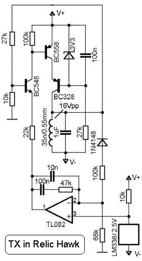

The TX circuit (oscillator) discussed above in this thread has very serious shortcomings. They are described in other thread:
http://www.geotech1.com/forums/showp...&postcount=612
Here is a circuit diagram of TX which operates much better
