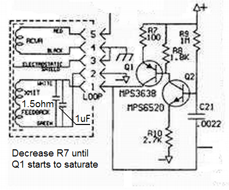

      Your oscillator circuits are not correct designed. Here is the original correct designed circuit:
        Mike what coil is that in your circuit drawing? And is the 1.5 ohm "sticky note' you added on the tx the bucking coil, combined TX coil or something else?
          Most old coils of White's have equivalent capacitance of TX tank circuit 1uF (two or three capacitors in parallel) and equivalent resistance 1.5 ohm. This is the resistance of series connection of main TX coil and the bucking TX coil. According White's terminology, the bucking coil is named "feedback" winding. I have no information for new coils of White's.

                    Here is an explanation how self-bias of circuit diagram in post #32 works:
                    The attached image is equivalent curcuit diagram for calculation of timeconstants.
                    The emitter junction of Q2 operates as a diode charging C21 with showed below polarity. The voltage is proportional to amplitude of oscillation. The charging timeconstant is more than R10 x C21. It is increased because the resistance of resistor R10 appears increased about 100 times (parameter Hfe of Q2). The discharging timeconstant is R9 x C21 ie 1M x 2.2n = 2.2ms.
                    ATTENTION: The circuit can not operate correct with increased supply voltage, because the emitter junction of Q2 is as Zener diode. When the amplitude of oscillation exceedes its breakdown voltage, the self-bias can not stabilize amplitude of oscillation.

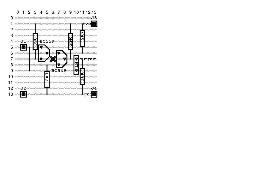

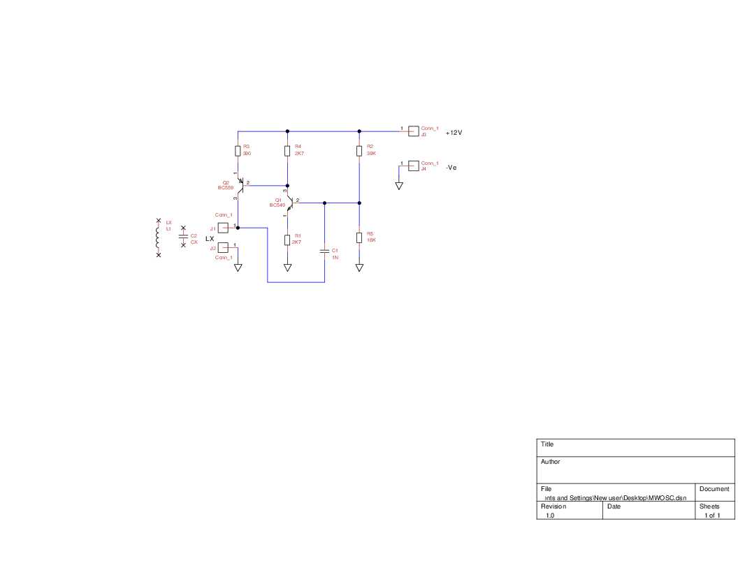

                                Re - take on oscillator
                                HI.
                                I have been doing a little experimenting looking for a oscillator for setting up coils.
                                I built circuit from Russian site it is posted in coils section.
                                I could not get it to work.
                                I have just finished this oscillator from this post on veroboard and it works well.
                                Checked TX coil +- 1.43mH C= 100nf F= +- 13.3 kHz.
                                RX coil +- 17.38mH C= 6.6nF 28 ohms F= +- 14.6 kHz.
                                An additional coil I had lying around
                                +- 6mH C= 10nF F=16kHz.
                                It works well with these coils which represent a fair spread ( even with 6 volt supply).
                                Also very simple layout.
                                Best Regards
