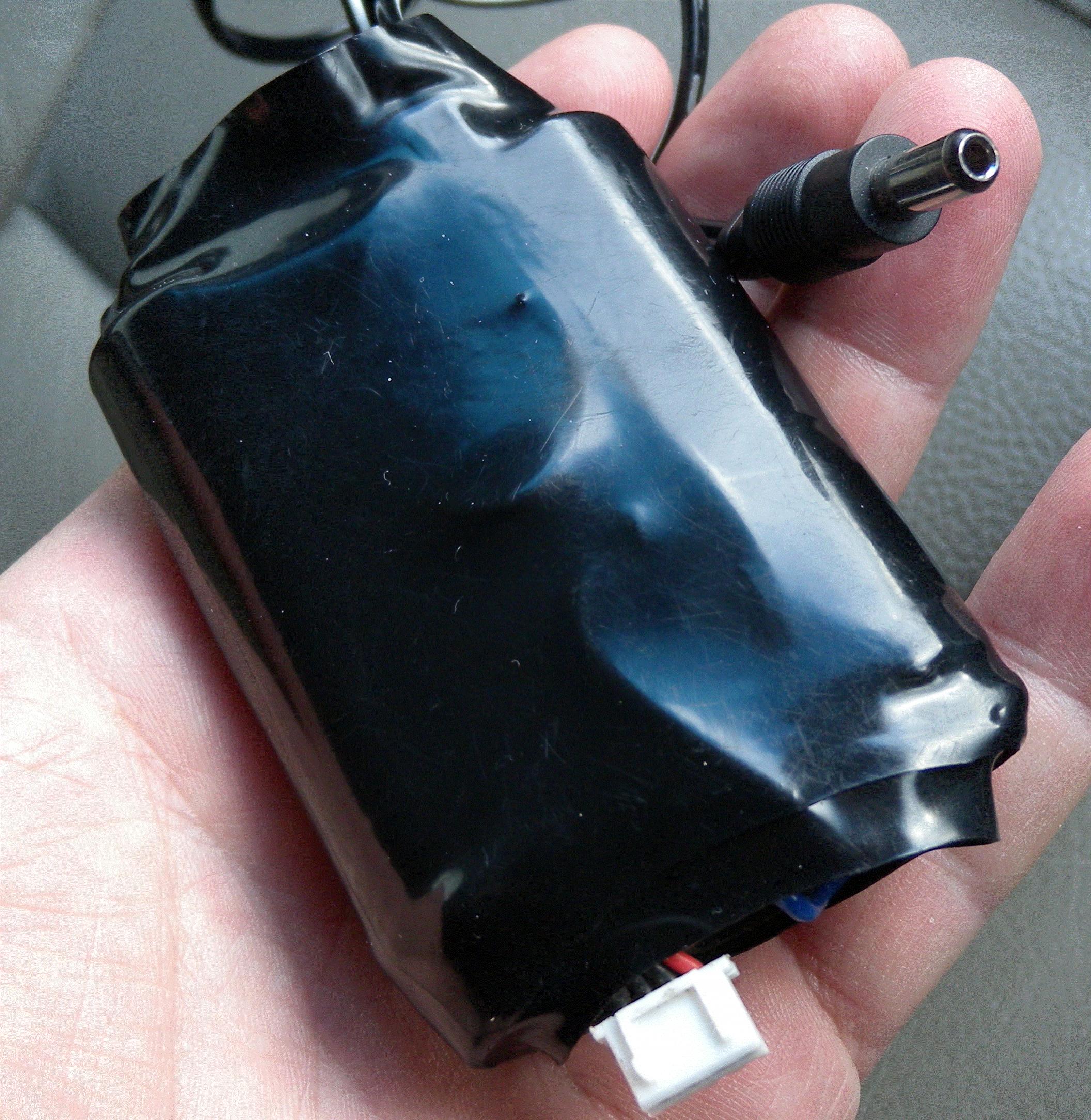

                          I use remote battery in pocket,,,, 3 cells cut from a dead laptop battey - 0 pence solution, 1.8AH 12v
                          The beast oscillator would run for 4 hours on this type of scrap battery. ~350mA RMS say 450 with losses. 1800/450 = 4Hrs Ive normally had enough after two !
                          Charge is by the 3way and gnd plug (20pence - from Giant Cod)
                          Mini charger too from Giant Cod £5
