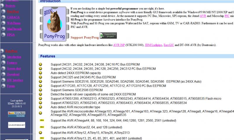

          Oops......... think Pony prog can not work with USB programmers...sorry 6666 ...
          I use the http://www.pollin.de/shop/dt/MTY5OTg...1_Bausatz.html
            I have used pony prog on a ATMega16 and its a little quirky and a bit hammy.

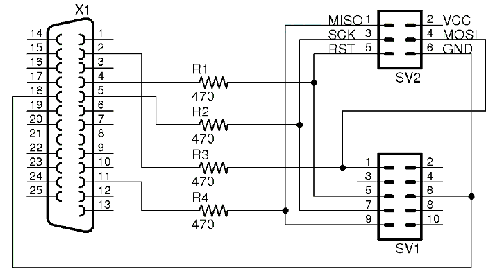

                        This is what works for me, to burn a ATtiny25, from my desktop PC.
                        see other post for results of testing
                        Simple parallel port burner called Bascom also known as Dontronics DT006
                        works for me with a cable one metre long.

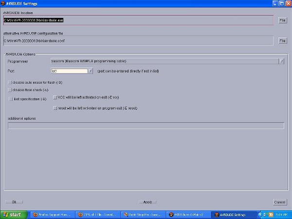

                        Two pieces of Software are needed
                        AVR Burn-o-matt, (this is great)
                        this is a GUI for Averdude which is a horrible command line program,
                        but the AVR Burn-o-matt makes it easy to use.
                        You also need to install WINAVR, this contains the Averdude program, (and other stuff)
                        NOTE: In AVR Burn-o-mat, you must select the correct directory that WINAVR is in
                        so it can find Avrdude
                        and also select the port.
                        Load your hex , burn it
                        alter your fuses, burn them
                        you will see a text report
