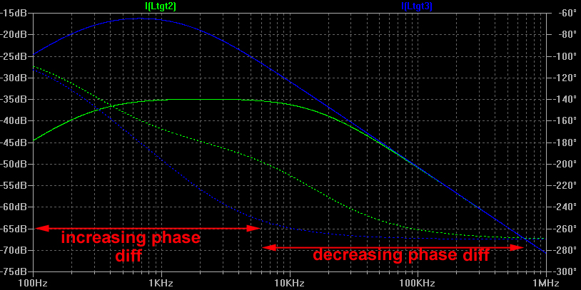

            I don't understand comment that increasing TX would decrease phase difference between targets. I would think its the opposite. Can someone explain?

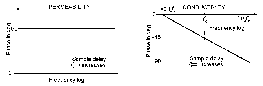

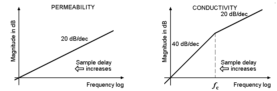

                    Simon, the attached diagrams show what happens when we increase TX frequency. The diagrams are valid for soils and for targets.
                      I guess it depends on how you model the target.
                      Using the simple "coil and resistor" target model that the PI boys use in their simulations, an AC analysis seems to indicate that the phase difference between targets typically increases with frequency over a range, then decreases with frequency. So it does both!
                      Attached is the simulation. Maybe I'm not doing the right sim, or maybe its not true to life. But interesting. I'm still not clear why the phase difference gets smaller with really high frequencies; need to dig into the sim.
                      Cheers,
                      -SB
                        Cheers,
                        -SB
                        P.S. I guess on thinking about it, there is only so much phase shift a simple first order circuit (inductor-resistor or capacitor-resistor) can do, so they eventually converge to the same maximum value.

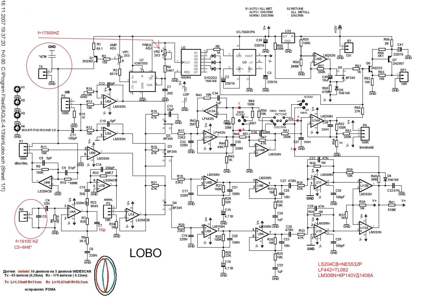

                          I've been thinking about increasing the frequency for prospecting also, but I thought I'd try decreasing the inductance of the coils by half. That would increase the resonant frequencies by a factor of 2.
                          I suspect I'd need to use a slightly smaller gauge wire to satisfy other circuit parameters.
                          I need to build my circuit yet, but was wondering if anyone else has experimented with alternate inductance values and what circuit mods may've been required.
                          Kev.
                            No,no,no!
                            F is proportional to 1/(square root(LC)), it's even discussed earlier in this very thread!
                              No,no,no!
                              If I plug in a 3mH inductor into this formula using the standard TGSL tank caps, I get 20.5kHz, admittedly not a factor of 2 but more like 1.5
                              What do you get Skippy?
                              From what I recall, in a Colpitts osc => c = (C1.C2)/(C1+C2) no?
