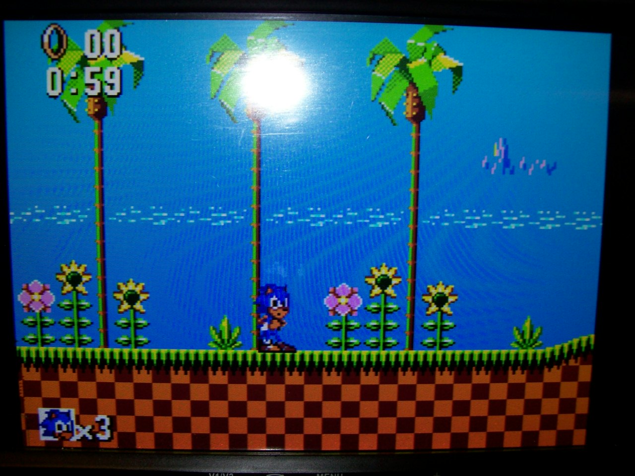

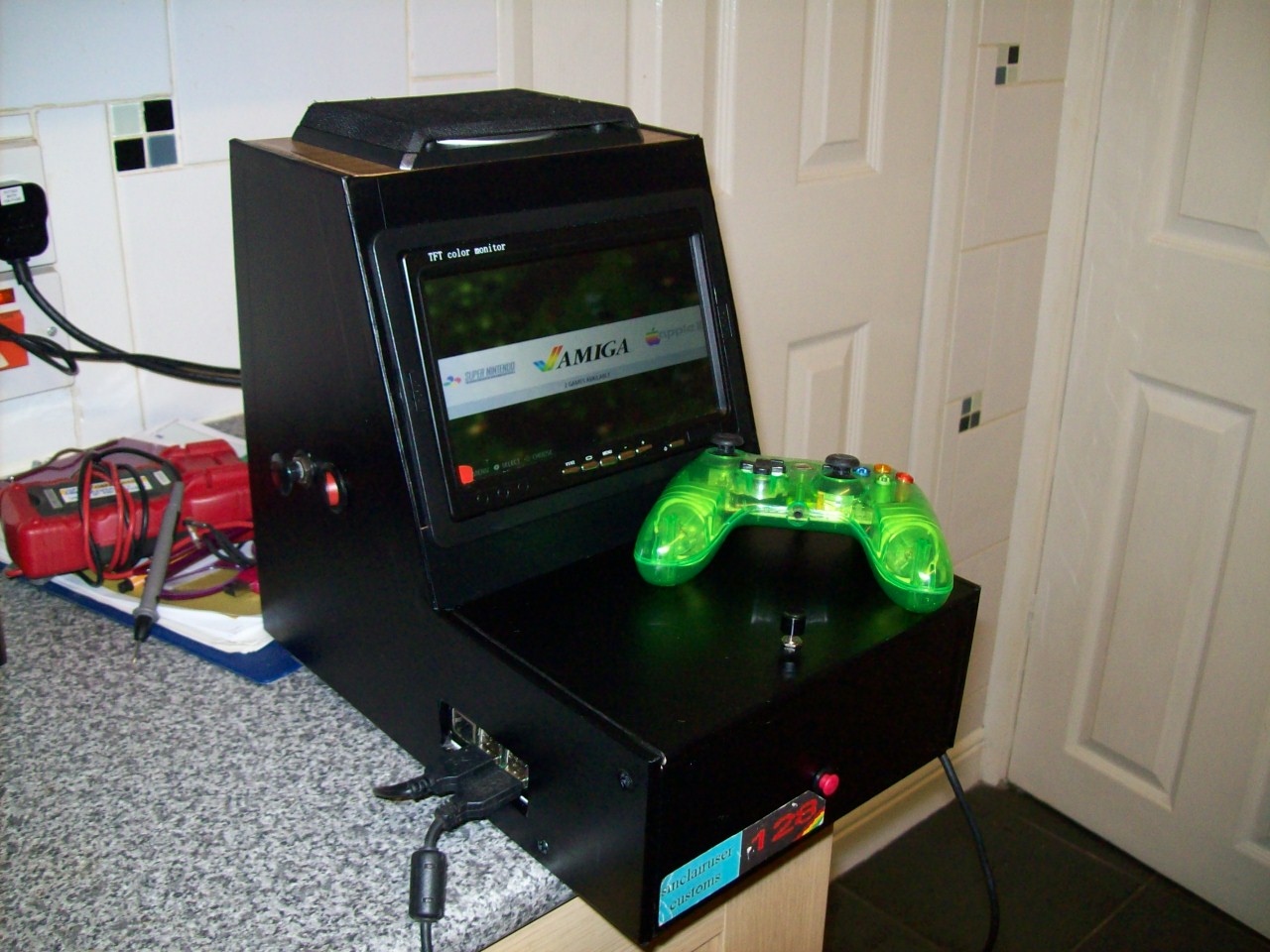

                                this is what the raspi excels at, not running a metal detector Click image for larger version
