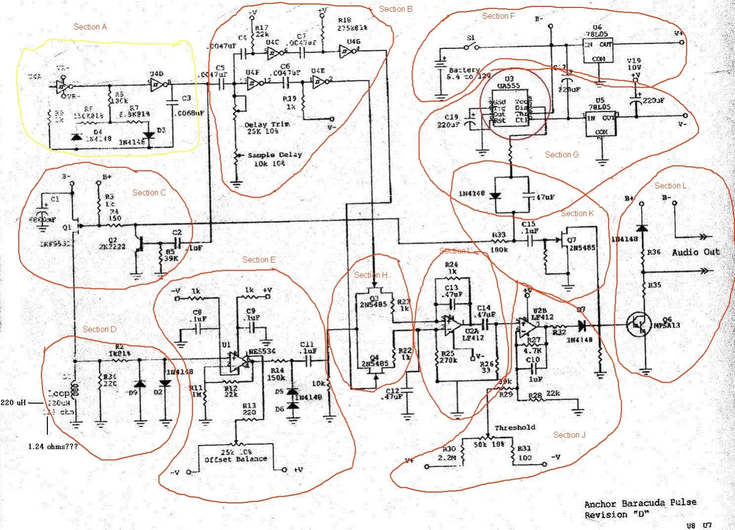

                          PI related questions
                          Ok. I have been looking at the Barracuda schematic. I am trying to wrap my head around how it works, but I'm a bit rusty on my analog. I want to run this by you guys here on the forum, to see if I'm on the right track.
                          As to the schematics. It looks like the two schematics are fairly close with the exception of some components. The basic layout is the same. From what I understand, this is also how most analog PI circuits look.
                          In the upper left hand corner, marked Section A. This is a clock circuit correct? Does this clock circuit operate at 10Khz? I can check this, but I'd like to check for sure what it's supposed to be.
                          This clock circuit drives 2 sections. These are sections B and C.
                          Section C is the Mosfet Drive circuit, which drives L1 at the clock rate. The base of Q1 is driven by the NPN transistor Q2, which in turn is driven by the clock from section A.

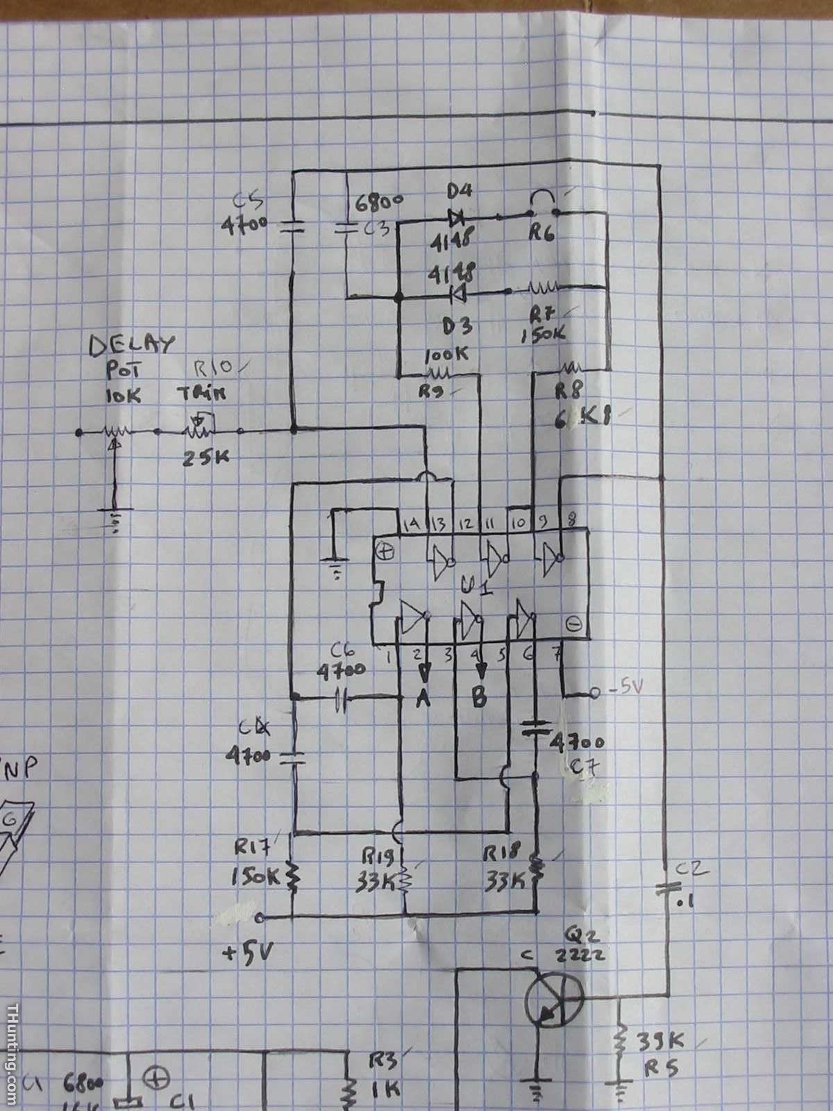

                          Section B is a delay circuit. How does this delay circuit work? I see 2 sections. There are 2 delay signals coming off this section, how do they drive the matched FET pairs going into the input of Section H? They both invert twice, meaning no inversion, but each cap stage introduces a phase delay, correct? The only difference between the two sections is one is referenced to +, the other is referenced to -.
                          Section D is the coil itself, with a delay resistor that the voltage from the echo is generated off. The current through the coil is something like 5.8A. This is based on an Rds of 0.3ohm for the IRF9530, and the coil resistance of 1.24ohms. That energy stored in the coil will generate something like 1300v. On the 220 ohm version, its 1300volt, on the 330 ohm version its like 1900volt. Has anyone actually measured these spikes?
                          In section D, that voltage is clamped to about +0.6 to 0.7V to -0.6 to -0.7V by the 2 1N4148s. Does this mean the weak reflected signal will be in that range? I'm assuming yes due to the 1000X gain op amp in the next section.
                          Section G simply provides the +/- negative reference off the single supply.
                          This clamped -0.6V to +0.6V signal then goes into the NE5534 op amp, which has a gain of 1000, that can have the offset adjusted. Do the 2 series 1N4148 diodes clamp to zero anything below -1.4V?
                          Here where it gets a bit confusing for me. There are 2 delay signals coming off the delay circuit in Section B. If the only difference between the two sections is one is referenced to +, the other is referenced to -, does this allow either a positive or negative signal from Section E to enter the op amp input into Section I?
                          What function does Section L serve? Is it simply a gain stage, buffer, or comparator circuit?
                          Section J, I assume is a comparator circuit, due to the threshold adjustment. The output from this drive the audio circuit in Section L.
                          Section K. Does it keep the audio circuit off during the on pulse to the coil?
                          I want to do some of this circuit in software. I can generate the clock from software with no problems. The clamping circuit in Section D. Is any information lost from this clamping action? I realize this clamp is necessary to prevent damage to U1. However U1 is a gain stage of 1000, which I'm sure amplifiies noise along with the weak signal. I would like to try something different. If I simply put a voltage divider on the 330 ohm resistor, I can measure the full signal without any loss of information. The only downside to this is the signal will now be miniscule in relation to the spike information. With a 24bit signal of +/- 8.4 million counts or so, I should be able to sample the low end signal. What percentage of the full spike (1300V-1800V) is the full signal. Is it in the +/- 0.7V range? That would theoretically give me a signal in the 0-10000 count range. Does this seem valid? By doing so, I can basically just ignore everything above 12000 counts or so (clip off the unwanted feedback), and basically have a nice, noise free signal.
                          I can then do some further analysis. My question is this. Assuming everything I have mentioned is valid, what information could I expect to clean from this clean signal? Would it have different characteristics for different metals? I realize that PI technology doesn;t allow discrimination, but is this more due to the analog circuitry limitation, or is there actually usable information available in that signal?

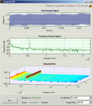

                          I would like to take that clean signal, and actually display a sample of that on a scope display. I could, of course, take a couple hundred samples and average them as well to come up with a sort of VDI equivalent, but I also want to present that waveform for both a raw visual display, and perhaps use that waveform for a comparative analysis of other waveforms.
                          Any thoughts on this, or am I totally barking up the wrong tree in the wrong forest?
                          Hopefully someone will tell me something, anything.

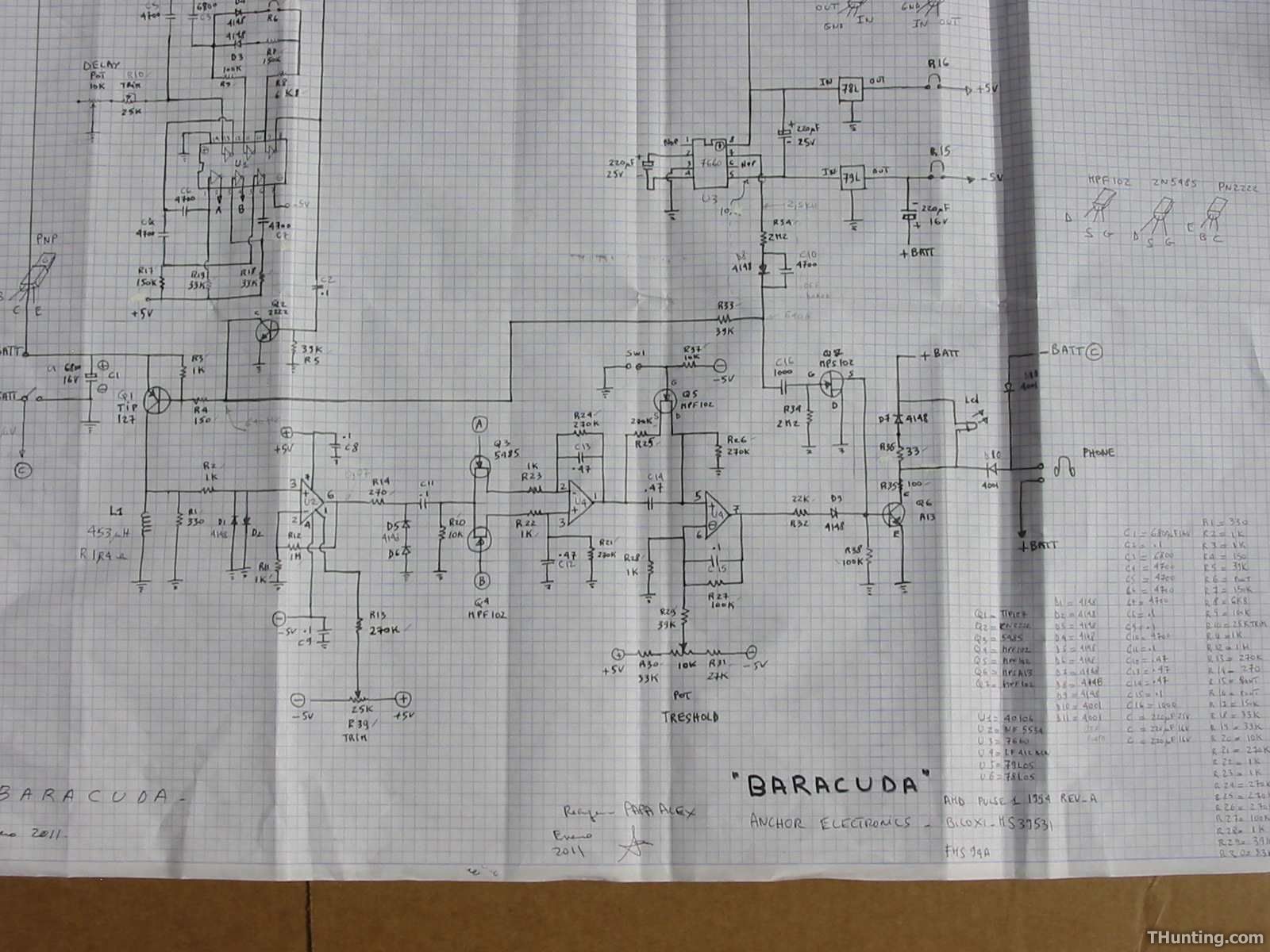

                          • #58
                            Fix thats the wrong cct, no time for me right now but somebody should post up the correct cct for you, or search the barra thread for PAPA Alex cct, cheers
                            I am so late gotta run
                            • #59

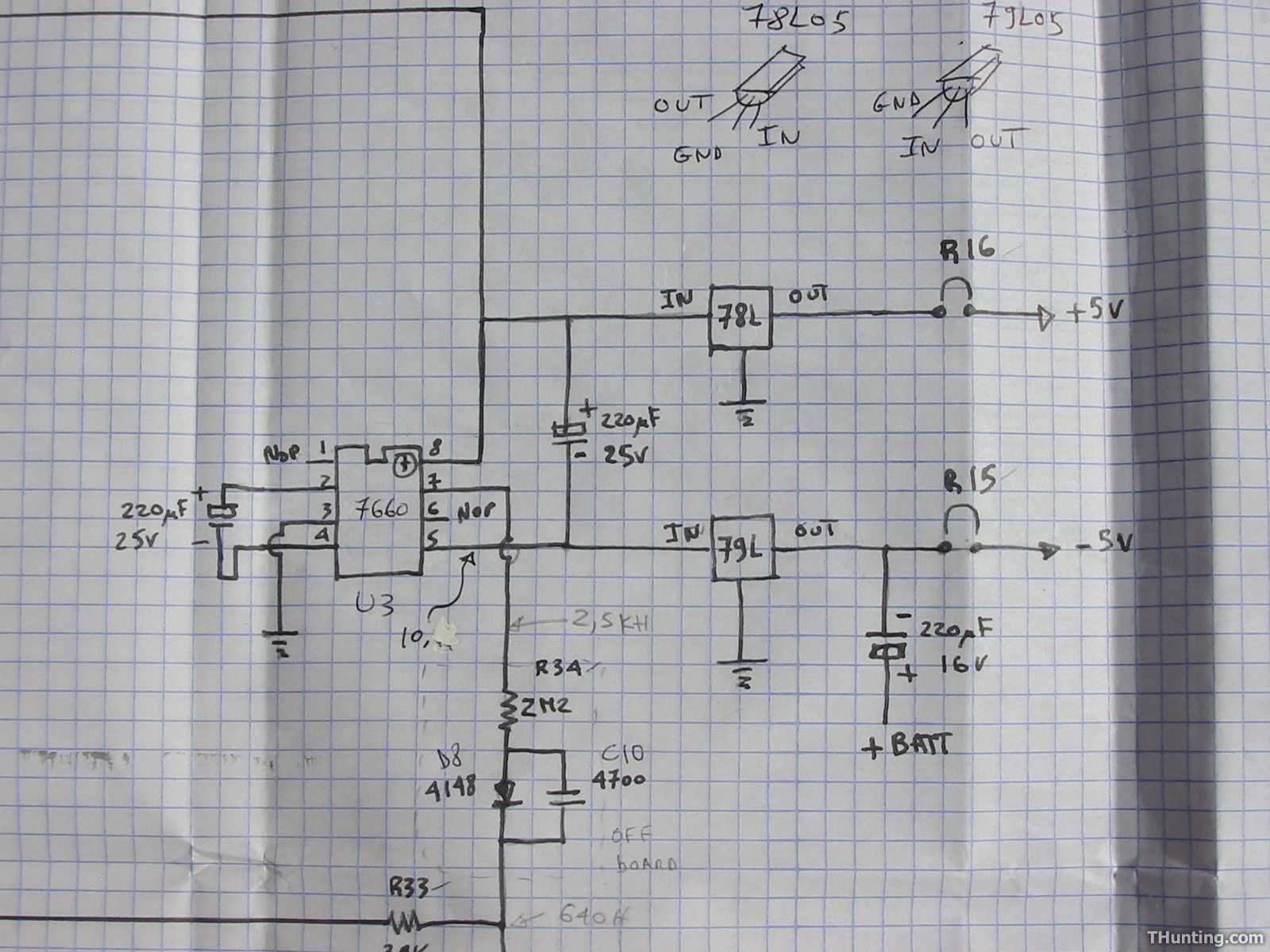

                              Thanks for the schematics. I had seen those, but I assumed they were an earlier version. Has anyone done a CAD version, with the same component IDs and circuit? All the CAD drawings I saw don't match up to that or Silverdog's PCB. I'm guessing that's why the component IDs were left off the PCB - too many schematics floating around with different IDs.
                              Anyways. I'm gonna hold off on getting too deep into the PI circuit for now on this thread. I will start a new thread specifically going over my questions so that it doesn't clutter this one up, which I just want to be the build details.

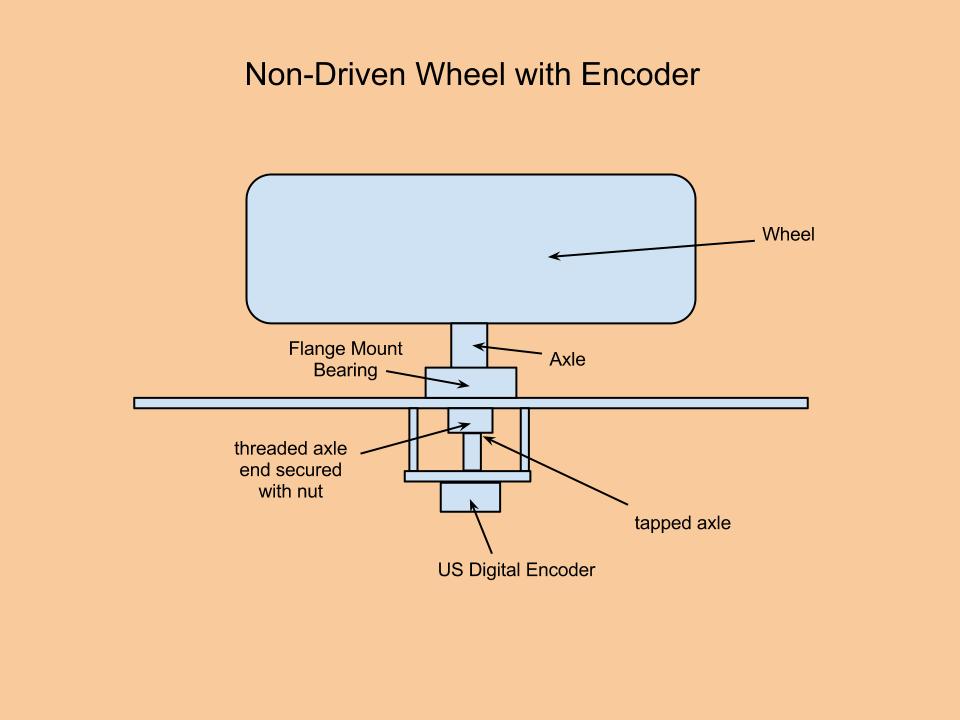

                                As to wheels, I've firmed up some conceptual ideas on the non-driven wheels for the encoder feedback. It looks pretty doable, and I ordered the wheels for it today. Need to order the other parts like the flanged bearing blocks and encoders.
