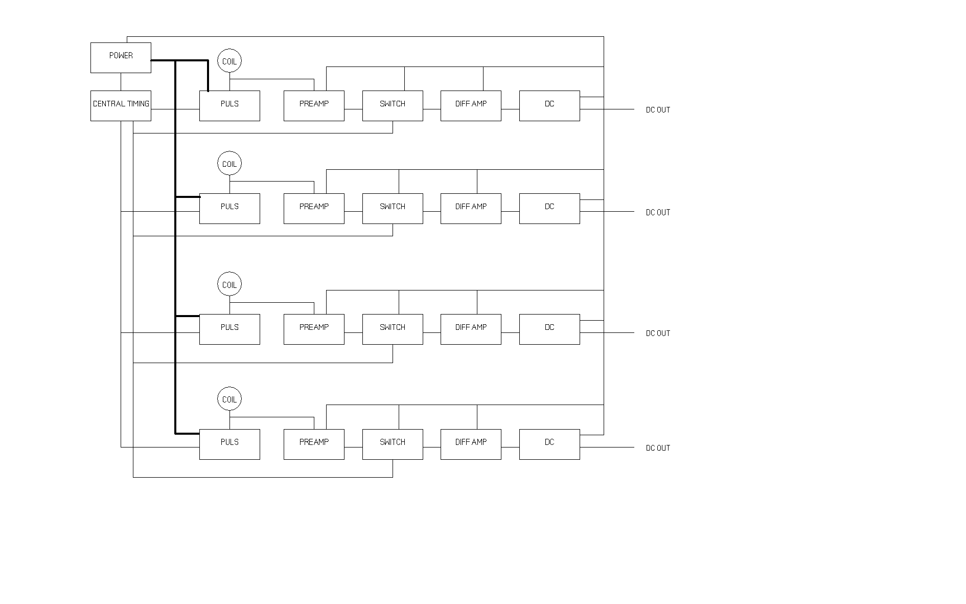

For nuggets you need a 'fast coil' look at http://www.geotech1.com/forums/showthread.php?t=16322 think the "coax" coil is a good coil to use with the baracuda also read the pdf from BBsailor.
To use more coils look at the jpg.... do not now if it will work..

Wow, that was a great response. That is really good info for me. I really like the fact that it would allow me to use the Baracuda with the spiral coax coil. Since I'm sweeping in very small increments, this should be an excellent way to pick up the small gold.
At this point, I just might be tempted to do a rev to the Baracuda, and add the ability to remote control everything from my control system, or be able to use a Prop Quickstart board for the onboard processing.
If I added remote delay and threshold adjustment, I could throw in some nice improvements, such as terminal headers for everything. I could also incorporate some of the various mod circuits folks have introduced as well, and incorporate them into a single board. Make the board able to handle 4 coils maybe.
Any suggestions on the best mod circuits and improvements to the Baracuda?

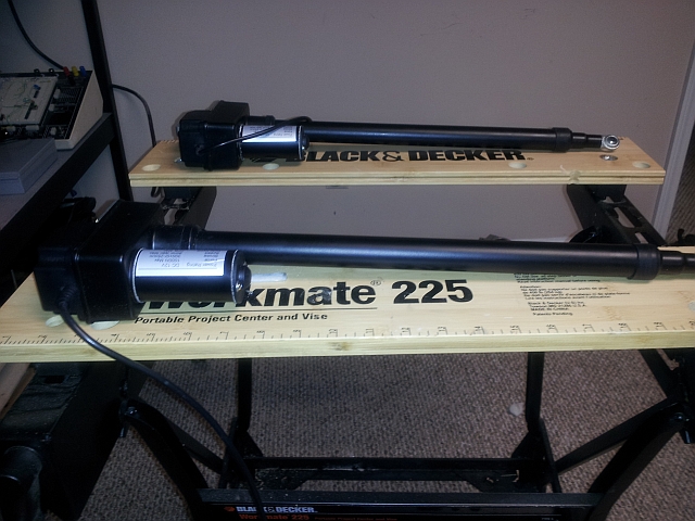

more parts have arrived

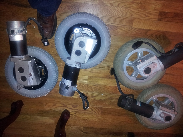

Well. I got in my motors and linear actuators today. Man those motors are freaking HUGE. The ebay pix didn't do them justice. 13.5" x 3" tires. Motor looks like a car starter. Weight about 30+lbs each. That will put the weight from the wheels and motors alone at almost 150lbs. I powered the brakes, and ran the motors, and they ran pretty good. Not bad for $50. I've got servos the size of my thumb that cost more than that.
Powered up the linear actuators also. They worked well, power is 12V though. I'll run those from my smaller motor controllers.

Heres some pix on the motors and actuators. Note my foot for scale. Thats a 13 shoe...
