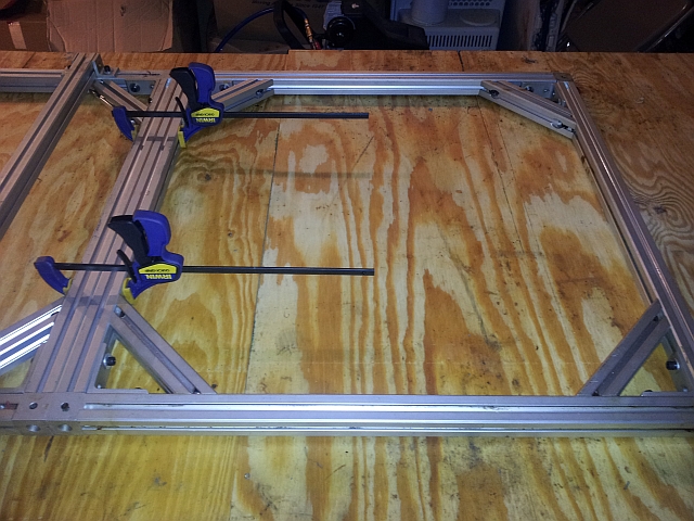

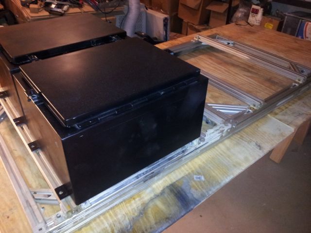

    chassis updates

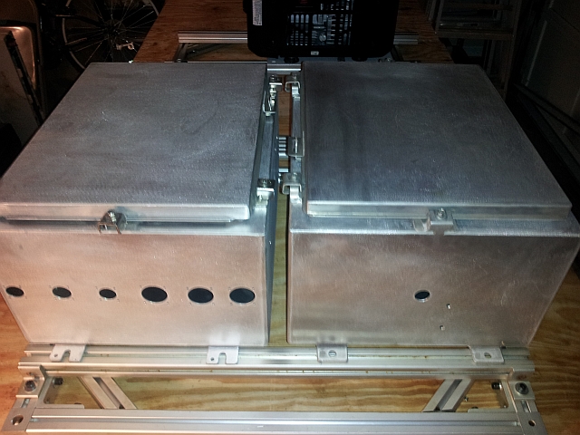

    Well, I made a lot of progress over the past week on the Rover. I have gotten most of the chassis complete. I have stripped out and cleaned up the old enclosures I'm going to use. I still have a couple pieces to add to the chassis and seal up and paint the enclosures.
    I also started work on the Propeller sensor boards. First section is working fine, which is the SHT11 temperature/humidity sensor. I'll add the other sensors this weekend to complete that board.
    Still working on some ideas for the coils. I haven't started on the jib crane yet, so I'm still trying to decide how I want the coils to look. I've been considering a coil array also of some sort. Has there been any work using a large transmit coil, and a bunch of smaller receive coils with individual receiver circuits set up for different windows? I'm really not wanting a large moving arm on this if I can figure out a good way for the coils. Maybe a dual large coil array with a large coil on each side of the rover out from the side... Any thoughts on that?
    I still want to build a custom detector of some sort. Any ideas or suggestions is appreciated. I will be trying out a blanket coil as well. I'm still looking for a nice non-metallic grass seeder or similar assembly I can hack to make that. If anyone has seen something that would work for that, please send a link or something. I'd also be willing to buy a blanket coil from someone if they have made one that works. I'm willing to make one, but making one will have to wait till late, and I want to make sure I have one ready due to time constraints.
    Another thing. I'd be more than willing to test anyone's detector design and coil design on this system. Once it's running, it might be helpful to quantify detector performance on a common platform.
    Anyways, here are some recent pictures on the build.

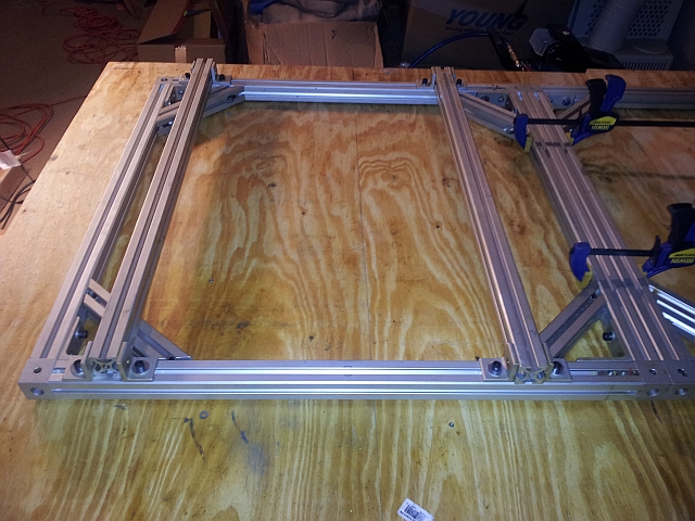

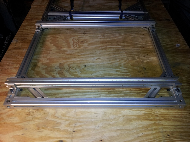

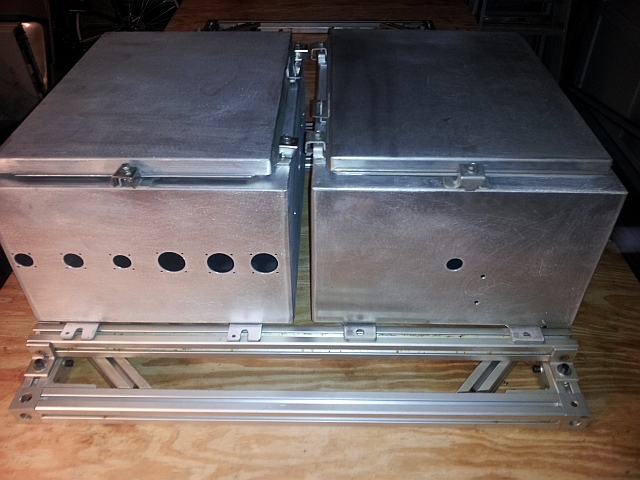

          updates

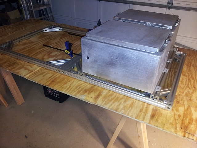

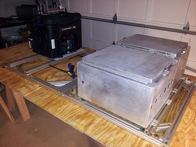

          Hello all,
          Here is a new pic of the chassis and controls/amplifier enclosures. Doesn't look like much but it was a solid weekend of work getting that knocked out.
          Next steps are wheel mount brackets, knocking out fan/inlet holes in enclosures, and starting on the coil sweep arm.
          • #95

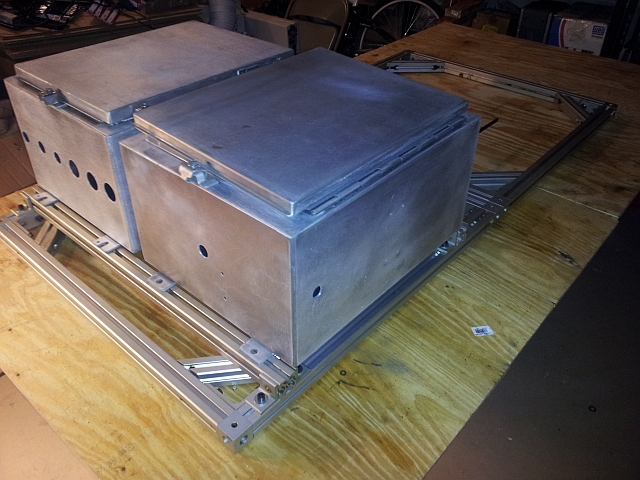

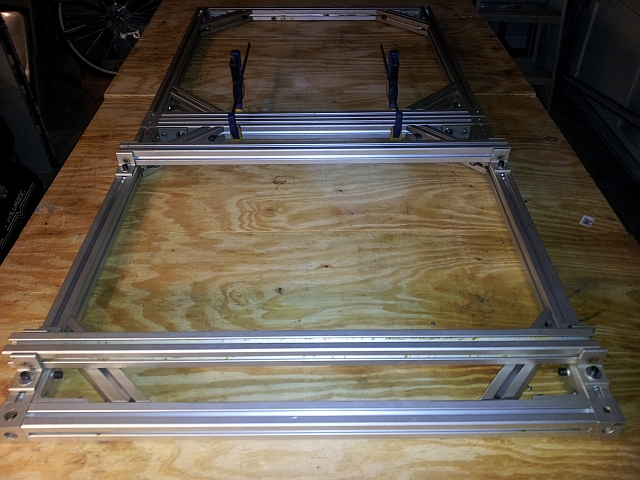

            new updates

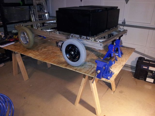

            Here is another picture of the rover in progress. Right now the wheels are mounted, the chassis is almost complete. Only 1 more piece to mount and the chassis will be finished (other than cleanup or painting).
            After that, the generator will be mounted next, along with the batteries, and all of the electronics parts inside the enclosures.

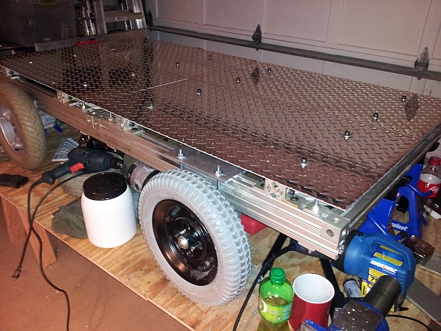

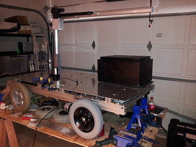

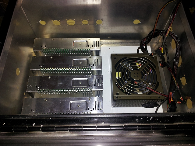

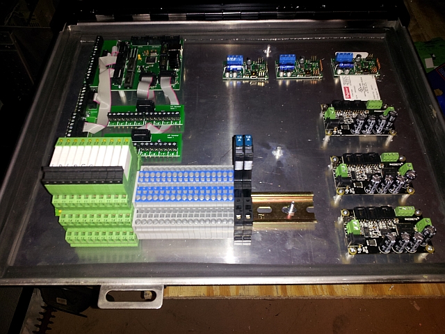

                    More updates to rover
                    I added some more hardware to the rover. Here are some pictures of the progress..

                    • Awesome work!
                      This is looking awesome man! Such professional work!
                      Can't wait for the next update! Be sure and keep us posted...
                      Jon
                      • Yes very impressive Fixstuff. This thing is gonna last longer than my personal vehicle!
                        Considering this is a beach rover, have you thought about how you'll keep the wind blown sand and salt out of that box? I noticed some pretty big venting holes. there is some pretty cool open cell foam around that can help but sand gets into absolutely everything.
                        It never ceases to amaze me how it does that
                        I bookmarked your blog BTW
                        Edit: Come to think of it. That is a pretty big metal box which means it's also a pretty big heat sink...

                            • @der_fisherman: I've got brakes on all the motors (except one ), Looking at how big this thing is, I originally intended to keep the brake energized all the time (disengaged), but now I'm thinking when it's not actually moving, I will turn the brake off (hard stop). I also will have the brakes tied to the ESTOP circuit. If I lose comms or hit the ESTOP button, it will shut off power to the motors instantly. Also, all of the motor drive boards have shorting brake functionality which I will use also.
                              @Qiaozhi: If you notice the arm I have so far, its an aluminum tube. To finish it, I will mount a wooden dowel or PVC tube into the aluminum tube, secure it, and have the coil also on a wooden or PVC dowel down to the ground. I will have an adjustment at the insertion point for the dowel into the tube, and I will have it extend WAY out from the rover so I don't pick up a metal signature. I'm hoping about 3 or 4 ft will be enough. During scanning, I will have all motors off, with the exception of the arm rotation motor, and the arm extension motor only on during indexes. So hopefully, motor noise will be vastly minimized. I will try scanning with the rover moving just to try it, but if I do that I will swap out to a huge square coil, say 5ft or wider, and not sweep with it, just operate in a fixed position.
                              @Farside: All the holes are now plugged. Any holes I add now will be IP67 water splash resistant. I am going to "try" to see how warm it gets with the box closed up and no ventilation. The base of the box will be bolted down flush to the treadplate, and should provide a pretty good heatsink. Each power supply has a fan mounted on it, so the air inside the box should be stirred up quite a bit. I've run enclosures like that before, and they do get hot, but I'll have to see. I might even plumb up the box with a self-contained water cooler system. I'll have temp monitoring on both boxes to make sure I don't fry anything also.
                              @All: Thanks for all the positive feedback! I'm trying to build it to last, I'm sure the workmanship could be better, but man it's hard to build in metal on this scale.
                              • With the sweep arm, you will basically need the coil as close to the ground as possible
                                has the arm got any "give" in it, as the rover bounces along the uneven and pot holed beach
                                you have the possibility of the coil hitting the ground and bending / damaging the arm.
