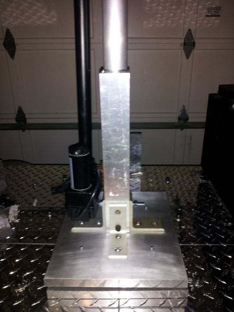

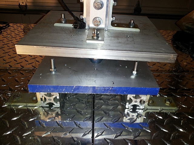

    • Detector arm assembly work
      Hi folks,
      Worked on my detector arm this weekend. Below is the final picture of the rotation base I made for the arm. It doesn't look like much, but it pretty much occupied most of my Sunday. There is more info and pictures on the base parts on my blog if anyone is interested.

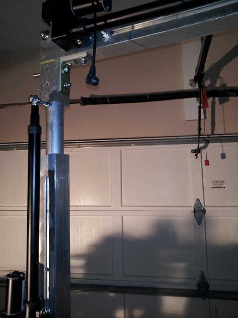

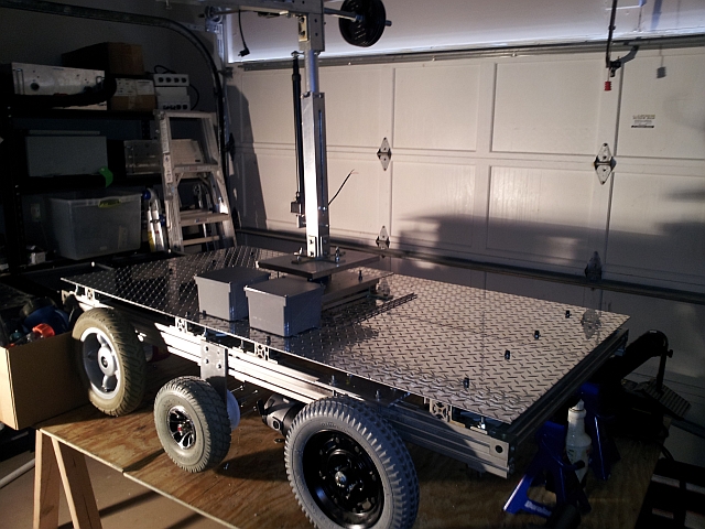

      • new memorial weekend work
        Hi all,
        I made some good progress this weekend on the rover. I redid the arm, redid the rotation, and mounted the non-driven, dead reckoning encoder wheels. I also did some metal detecting testing of the sweep arm. It looks very promising. I have more info on the blog here:
        http://fixstuff-thots.blogspot.com/
        Here also are some links for the video I took of the testing.
        http://youtu.be/lhHwaLNyYWM
        http://youtu.be/ahc5_83dn40
        http://youtu.be/6guV0vBTPLs
        http://youtu.be/jUmfdfXMpiA
        I've also attached some pictures.
