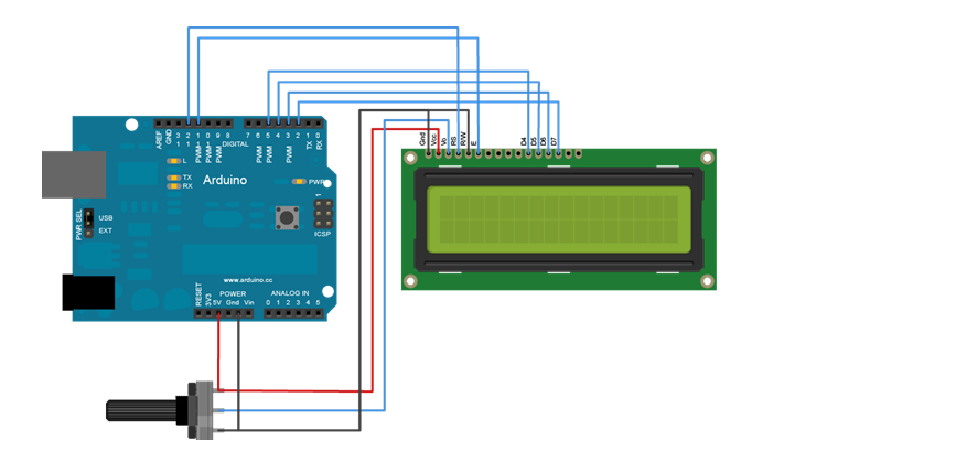

    Without too much trouble I wrote an Arduino based program for an VDI module.
    I had originally posted this under the IDX section but maybe deserves a thread of it's own since it should be able to run on a variety of detectors. I just happen to be using the an IDX kit, minus his VDI module from Silverdog for this experiment.
    I struggled with this for a few days until I got the accuracy down but now works perfectly! Problems I ran into were determining how long to sample each channel and inconsistent calculations using floating point numbers.
    I used an Arduino UNO, just because it's the most popular. Documentation for the Arduino is excellent, so even a hobby guy like be could figure it out. Basically the program monitors the last stage of the GB and DISC channels, takes 50 samples of the ratio between the GB and DISC channels when both are triggered , throws out any bad numbers, averages them and displays a number that is porportional between 0 and 100.

    Below are the hardware details. Besides the Arduino UNO, all that is needed is and LCD displays that is compatible with the Hitachi HD44780 driver. I just used a standard 2 X 16 LCD backlight.
    For the IDX:
    Pin A0 - > All metal (U3 Pin 1)
    pin A2 - > Disc Channel (U3 Pin 14)
    Ground - > Ground
    +5V power source.
    That's it!!
    Don
            For the IDX:
            Ground - > Ground
            +5V power source.
            That's it!!
            Don
            Attached is the complete .ino file.
            Also, spotted a small error above-
            Pin A0 - > All metal (U3 PIN 1)
            Pin A1 - > All metal (U3 Pin 14)
            Ground - >Ground
            +5v power source.
            Don

                              Hi Steve,
                              I'm using the IDX Kit from Andy (Silverdog). I experimented a bit with the TGSL and the channels seem much too noisy.
                              There are multiple ways that you can tie the Arduino into the IDX circuit, but mine is connected to pins 3 and 5 of U4. The only drawback is that the VDI numbers will change when adjusting the DISC. I just set my DISC and leave it anyway..
                              You are not measuring any phase directly, but the DISC and GB channels will have amplitude and timing differences. By plotting them on a graph with X & Y components, you can create a phase relationship.. all to easy to see if you plot X against Y on your scope :
                              http://www.youtube.com/watch?v=m9DuMekVwic
                              Then, just set a trigger and measure the slope of the line that you see on the scope. You CAN translate that into an angle using the ARCTAN function and I think that's what others are doing. I'm still having trouble getting the ARCTAN to work with the Arduino. I think I might have to download another math library.
