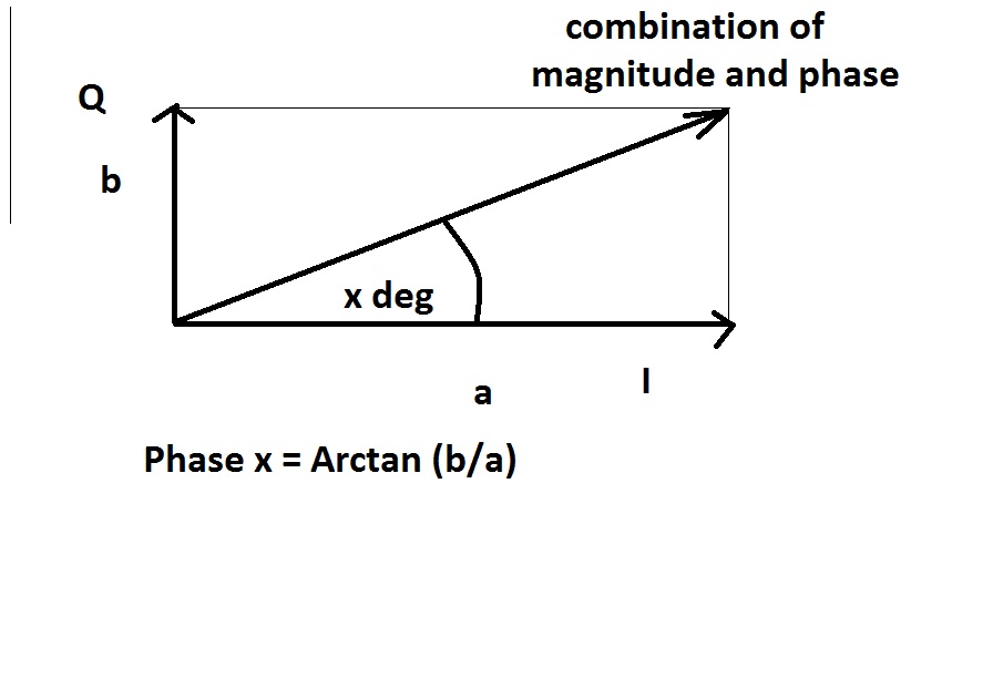

    You CAN translate that into an angle using the ARCTAN function and I think that's what others are doing
    Yes I also think Tan-1 is what is used.
    I THINK most Rx have quadrature L.O. so the Rx outputs are in quadrature this gets the genuine phase angle x degrees = Tan-1 (b/a) to give the phase of target.
    Targets like pure Silver have a response way over to RHS so you get a long a vector and a relatively short b vector
    . b .
    . . x degrees )
    a
    You see here that alloys worth digging always have a shorter b vector to boost resolution/accuracy you may scale up the b vector (maybe not necassary)?

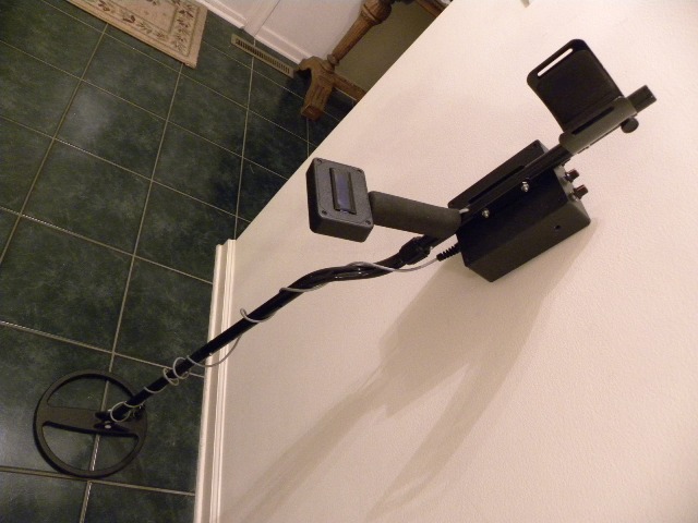

                            Latest Arduino code for VDI module
                            I actually finished my IDX + Arduino UNO project. Below is the link for what the code in the previous post actually does. Neat thing is, you can program it to ID anything you want if you know the VDI range.
                            http://youtu.be/5j_XM0L0BKg
