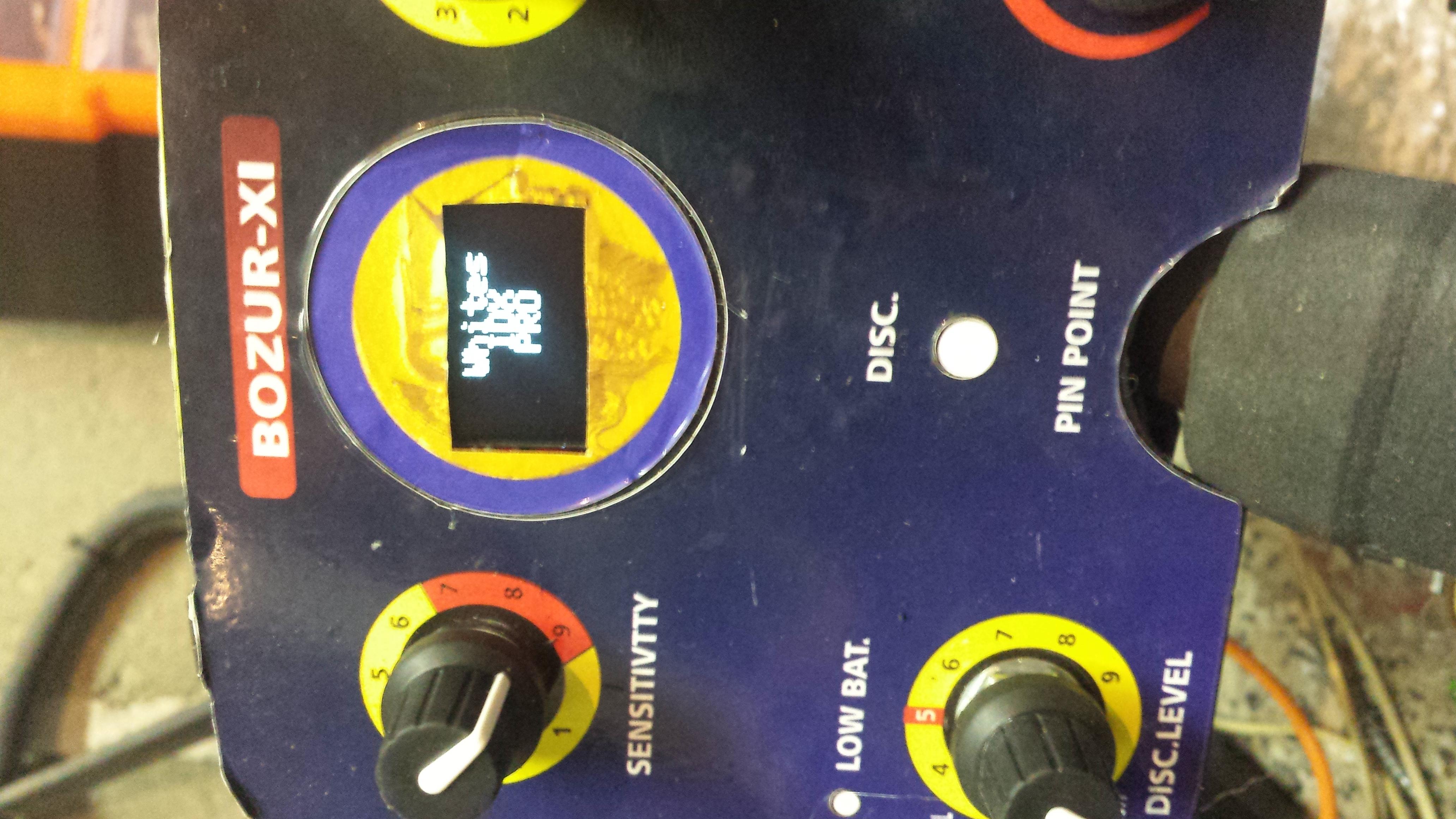

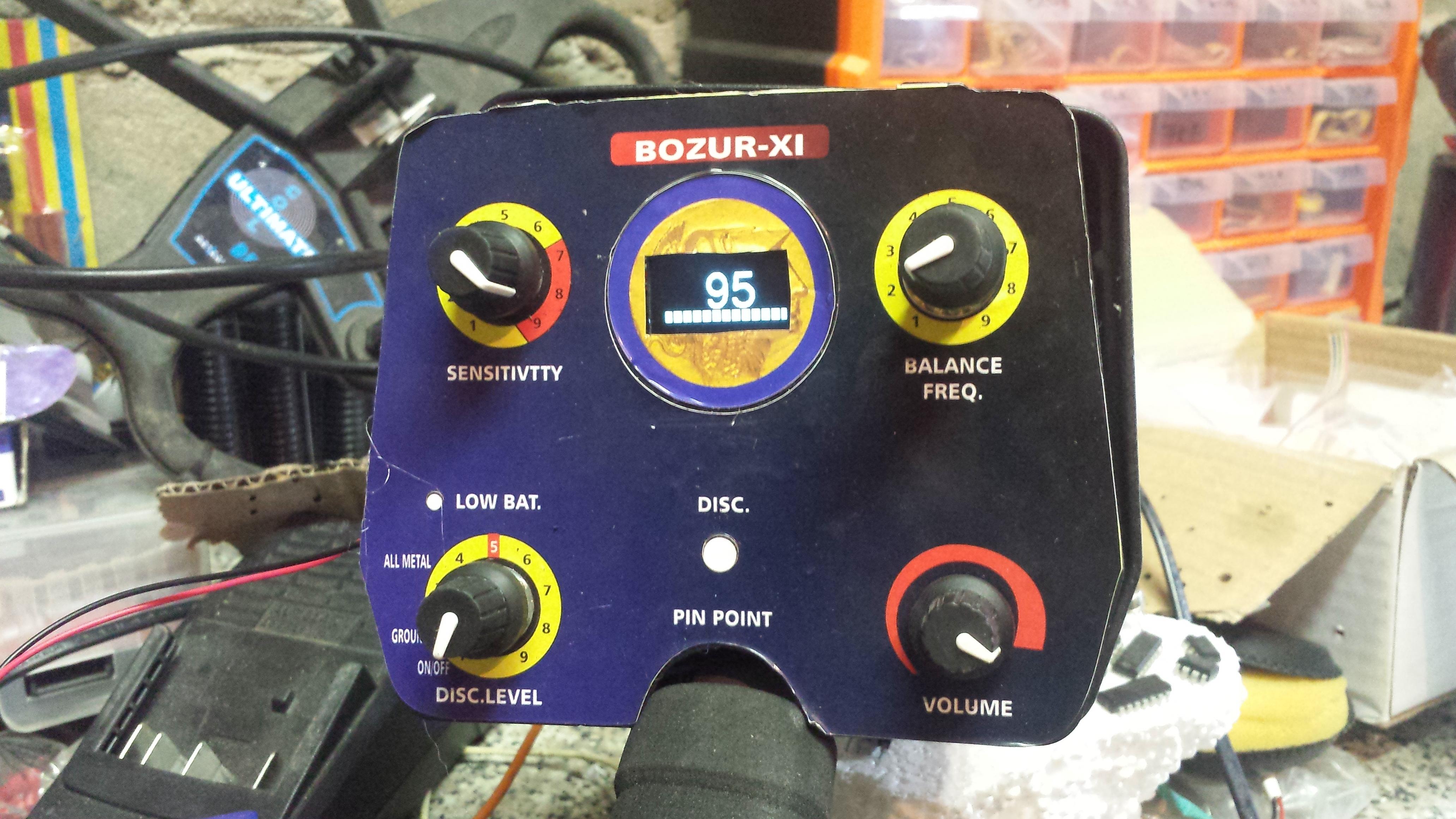

                                Here is my new Arduino vdi project with small 128x64 display. Implemented bargraph and custom font's. Machine on the photo is IDX with 12.5 inch coil. Soon i will upload short video...
