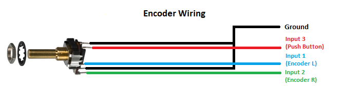

                        • Hi Hello everyone, I wanted to ask the gurus of this Forum, how can i connect an encoder to Mr. Daren TGSL project with VDI MD_04 in order to access the menu, as seen in the video (http://youtu.be/dh_BKukrgfk) . Thanks, to anyone who can help me.
                          • Encoder
                            Encoder arduino side:
                            //Rotary Encoder with a push button
                            //GND -> encoder pin C
                            //GND -> encoder button pin 1
                            #define PIN_ENC1 2 //Arduino 2 -> encoder pin A
                            #define PIN_ENC2 3 //Arduino 3 -> encoder pin B
                            #define PIN_EBTN 4 //Arduino 4 -> encoder button pin 0
                            encoder side:
                            • Thank you Mr. Daren.

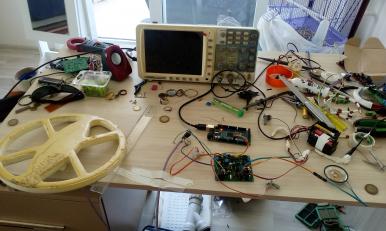

                              • Hello,
                                i was trying to Arduino & IDX PRO VDI but my IDX PRO (IDX final schmatic) doesnt see Silver ? disc pot is working i can erase all metals but in any position of disc Pot it doesnt see silver and not stable VDI also i can see difference 1 euro and beer tab on arduino but what can be wrong on my circuit or Coil ?
                                thanks
