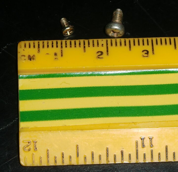

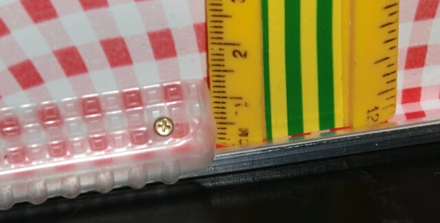

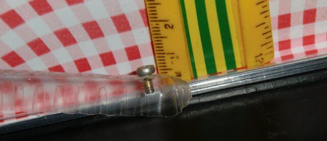

          The new test shows how unbelievable powerful this MD
          with it's pretty large coil is for detecting super little stuff.
          The test was made indoors with heavy frequented street
          nearby including all kind of electronical devices and even
          metal objects pretty close.

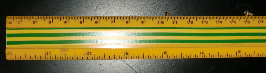

          The cm/inch ruler 0.00 starts 0,5cm above coil level
          and the video was shot from an angle of ca. 15° above.
          To play fair this must be considered, but afterwards I
          made the distance test without camera and the position
          of the screws on the ruler is the real detection distance.
          To get this distances under real search conditions the
          target has to be within the ca. 33% inner area of the
          coil and while slow sweeping.
          Sensitivity was up to 10 but I have tested this setting
          already outside - it is no problem to search at this high
          level under real conditions.
          btw. the both values 10.5cm and 16cm just represents
          a clear and loud detection signal at a heavy e-smog location.
          A skilled user could hear the detection starts already at a
          distance of 50% more, especially without EM-pollution.
          This detector is not for rookies but really a jewel in analog
          metal detection. Sometimes it needs patience and pressing
          the reset button 3-5 times until the critical adjustment is
          set to the best position but you can find ultra little stuff
          and ultra deep stuff at the same time what's extremly rare.

          If someone has a scale at home that is able to measure
          0.001 of a gram he could look around if he finds such
          identical small screws and post the weight of them.
          I guess it's around 0,1 gram for the ultra small one and
          perhaps 0,3-0,4 grams for the very small one. Thanx.
