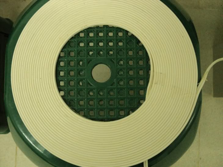

                            Made a coil with degaussing wire from Tv set with 21 turns, 25cm diameter and 2.7Homs (too high).....I hit an Euro coin 25cm in air test
                            Power consumption was
                            Them made this one with speaker wire 12cm ID, 25cm OD, 20 turns and 0.2Homs.....also 25cm for an Euro coin
                            Energy consumption increased significantly
                            I'll try to redo this coil with single wire to increase Homs and reduce weight
                              congradulations you got it to work first time, like the idea of using degausing wire from a TV, got a few put back here from years ago, that was my secret lol.
                              Another wire you can try which ive used in the past is the wire from the scan coils, most are good quality insulation due to the high influx of voltage and current they had to handle, far in excess to what we are using them for.
                              You will find theres two lots of windings, the heavy gauge was fed from the line output stage of the TV that gave you the horizontal scan, the lighter windings was driven from the frame output stage which gave you vertical scan.
                              So for your PI go for the linescan side of the coils which are used to handling around 1000v.
